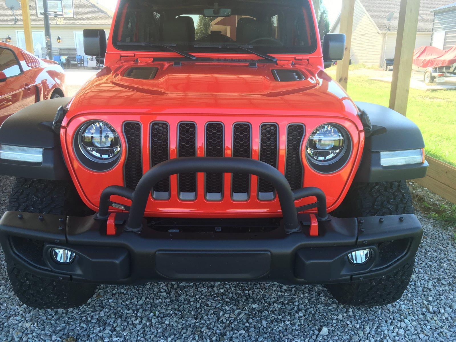

I am working on an addition to the instructions. This is 90% complete but maybe these will help. (Updated with final draft images)
This is my first post in these boards. 2020 JLU Rubicon. Wanted to thank you for the extra instructions. Overall the stinger install was very straight forward and took just over an hour. Got to the frame brackets and it didn’t make sense.....took a look at your instructions and it was actually easy. Love the look!
