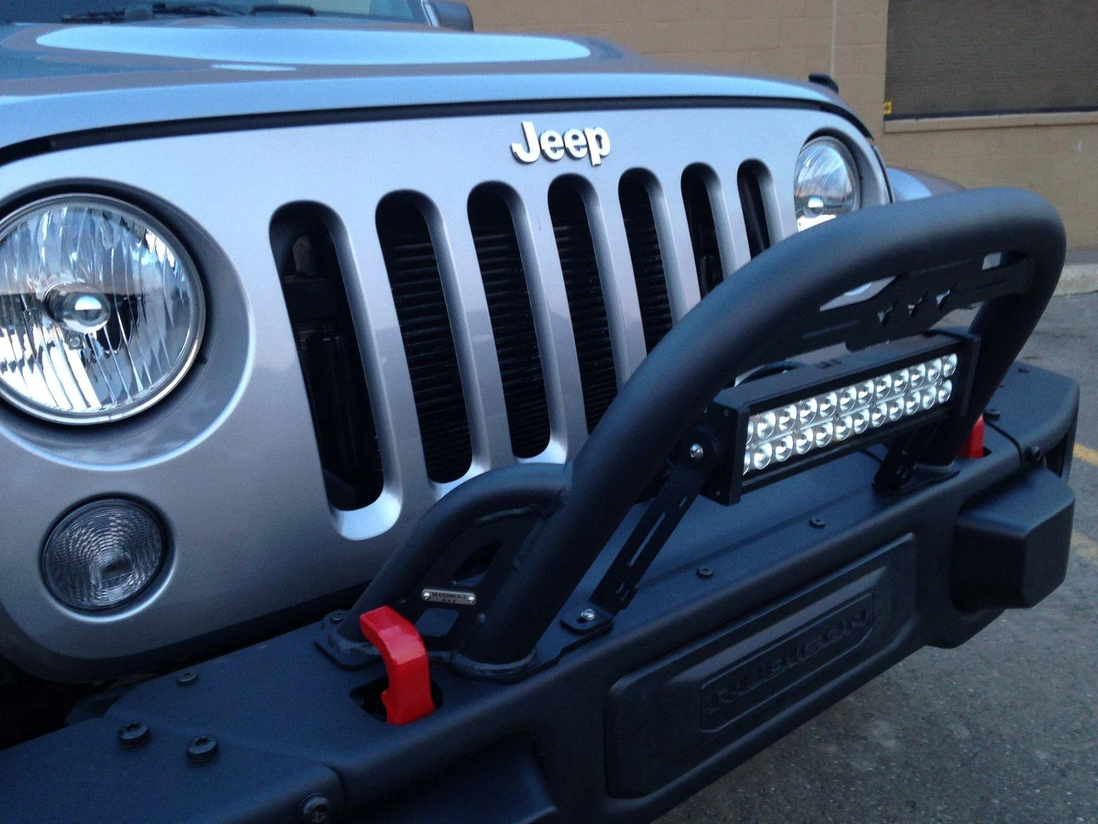

I am planning a Maximus-3 stinger on a 2019 Rubicon w/OEM steel bumpers.
1) I noticed 3 bolts evenly spaced across the top-side center of the bumper.
Has anyone used these bolts for 3 lights under the stinger?
2) What was the max size round lights you could fit? Perhaps 7"? (I'm hoping) …
3) What was the maximum size light bar you could fit? Perhaps 21"? (I'm hoping) ...

You are asking about mounting the lights directly to the bumper with no bracket correct? I am assuming you can get in under there to thread a nut from the other side. I saw somebody did that with a lightbar on an OEM steel bumper somewhere but I have not seen individual lights like you are talking about. I do not see a reason why it could not work though

Yes, mounting directly to the bumper is my objective.

What's up @mlebofsky, the Maximus-3 JL Stinger Bar's TUBE is about 21.5" wide at the base (near the flange.)
1.) Haven't tried it but... three 7" lights might be too big. Possibly three 6" or smaller lights could work
2.) The largest PAIR of lights we fit on our Dually Aux Bracket were the ARB/IPF 901XSD, clocking in at 8" each.
3.) We have confirmed that a 10" LED bar fits great. We are attempting to develop a 20" LED light bar bracket for that bumper.
Your three light idea should be doable, 7" may be too big or may require a custom bracket. If you try this we would love to see/hear your feedback.
Thanks, Maximus-3
