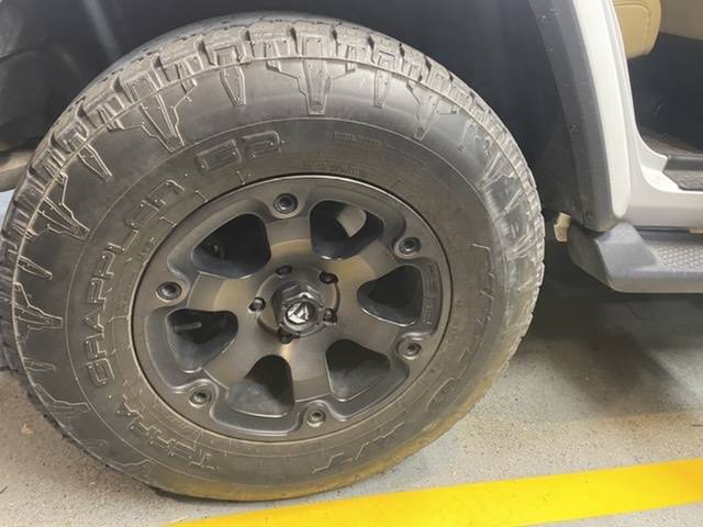

These wheels were on the Jeep when I purchased it, and I have no info on them.
Jeep Wrangler JL Help with backspacing / identification 3F405535-444C-4178-BBC3-03BB97AB2FC5
Looking for some help with figuring out what the backspacing,and what “model” they are.
They measure approximately 5 3/4” from the inside lug plate to the inner most portion (if that makes sense). Is that the backspacing? Is it + or -?
The stampings on the inside of the spokes are hard to read butI believe they are as follows
MHT
DOT-T
J9x7
MAX wheel load
SAE J2530
2500 lbs
ET 05 1.0 K
20G
QC
T0691790-2
and this kinda graph thing
Jeep Wrangler JL Help with backspacing / identification AB9A05AB-F5FC-4A4A-B00F-55F4B100F8B8
Any help is appreciated!!!

Those look like Fuel Beast wheels, marketed by MHT, with a +1mm positive offset. MHT/Fuel shows that for a 5x127 lug pattern wheel in 17", they are a 9" wide wheel with a 5.040" backspacing.
Here is a link to the MHT/Fuel 1-piece wheels:
Fuel Beast 1-Piece Wheels

Thanks Maddog (not going to ask about that screen name:giggle:)
My measurement of the backspacing must have been a little off.
Now gotta decide If I really want that Metal Cloak lift, cause that means new wheels!!!

You can run a non-6pack MC lift with these, just impacts some of the options (shock brackets).

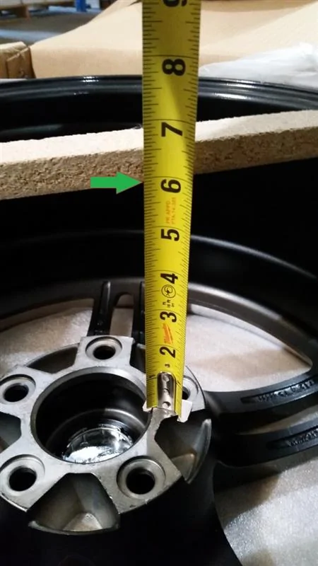

The below is a simple way to check Backspacing:
Jeep Wrangler JL Help with backspacing / identification how-to-measure-wheels_c373ad14 wheel backspacing
