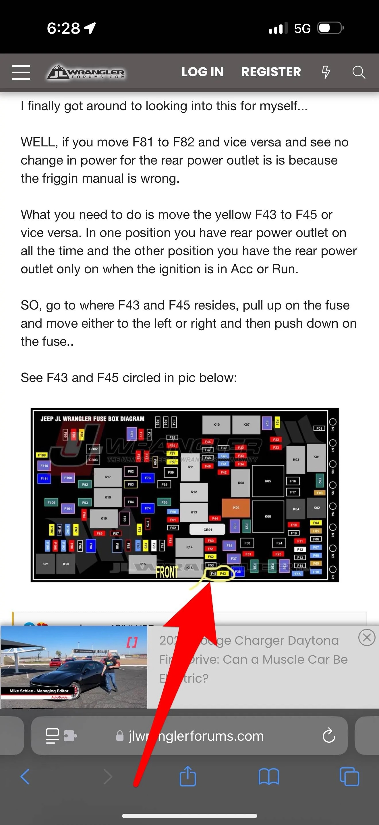

I seen a post which stated if you wanted your day time running lights which has extra power wire in the fog lights to come on when you start the car, change the fuse from 43 to 45 with a fuse tap wiring.
My car has both fuses in unless I’ve got the wrong fuses I’m looking at.
I have the Elite Series Fogs which has daytime amber running light.
I need to run a wire from both these fogs to a fuse tap so my daytime running light works in these fogs.
My question is which fuse can I use to do this?
Can I just pull out the 45 and plug a fuse tap into here to work?
And does anyone know why I would have fuses in both 43 and 45 slots?

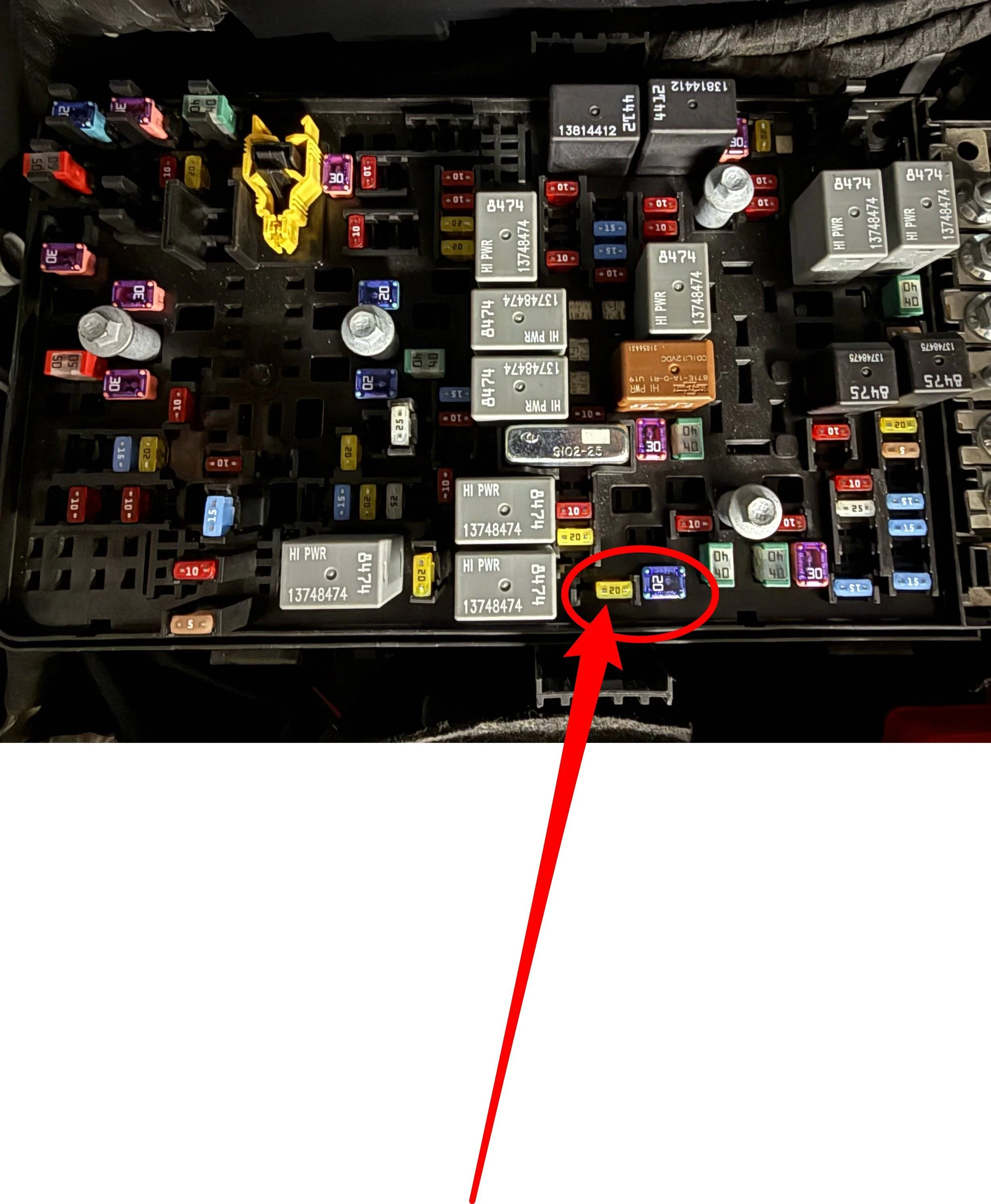

Jeep Wrangler JL Help wiring fog lights IMG_9075
Jeep Wrangler JL Help wiring fog lights IMG_9076

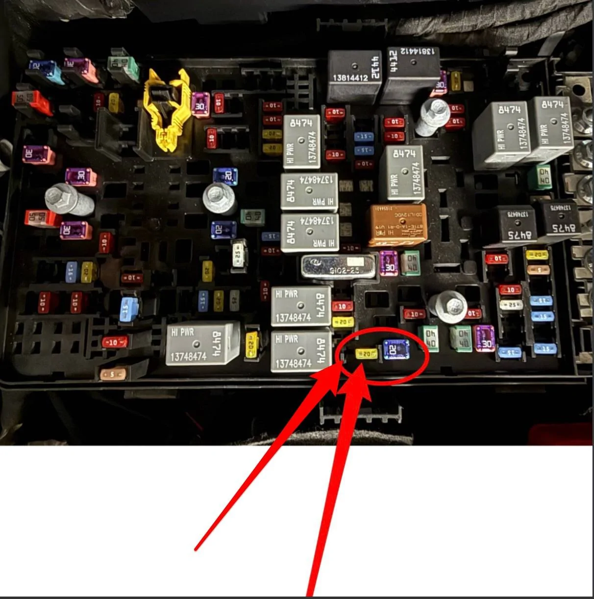

Ok, I think I figured it out.
Looks like there’s only 3 holes for 43 and 45. So, the fuse would either go in the far left and middle holes or it would go in the far right and middle holes.
