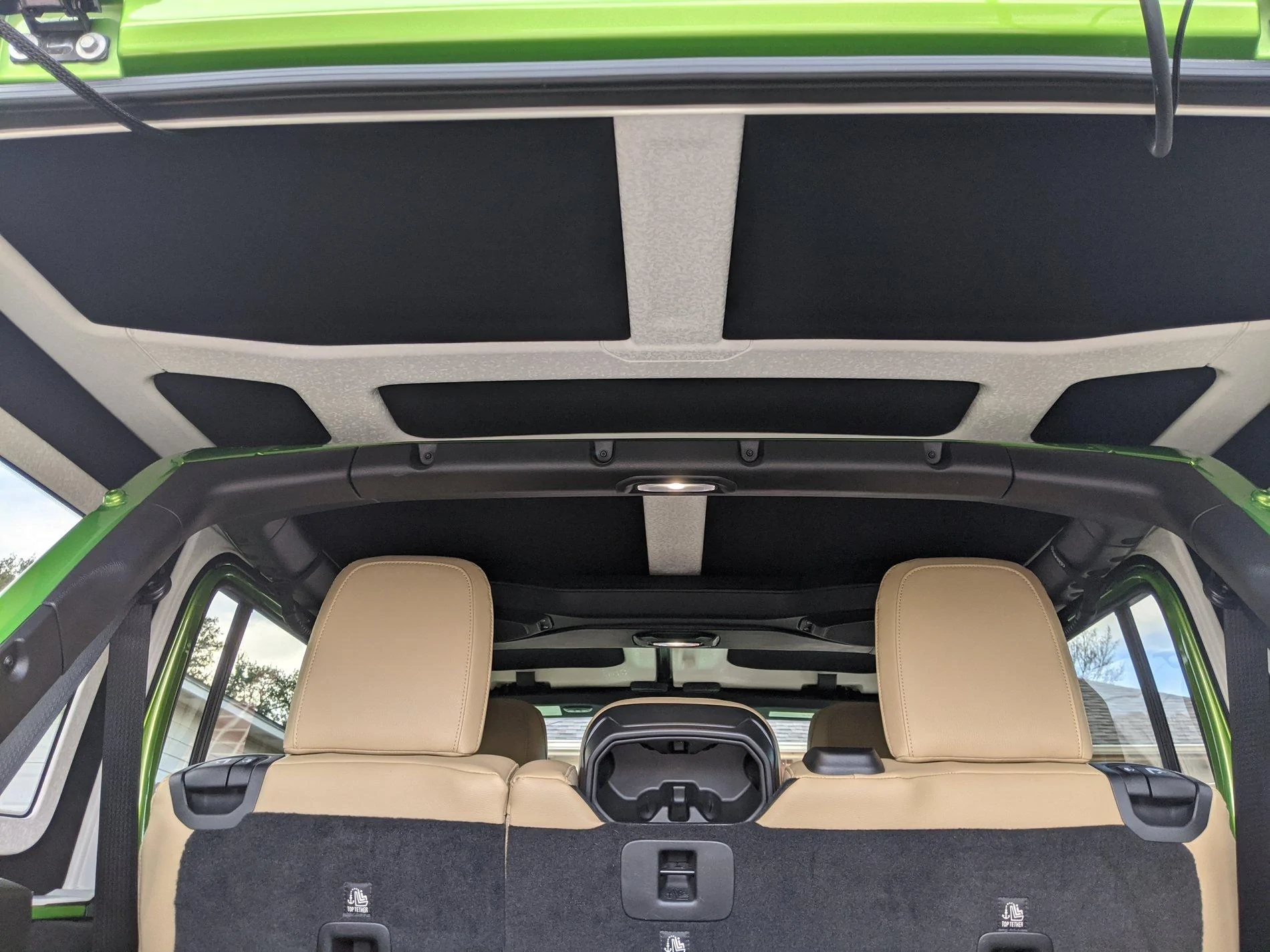

I am part of the Hothead Headliners with Sound Assassin strips crowd. Installed them on my 2018 Sahara JLU a few months ago and couldn't be more happy. I actually measured the sound levels with a meter before and after installation on the same highway stretch, same speed, same wind conditions. For me--and this will be dependent on your tires type, road surface, wind, etc, I found that there was a no-kidding 8-10 decibel drop. It is very noticeable to me both from how loud I have to turn up the radio to hear at the same level (I have the Alpine system) to the overall sound-dampening in the cabin. Additionally, it definitely finishes out the look and feel of the interior. Finally, I live in San Antonio, and while I have found that I can actually cool the interior pretty quickly even without the headliners, they definitely make it a quicker experience and are another plus in what often is pretty brutal beatdown heat. That said, headliners will not ever make your Wrangler as quiet as say, our 2018 Buick Enclave Avenir, which is seriously the quietest vehicle we've ever owned and has more insulation and sound baffling (along with active noise reduction) than any vehicle we've ever owned. Knew that going in, but anyone getting a Wrangler has to know that is part of the trade-off. Whatever you choose, welcome to the Jeep family and the unique experience it is!
Jeep Wrangler JL Headliners - Are they worth it? IMG_20200216_174440

I've seen the Coverking Topliners offered, and considered them as an option, but lack of information held me off. Hothead had a lot of positive reviews and after a ton of research decided to go that route. I have truly been very happy with them, but know it's a personal choice. From the Coverking website you don't get a good feel for how much actual material there is to reduce heat/cold/sound. They definitely have a great look, and care went into their design, but beyond that, don't know. The density of the Hothead foam is pretty significant, as is that of the Sound Assassin strips, which help with harmonics further (I think they were a worthwhile additional cost, personally). I also had the opportunity to speak directly to Mark from Hothead over the phone (the one that does all their videos). Super nice guy, who answered all my questions. That kind of one-on-one is what they are known for.
One other piece to the decision process is whether you want all the white covered. Personally, the white never bothered me, as it definitely brightens the cabin, but lining it did help with all the above. The Coverkings appear to cover pretty much everything, which is great for a consistent look, and I could see how it would help with temp/sound based on that alone, but I kind of like the white/black mix with the Hotheads. Again, totally an individual choice. Other guys have painted theirs to eliminate the white they hate so much.
I'm not a fan of a totally dark interior personally, particularly in San Antonio heat.
And still others say that headliners don't do jack for them. To each his/her own! No matter what brand you go with I personally believe you'll like the difference in appearance and the temp/sound change. All the best to you and your choice!
