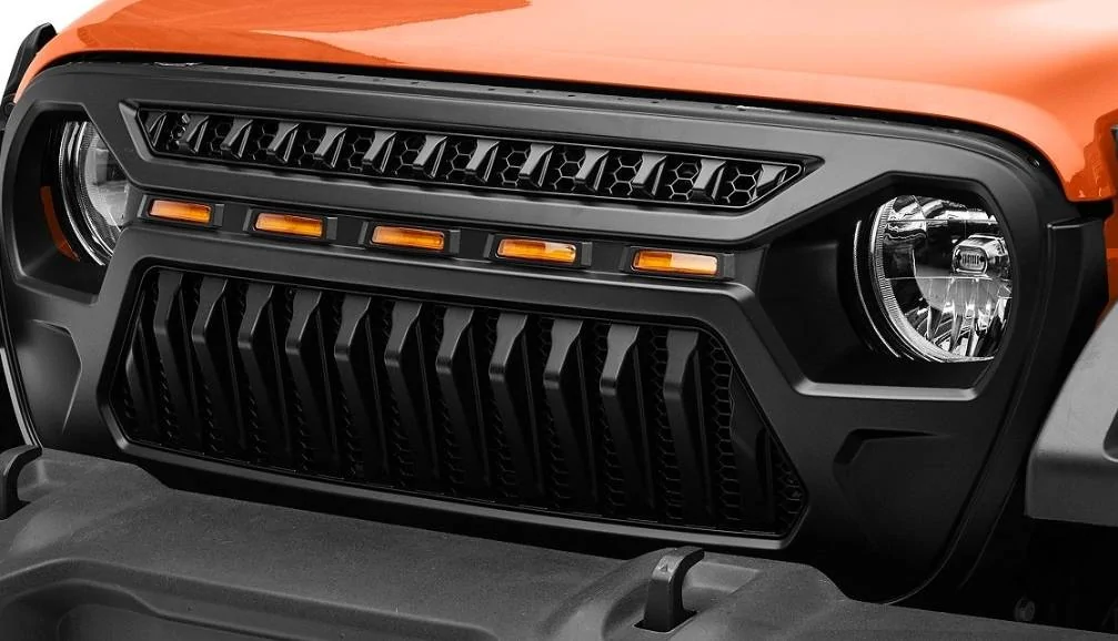

I installed a new grill and I cannot adjust headlights enough to point down. Anyone have this issue?
Ligts are aftermarket leds.
Jeep Wrangler JL Headlight too high with new grill SmartSelect_20211127-221833_Chrom
Jeep Wrangler JL Headlight too high with new grill SmartSelect_20211127-223008_Chrom

I think it is in your lights themselves. I installed a new grill and didn't have to adjust my lights at all. If you can't adjust anymore I would look at shimming the top with washers.
