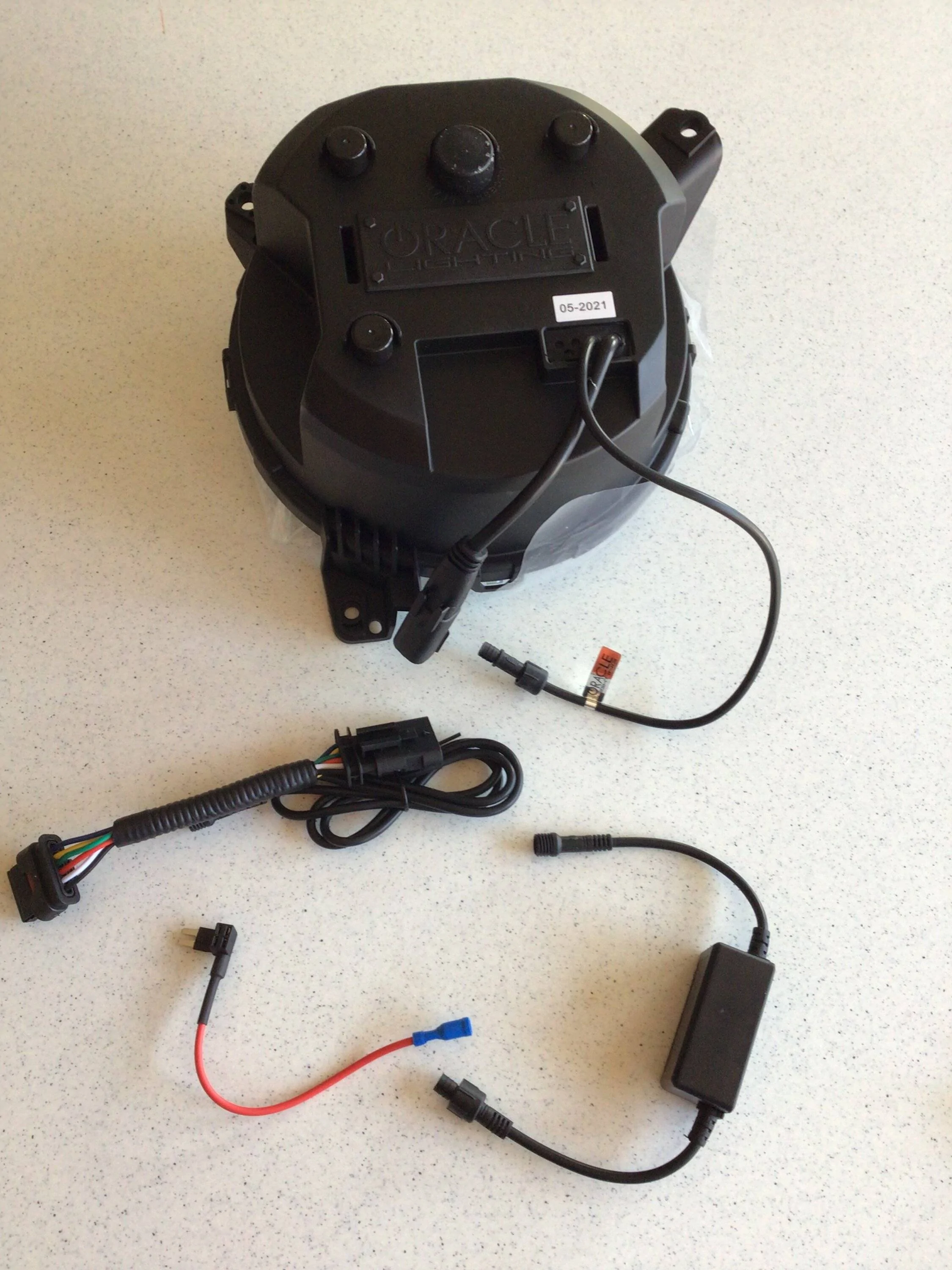

Do you have a brand, model number, or wiring diagram? Turn signals wired to the halos are called swichbacks. I run the Oracle Oculus Bi-LED swichbacks and really like them. Oracle supplied a wiring harness (the one under and left of the headlight) which was plug and play with the turn signal connector. I didn’t want to subject the turn signal wires to t taps or vampire clips.
