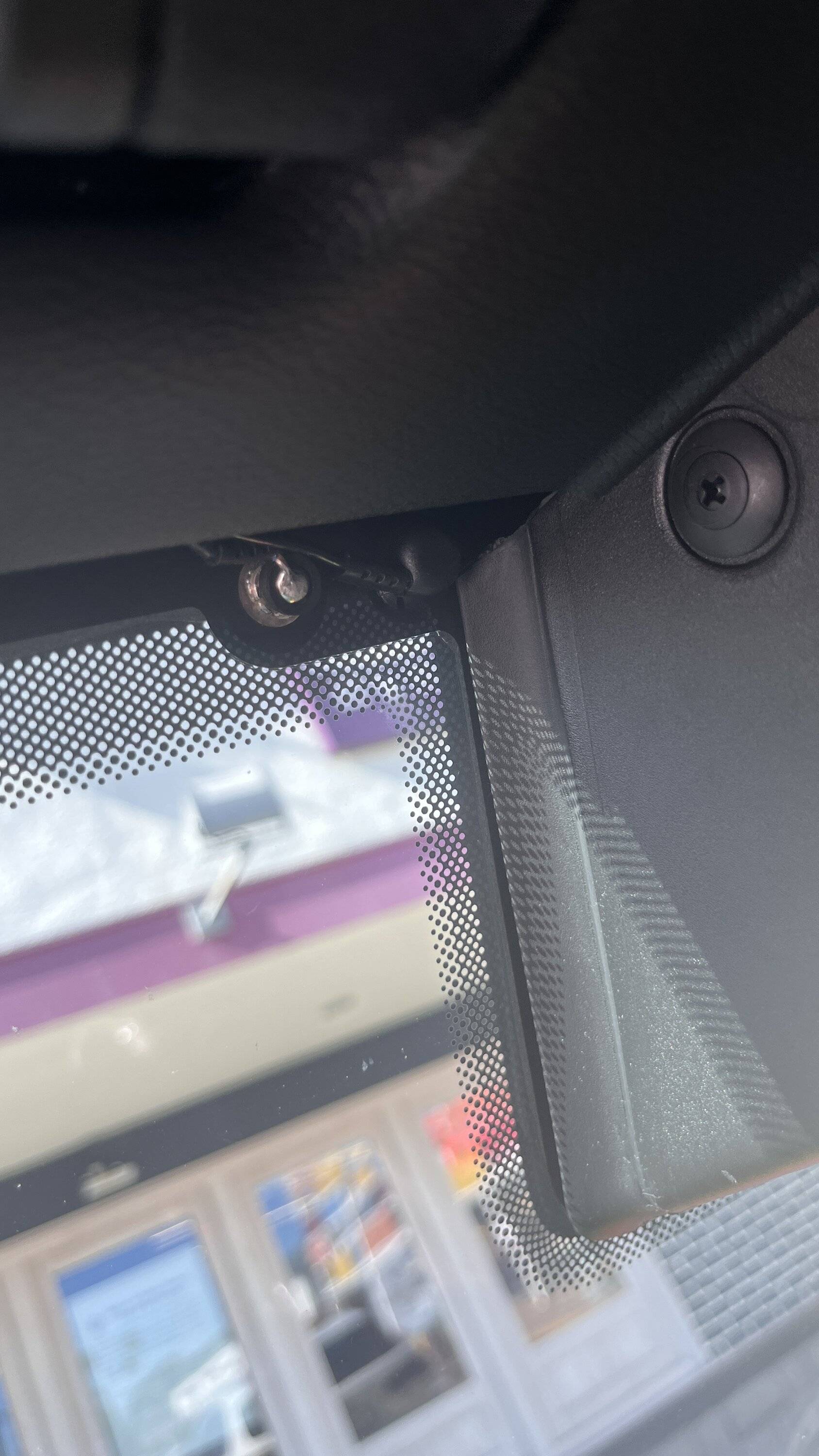

Recently I discovered that the windshield heating wire rubber cover was cracked and one of them fell off. Only used the front windshield heater a few times. The rubber cover looks like it comes with the heating wire, so there is no way to buy it separately. Is there any solution?

TO OP, If you're still under warranty, take it to a stealer... You can also just use a multimeter to verify continuity between the wire and the solder pad on the glass, if you have continuity then it's an eyesore but should still function. If not, then it will need to be re-soldered.

Got it! Thank you very much for your reply!

You're better off finding something from somewhere like McMaster-Karr (mcmaster.com) or 3d-printing something if you have access to one - because it's going to come from mopar as an entire assembly for all of the switches, sensors, etc in the windshield area and will go to somewhere under the dash. If you want to replace the entire wire going all the way, then @AllMoparParts.com is a great resource - looking through it looks like it's going to be 684705xxAA depending on your options, but they'll know.

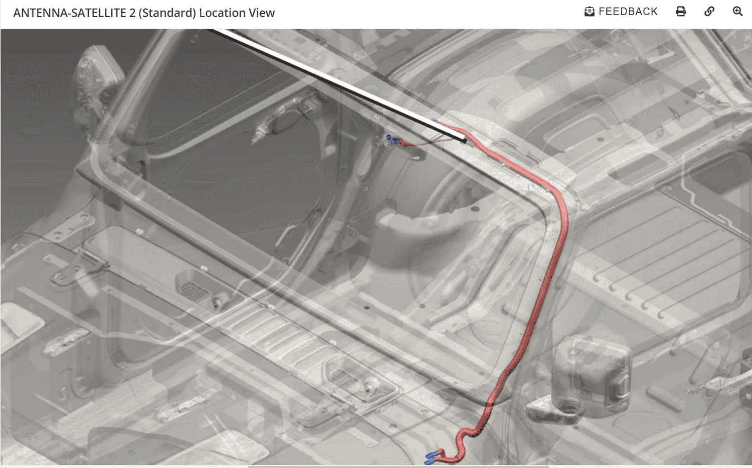

That wiring is for digital audio broadcasting of some sort
Jeep Wrangler JL Ha,what should I do with the front windshield heating wire 1706661626684
If you can send me your VIN I will see if we can track down this small harness but theres no way the boot only will be available, You can of course remove it from the new harness.
