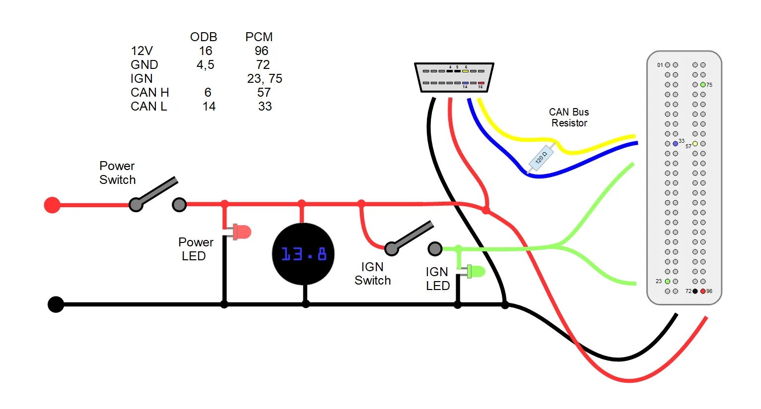

Here's a diagram of what I came up with.
Jeep Wrangler JL GPEC2A PCM bench harness PCM harness

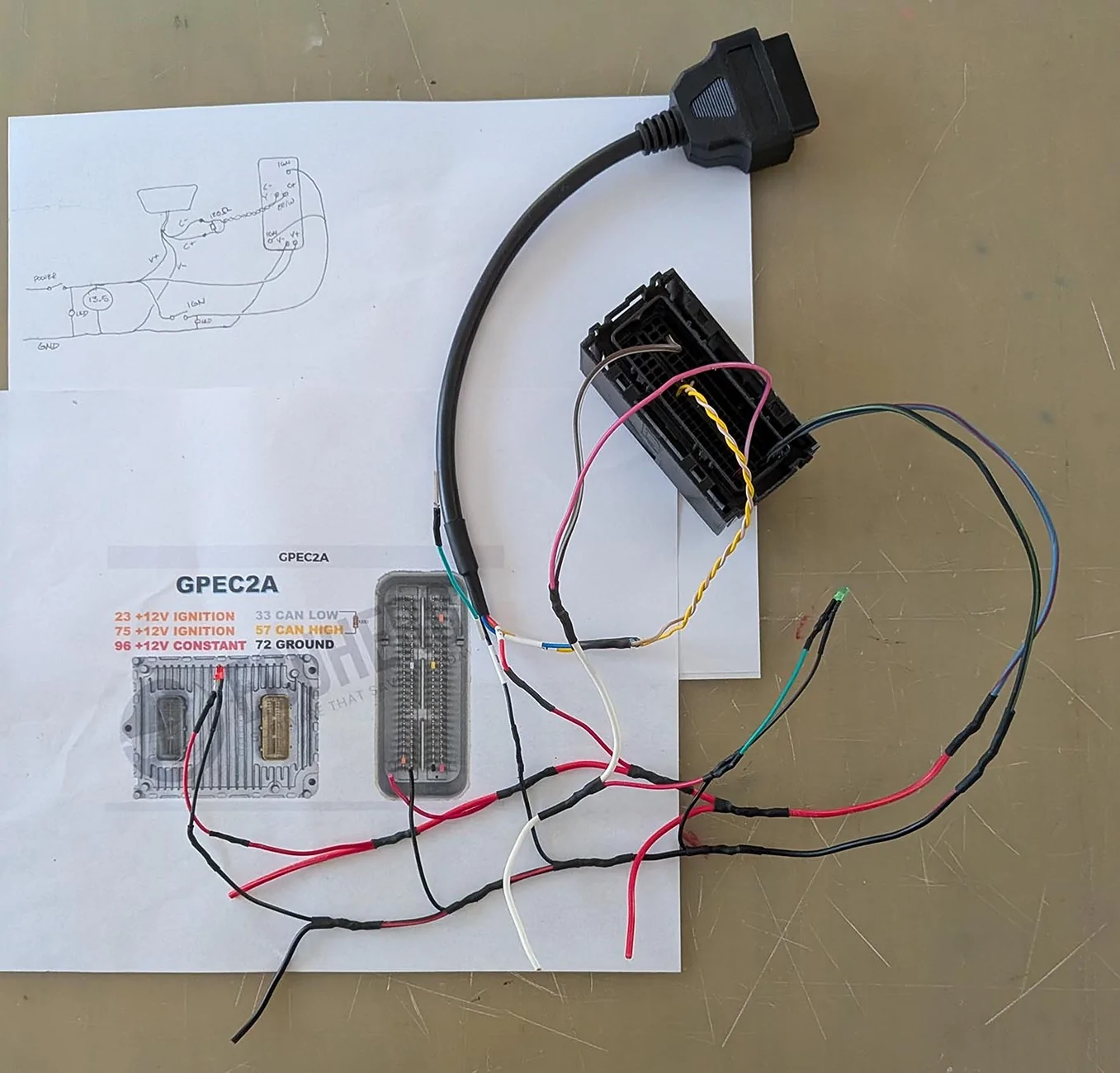

Here's what it looked like assembled without the switches or voltmeter attached.
Jeep Wrangler JL GPEC2A PCM bench harness pcm harness 2

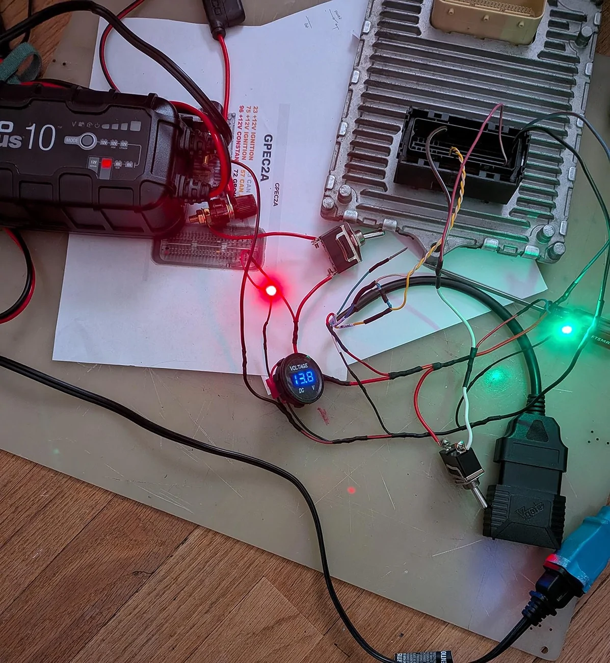

Here it is powered by the NOCO 10, connected to the pcm and a vLinker MC+ OBD BT adapter.
Jeep Wrangler JL GPEC2A PCM bench harness pcm harness 1

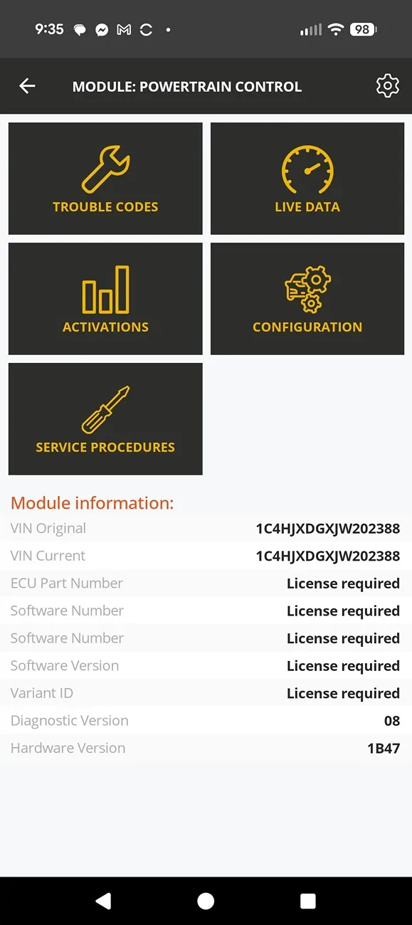

And here's the result of a successful read of the unlicensed pcm from jscan.
Jeep Wrangler JL GPEC2A PCM bench harness pcm used
