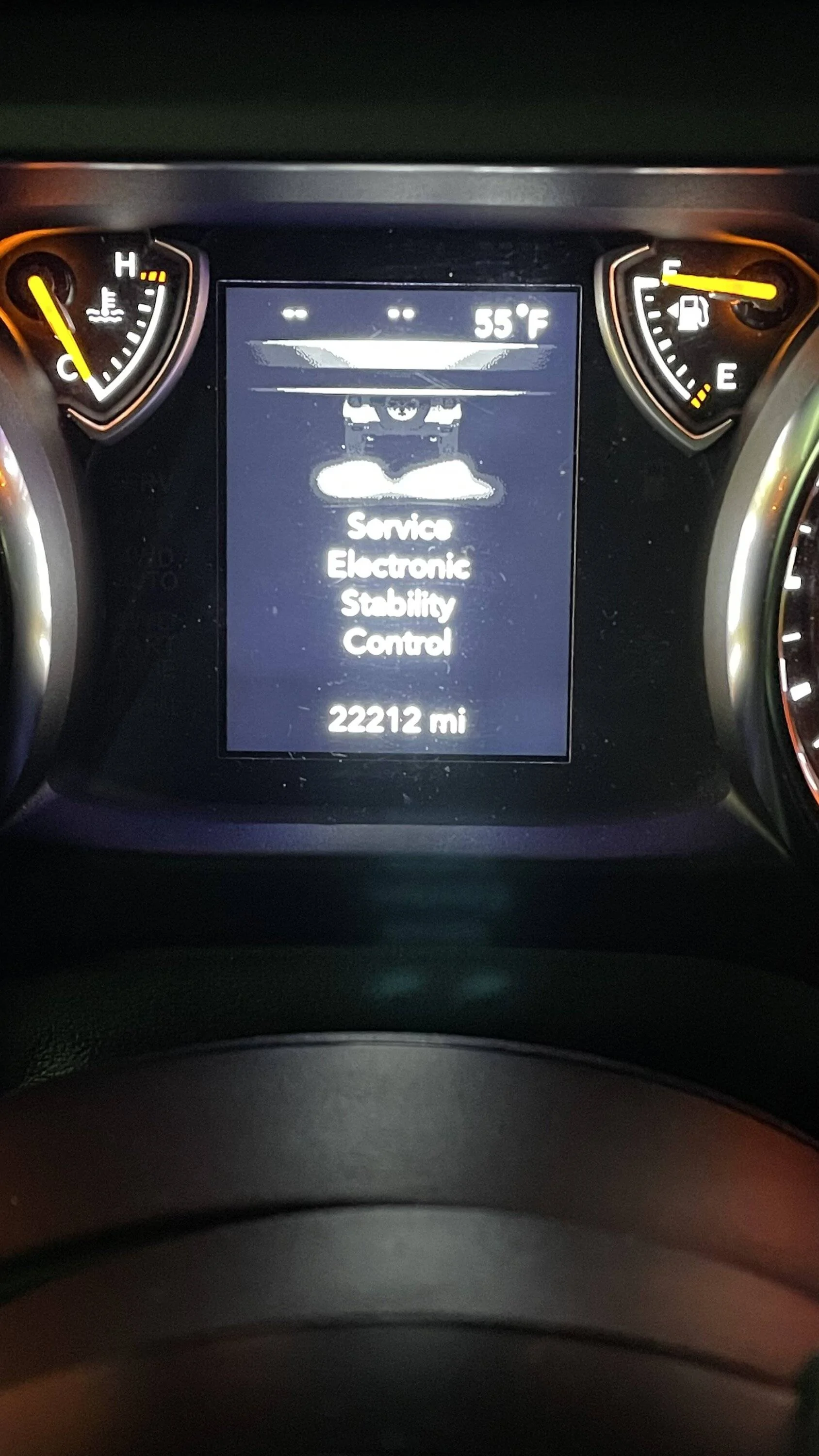

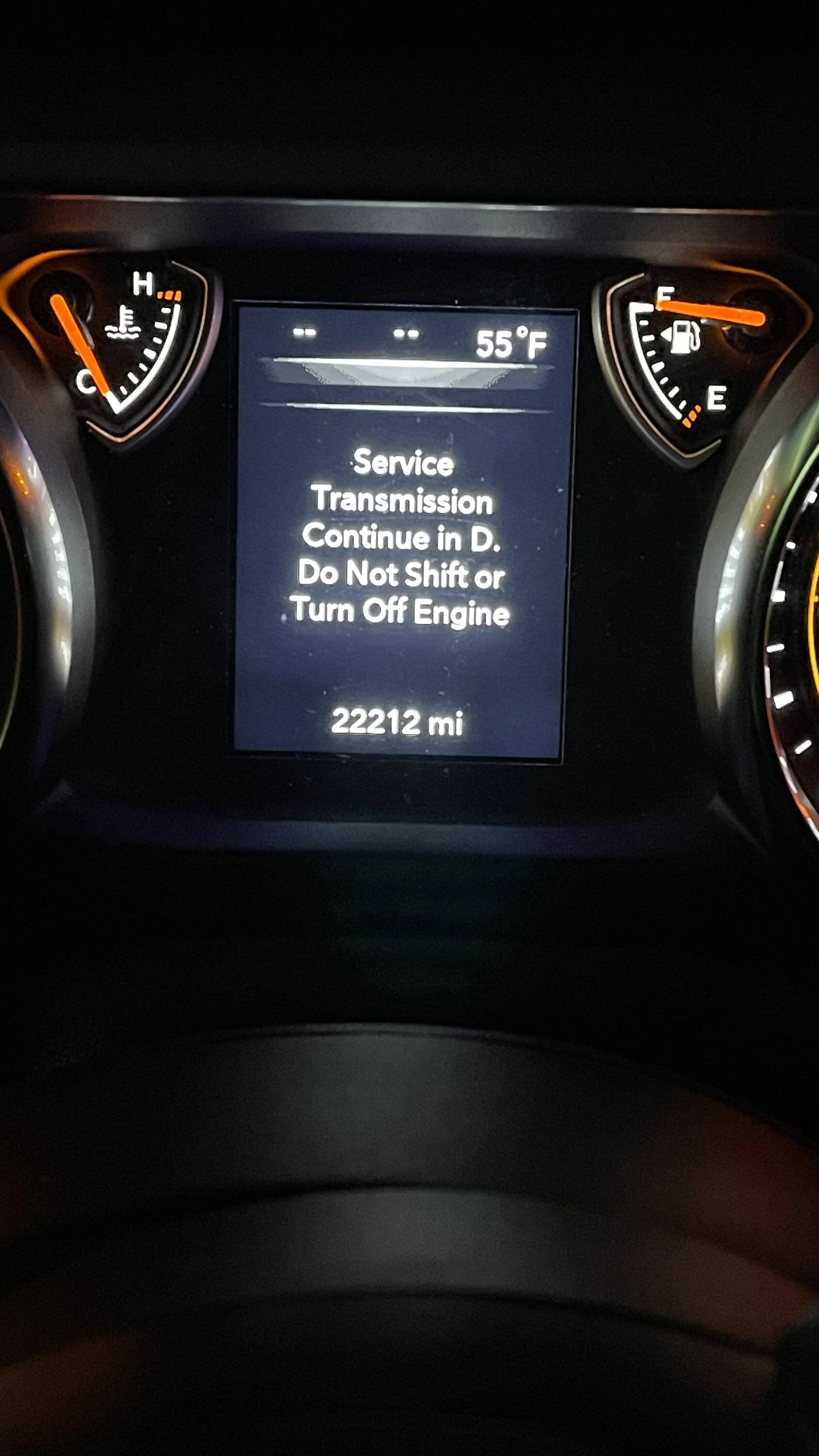

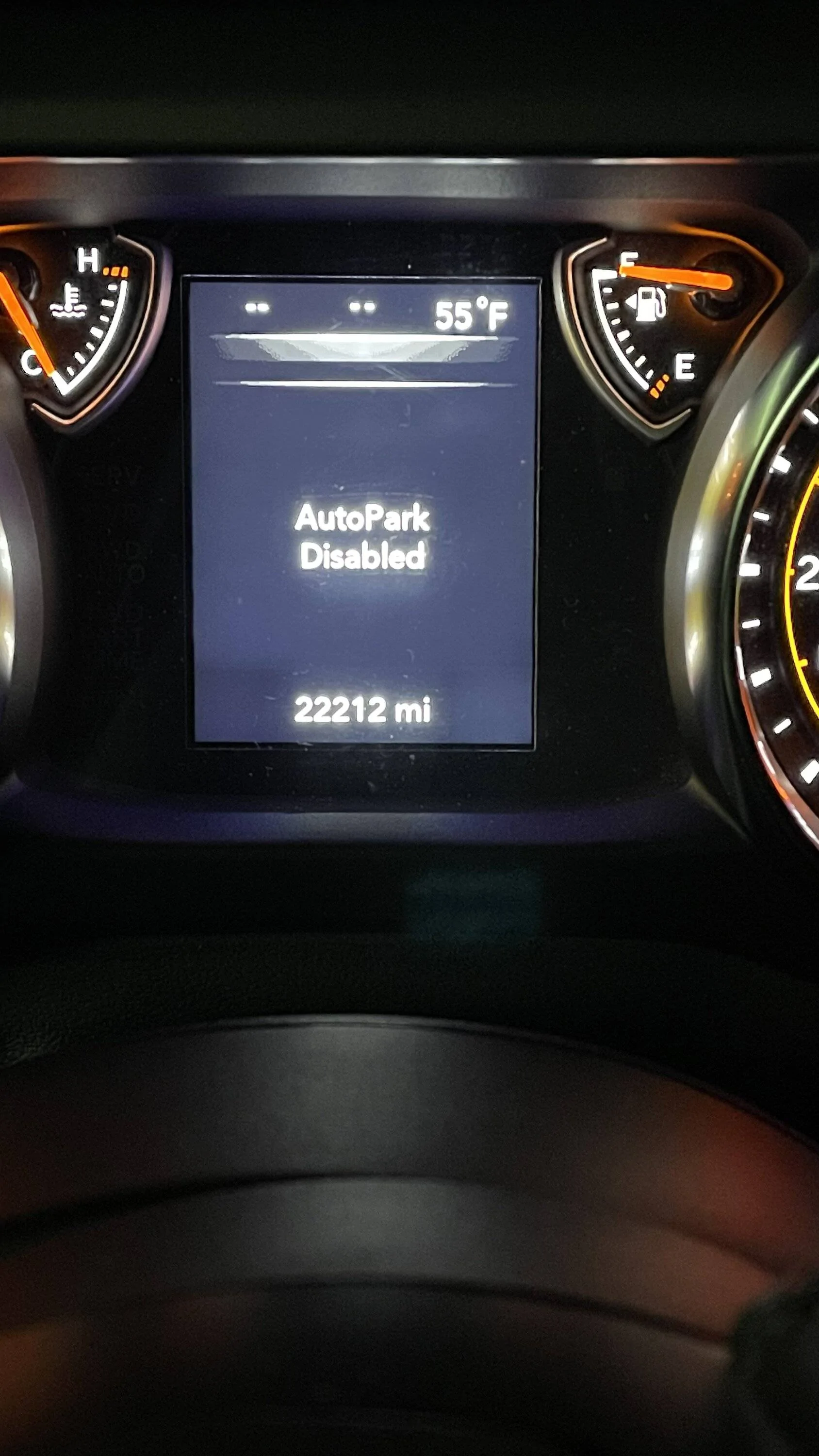

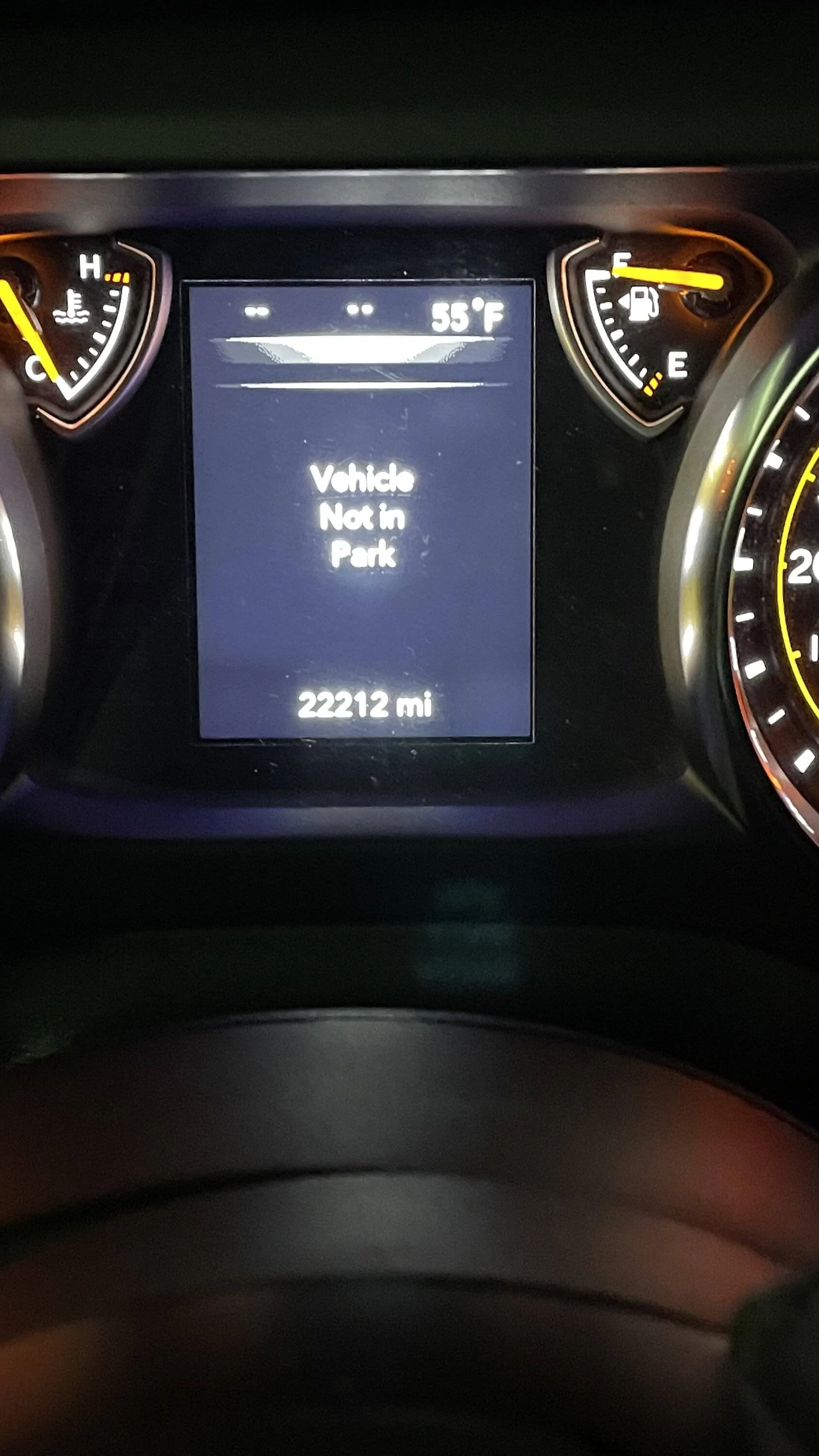

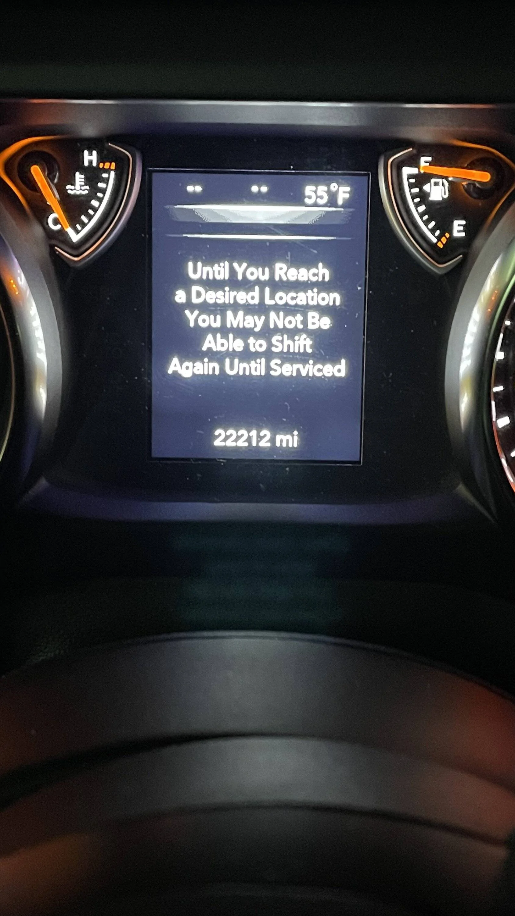

11/23/2022. Went for a drive, and parked somewhere, and when I tried to leave that Jeep would not start. Lights were on, the dash, the AC, etc. seemed to work, but I could not start the Jeep, the brake would not move, could shift gear to not even neutral. The error message on the dash was "Service Transmission Continue in D. Do Not Shift or Turn Engine Off", also "Auto Park Disable", "Vehicle Not In Park". Pressed the button to get assistance and lady asked me to ensure all doors were closed and they were. She then asked if my seatbelt was on, and it wasn't. I put it on and just like that I was able to start the Jeep.
