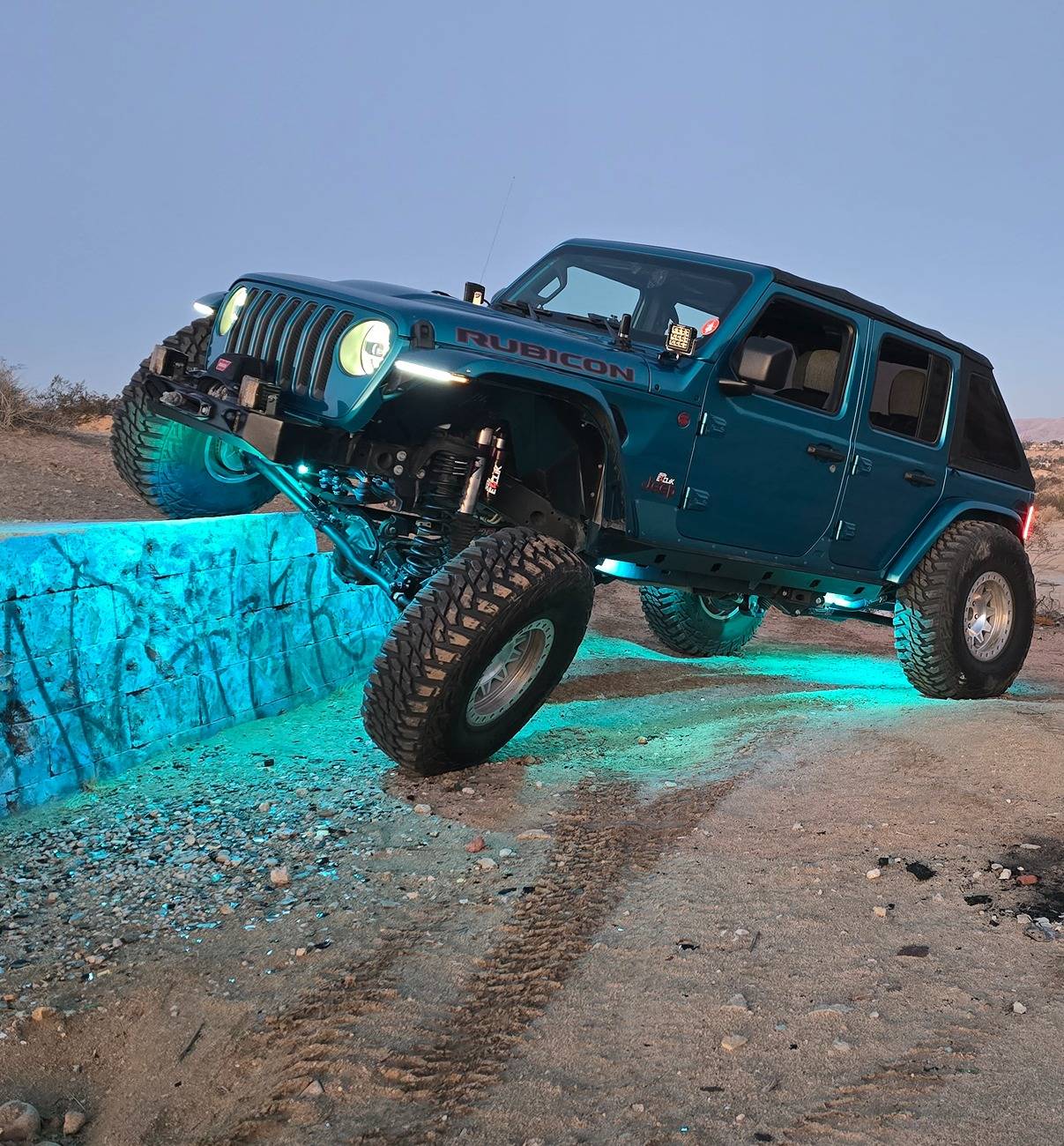

Currently running Teraflex Alpine IR long arm kit with SDI e-clik pro kit. After installing the PSC assist kit last week the tire hits the piggy back reservoirs running -38 Dirty Life's wheels (3.5" backspace). I had to add a 1.5" spacer to the front to not hit the reservoirs and I absolutely hate it. I called SDI about remote mounting the reservoirs and they do not offer that.
So what is the go-to coilover kit for the JL? Or what is your experience with coilover kits?
