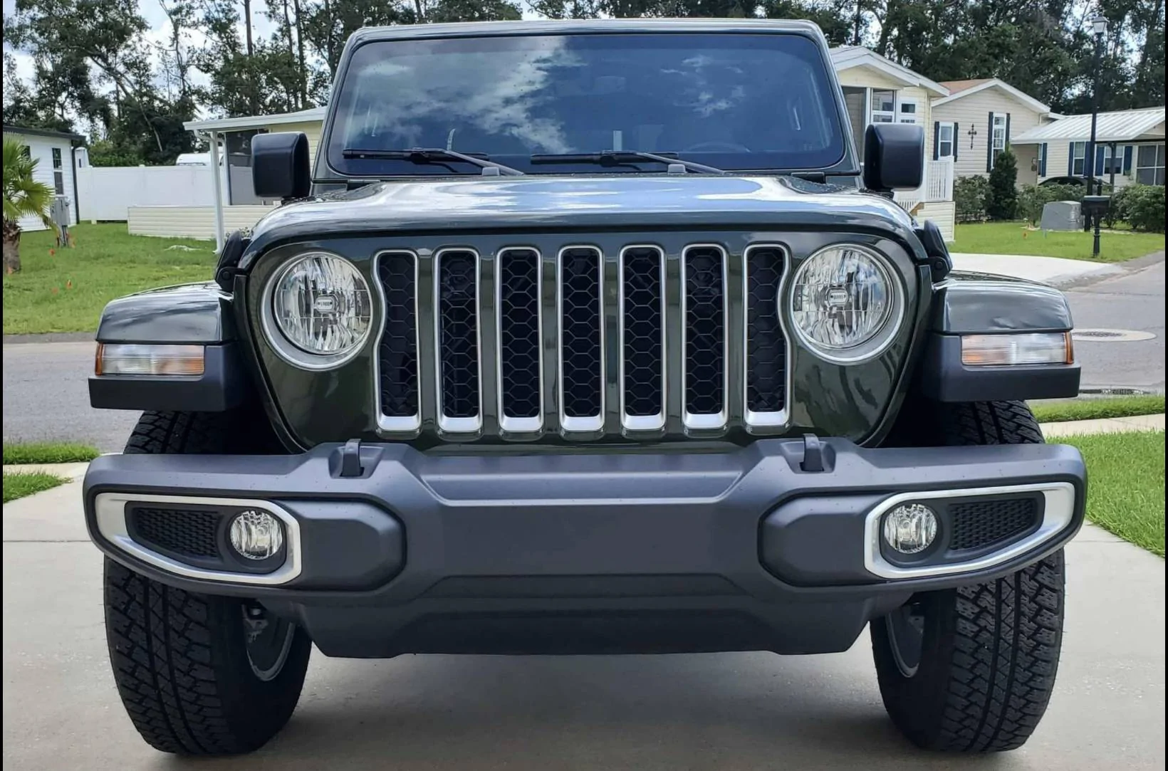

I’m looking at picking this gladiator plastic bumper up for my wife’s islander, as she wants the silver accents. I know there are some differences with the steel rubicon bumpers and the plastic sport bumpers, but are the plastics just a straight swap? What additional pieces, if any will I need to get this done for her?

Straight swap, unless one has LED lights and the other doesn’t. Then you will have to disassemble each bumper to swap them.

The Islander Jeeps have the Sport bumper so the fog lights won’t swap over. Hopefully the Gladiator bumper you get will have fog lights in it. If they are LED, even better.

To answer your second question, you will need the filler panel the goes between the top of the bumper and the grill. Everything else is plug and play.

Thanks! Yes, the Gladiator bumper comes with fog lights.
