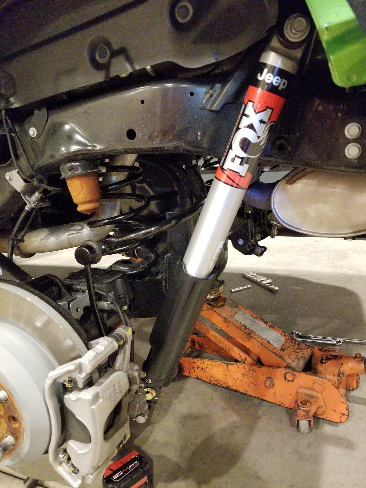

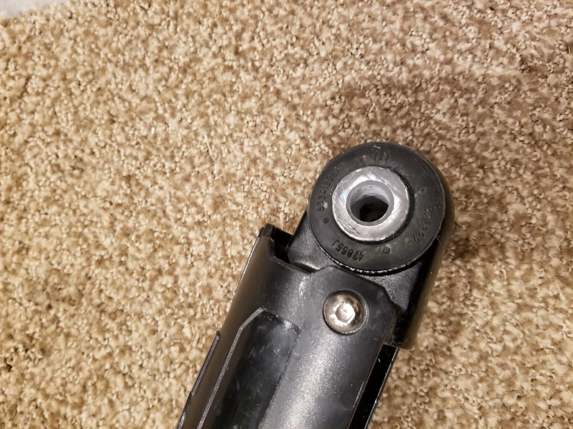

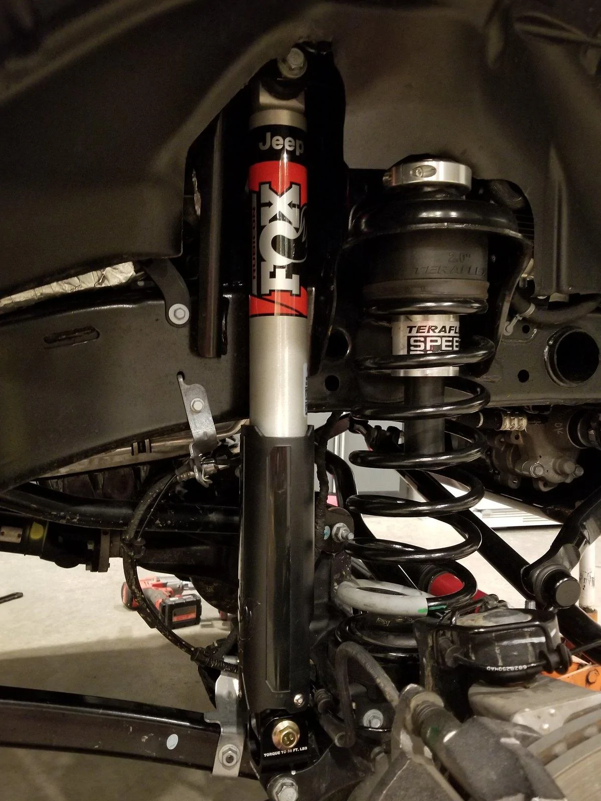

Great info. I didn't measure the holes, but I recall the bolt heads/nuts being 21mm on the rear shocks vs 18mm on the JL's.You only need the spacers for the top rear mount. JT is 1.570 top and bottom. It needs to be 2.750 top and 1.570 bottom for the JL. I have a second set of spacer coming, the first could have been made to work but will wait for the right ones. Hope to finish this up this week for drive testing.
Bolt holes are the same diameter JL and JT. Same for the length.
