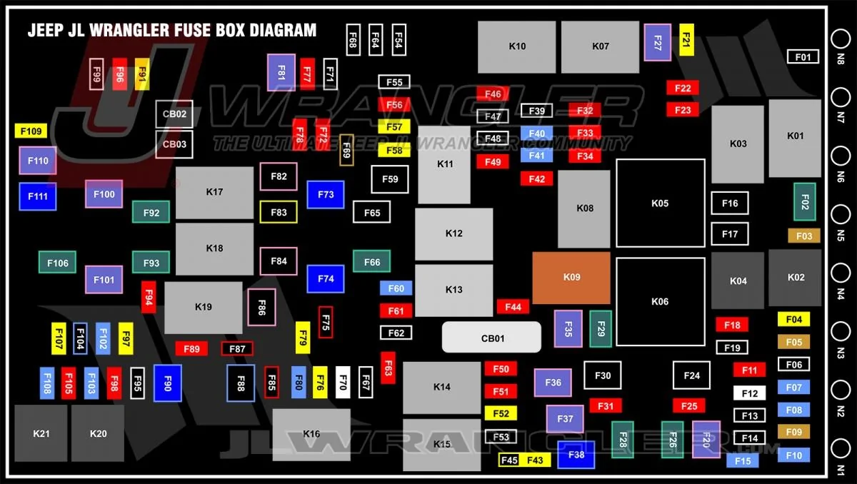

Any one know the location of the fog light fuse?

F29 will be for the driver side fog lamp (at least for the LED package)
F26 will be for the passenger side fog lamp

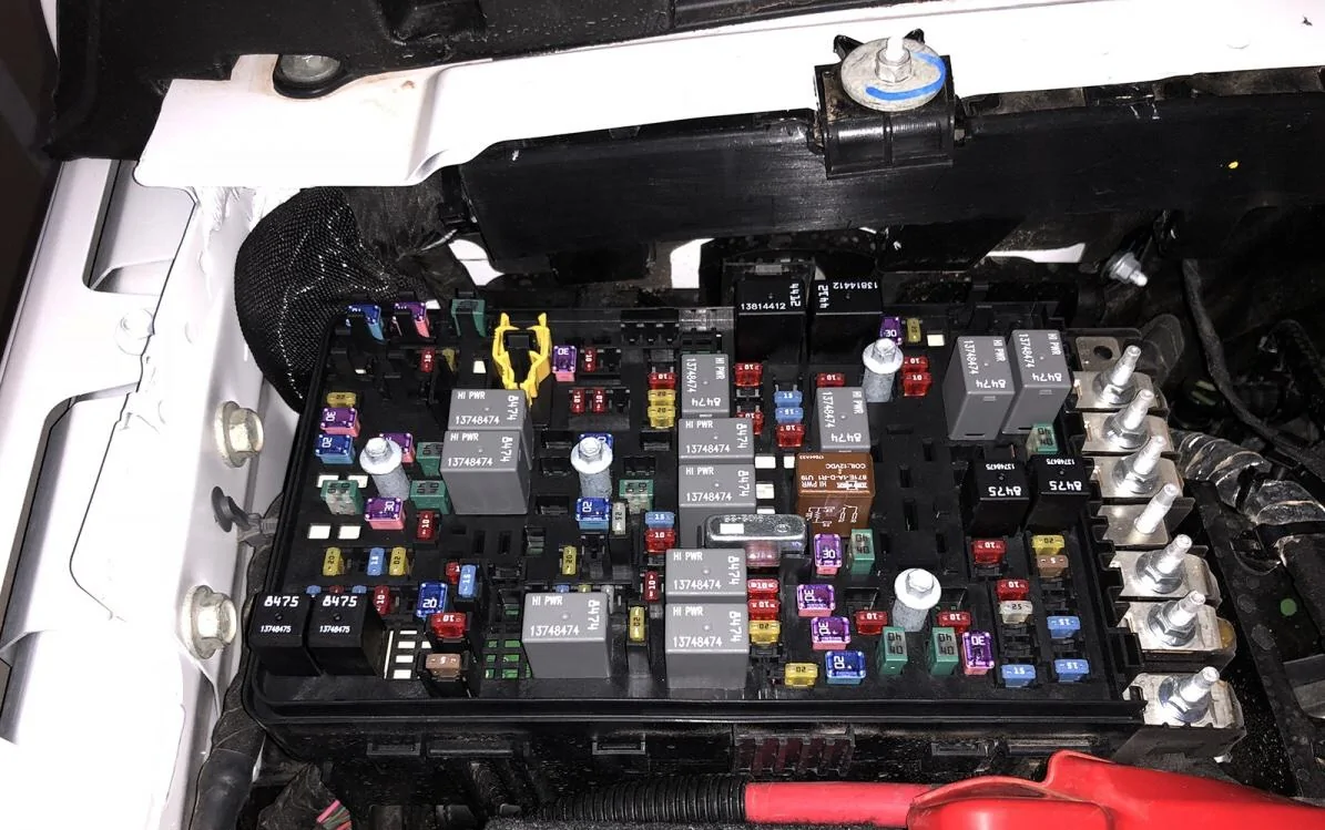

I posted this question in another thread (it may be dead) but I figured I'd ask it here as well. We just got a gently used 2018 JL Sahara with a factory tow package (seemingly - though it's not listed on the sticker). I looked in the fuse box and I do not see a single fuse for any of the tow components (tow controller, brake lights, F36 & 37, F109, etc).
We tried hooking up our trailer (which worked fine with our old car a Nissan Juke) and we shorted the tow control module. Twice... I brought this up to the dealer and they seemed to think the fuses were fine the way they were. Should I make sure these fuses are added? I'm trying to get them to 'fix' our ability to tow AGAIN, but I'll make them test with a set of 4 pin magnetic lights instead of just a tester this time.
