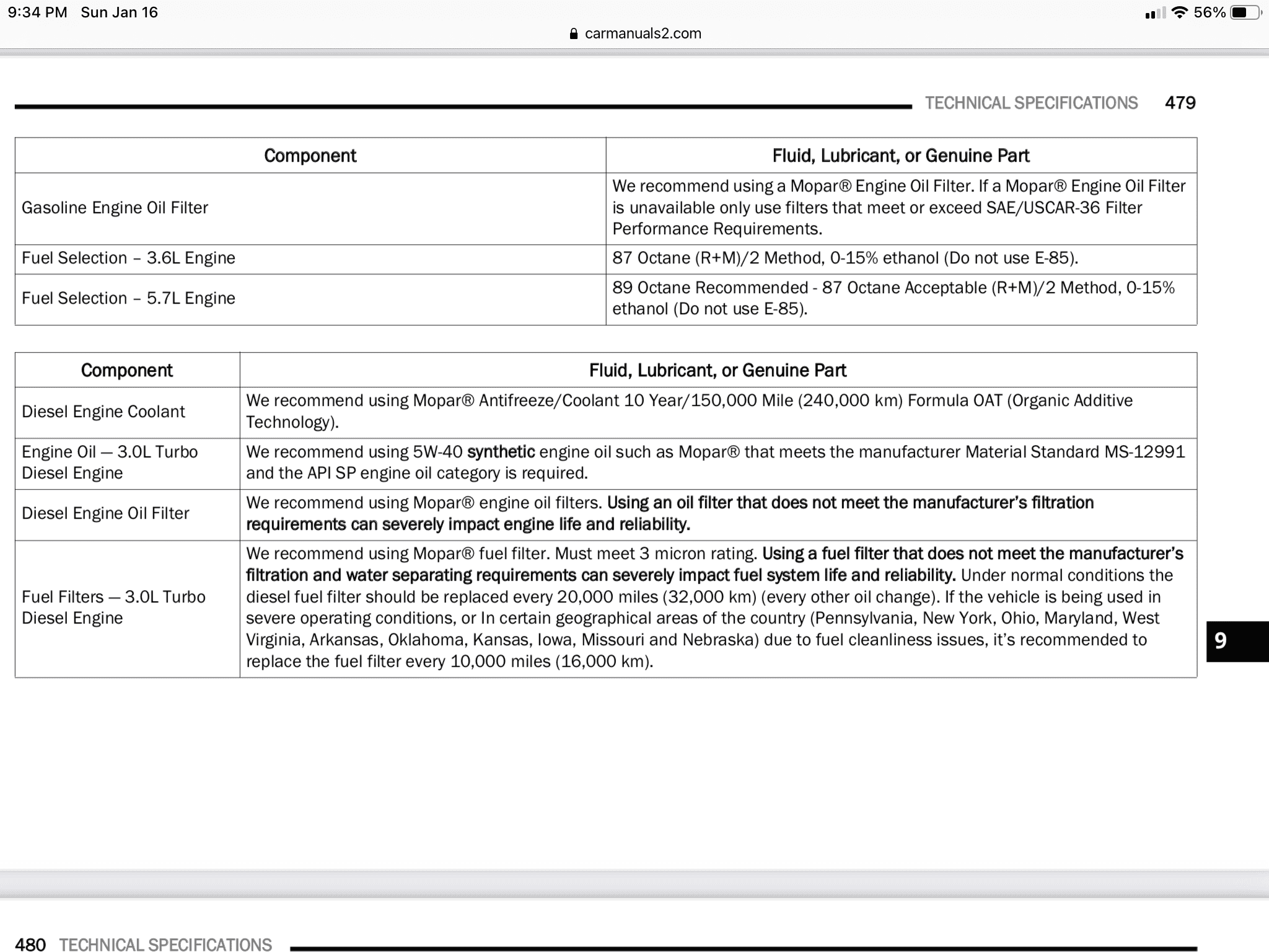

Friend of mine bought a new 2022 Ram with an ED. The manual notes that if you drive in severe conditions, or in certain locations — PA, OH, NY, WV, MD, KS, OK, IA, MO, NE — you should have your filter changed and water drained every 10k miles due to fuel quality, instead of every 20k.
That’s the first time I’ve seen that. Any idea if that holds for us? Or… why those states?

I pulled up a 2022 RAM 1500 manual online and do not see that.
In any event.....different (higher) biodiesel percentages generally will contribute to lower OCI’s.
EDIT....
I do see it.
Fuel is definitely not the same in every state or store, I was on the side of the road having to treat my tank and pray because I bought at the wrong store in NY.

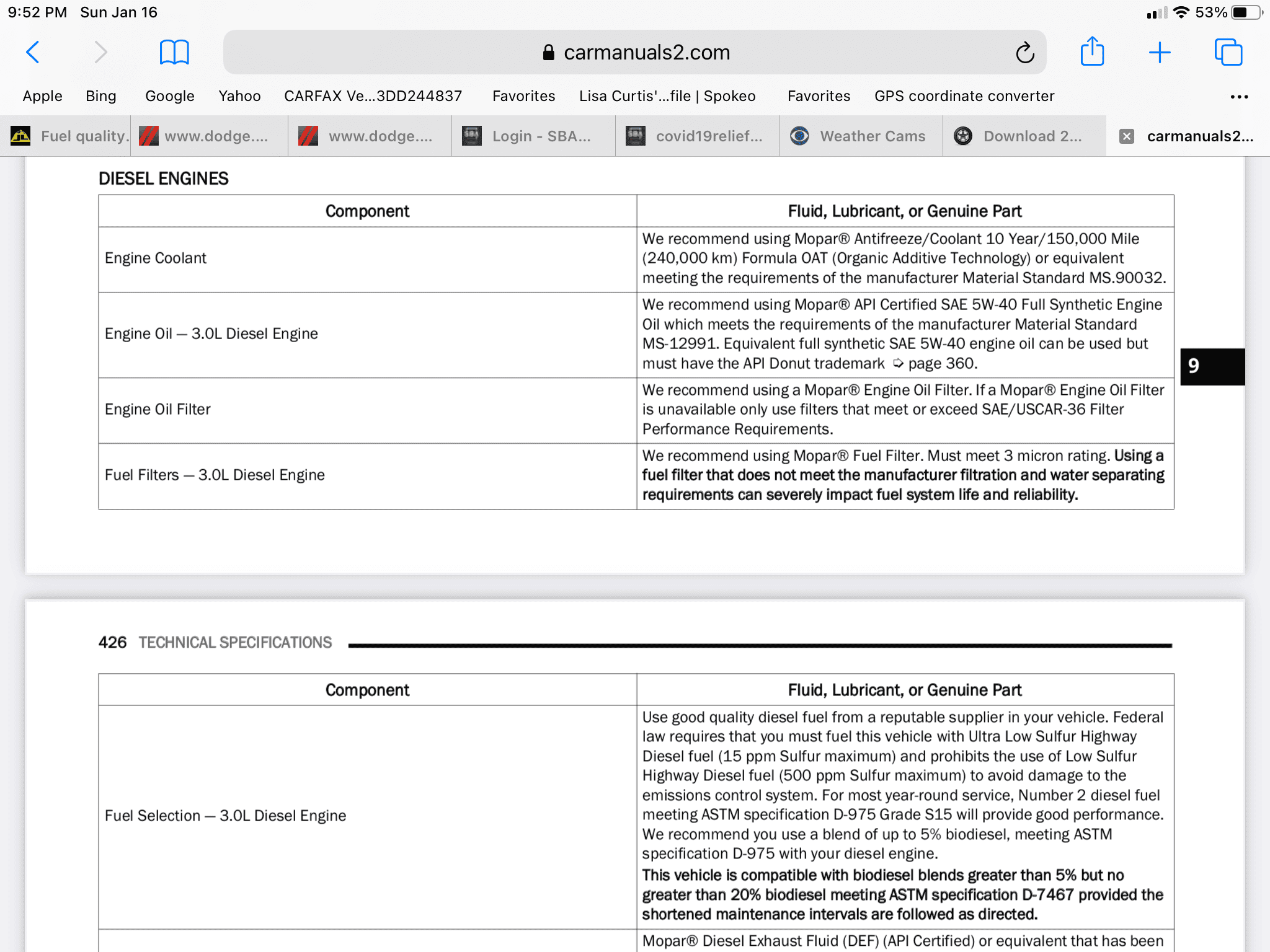

Oddly enough....the disclaimer in the RAM 1500 EcoDiesel manual is NOT present in the 2022 Jeep Wrangler EcoDiesel manual.
Very puzzling...... ?
Right? That’s mostly what I was a bit confused on. I guess it’s tuned differently, but for it to change maintenance recommendations on the Ram, but not the JL? That just surprised me.

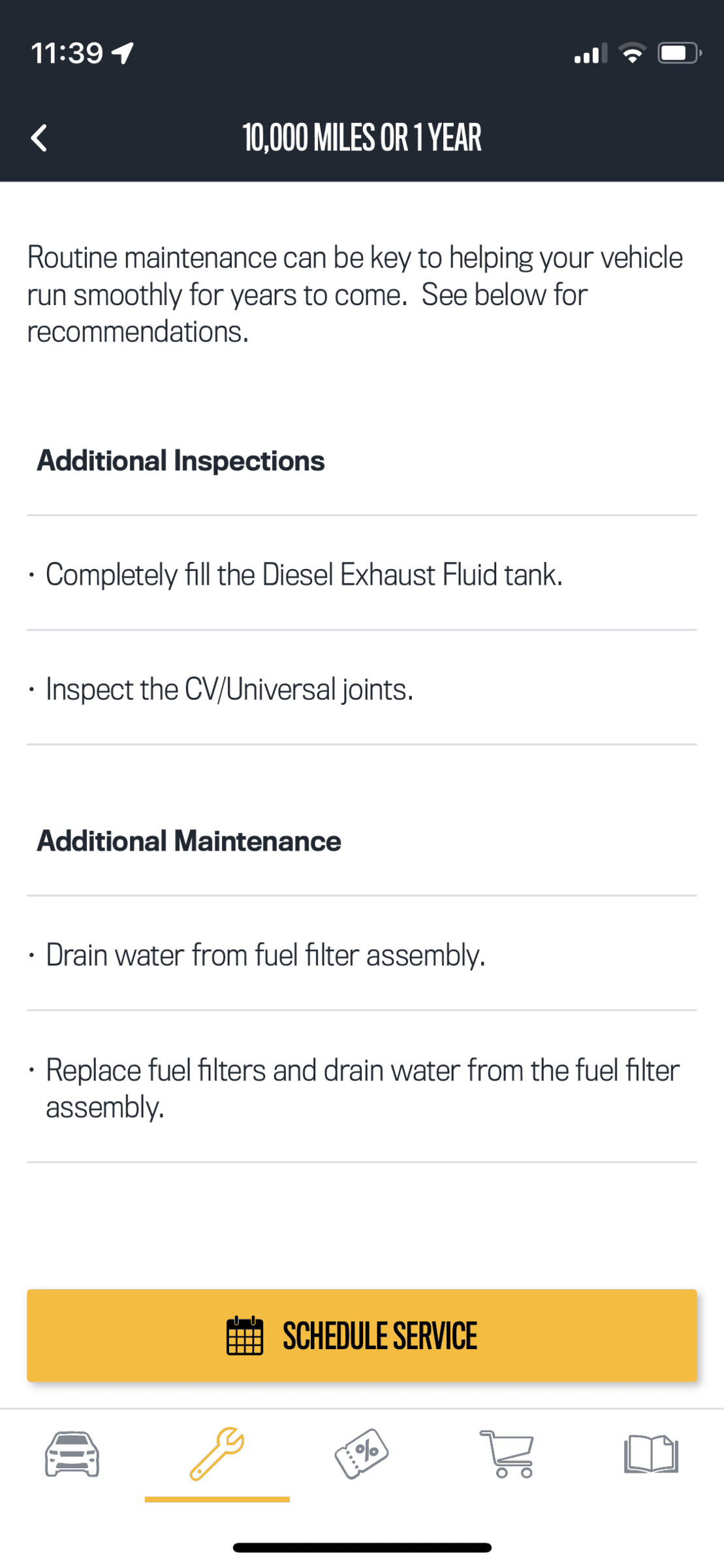

The Jeep app now seems to suggest a fuel filter change at 10k, while my manual does say 20k, which is more inline with my friend’s Ram.
Not concerned, just seems like a change in recommendation.
