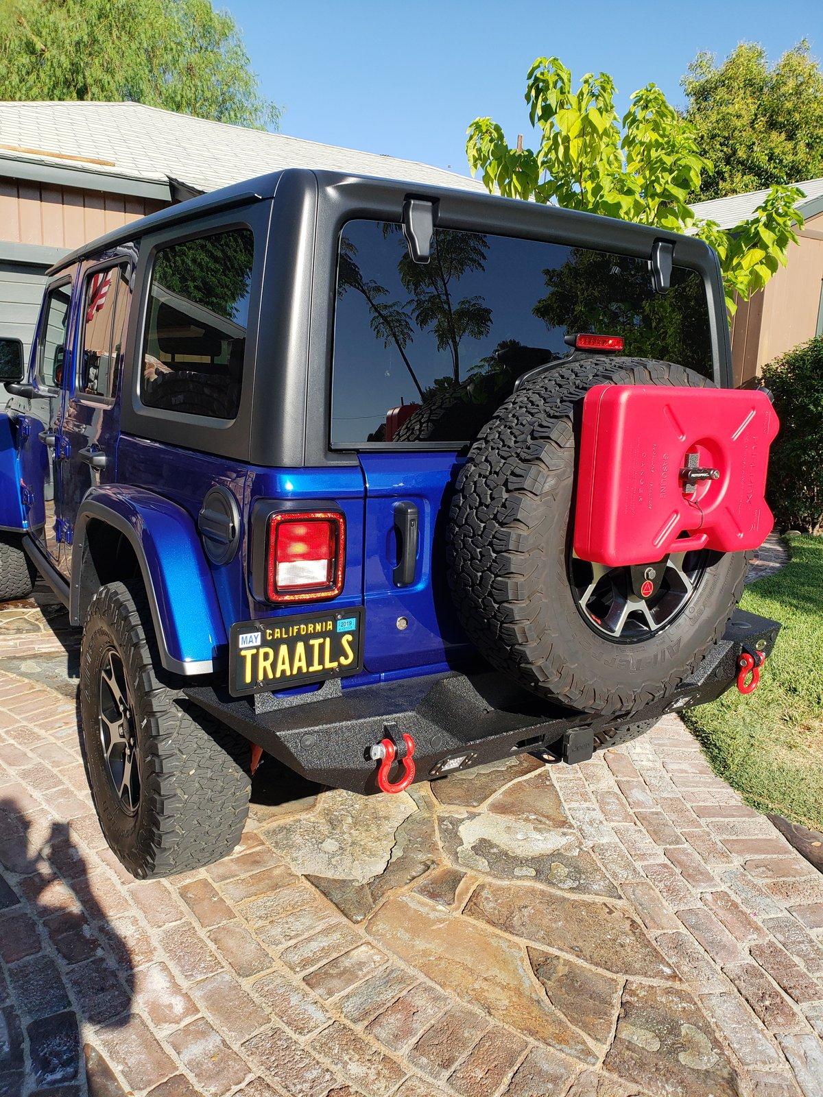

Oh, and on another test, before the whole range starts getting weird and saying low range, after wheeling in Mammoth and driving to Bishop my range said 166. I poured in the full 3.5 gallon can and when we started it up to go have dinner the range had gone from 166 to 222. My reserve can gave me 56 miles.
