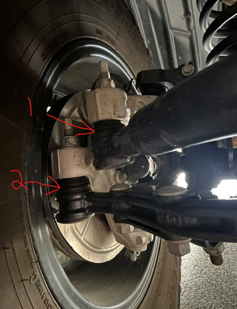

I'm getting some intermittent vibrations when I accelerate from a stop and turn (both directions). Seems like I feel it in steering wheel and my wife says she feels it in seat (please, no comments here) as passenger. I can move both the drag link and tie-rod enough so they clank, the drag link moves more. Are these an issue and connected to vibrations? Thanks!

both of those components cannot be tested on the ground. they wiggle up and down naturally. i doubt this is your cause regardless, its hard to pin point it without experiencing it myself

Retorque the two linkages with the arrows. That is one simple easy check if you have the torque wrench and deep sockets. Could be simple help to start with.
