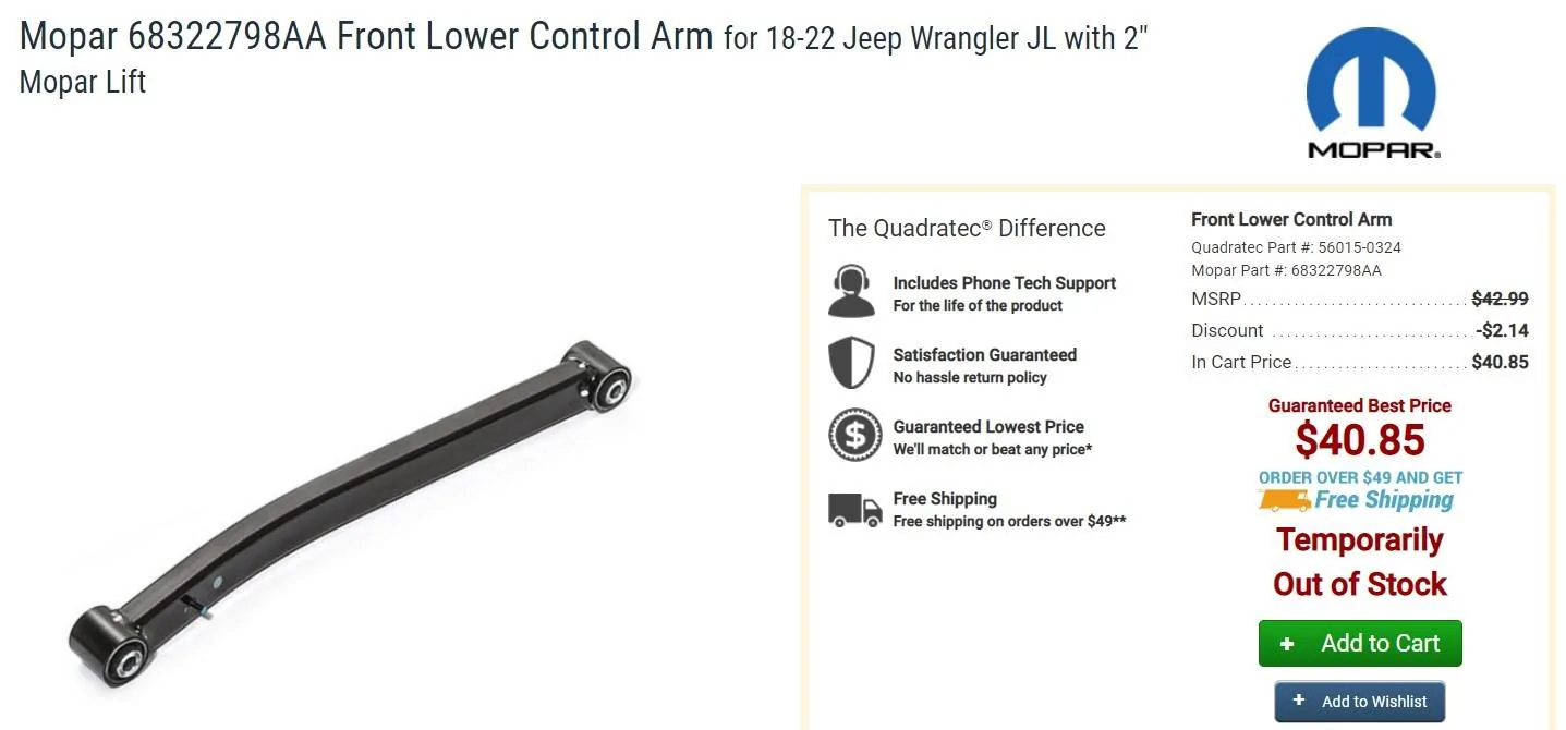

If not looking to lift it for the time being, adding 1/2" spacers to the front is perfectly fine. I would just suggest also adding a set of the mopar lift front lower control arms for less than $100 to increase caster to offset the small height increase. Caster tends to be a bit on the too light side to begin with on a stock height Rubicon.

Headbar... are these the control bars you're talking about?
