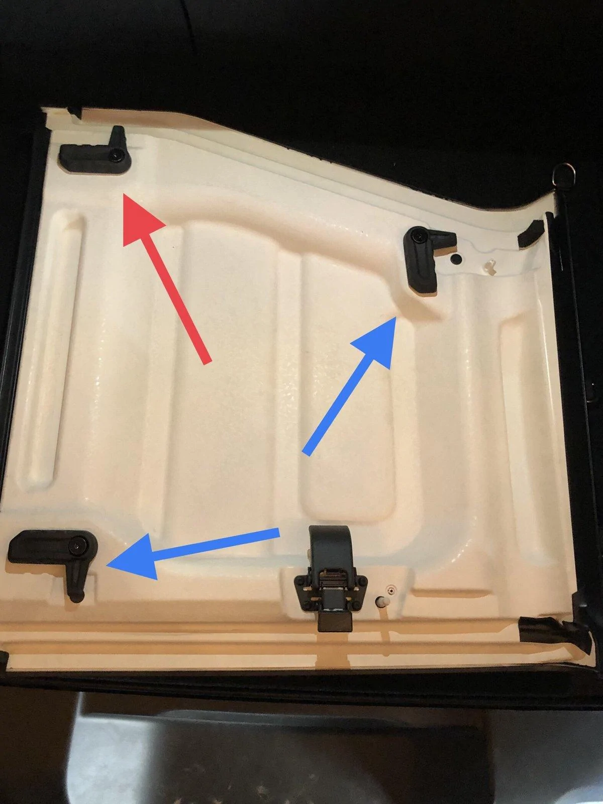

Jeep Wrangler JL Freedom panel hardware (lever) 8C0C2E16-7329-48B0-AC81-A500D1734BFE
Not sure about the screw, but the lever I can help with. This is the passenger panel. The red arrow is part number 68368567AA (or 68368567AD). The blue arrows are part number 68368568AA (or 68368568AD). Opposite numbers for the drivers side panel.
