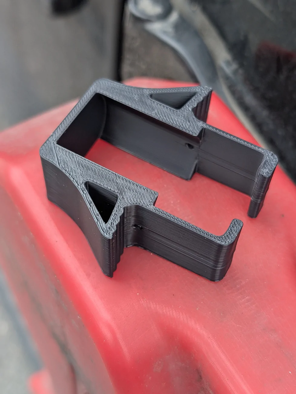

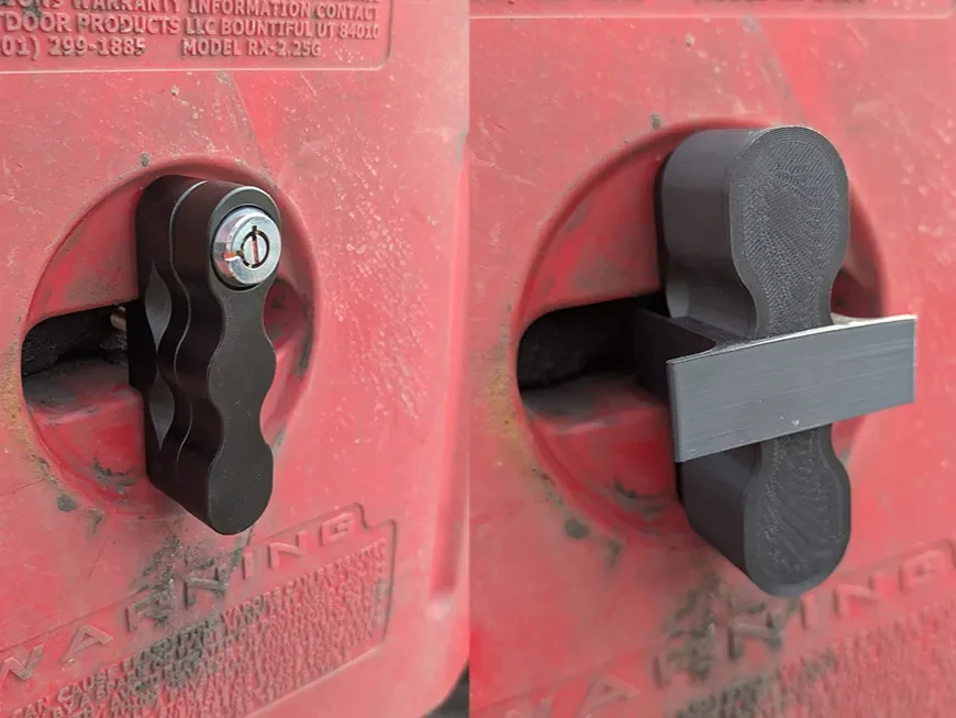

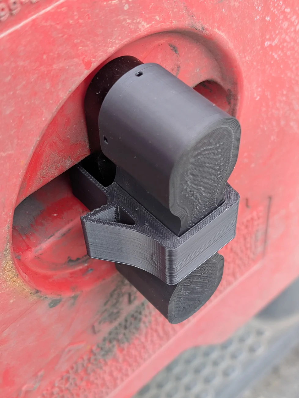

If you carry your Rotopax cans using the LOX mount, then you're probably aware of the barrel lock potentially jamming from exposure to debris and environment. I did some CAD work and made a dust cap and retaining clip for it, to reduce the likelihood that you won't end up with an inaccessible fuel can out in the middle of nowhere. I still do recommend applying lubrication on the barrel lock, but the combination of proper lubrication and this cap should significantly increase the reliability of the barrel lock.
There are two designs for the retaining clip. The original flat one is ideal if you like to have your cans mounted in a protected area, such as within the truck bed. The low profile one will be better suited if you mount your can on the exterior of your vehicle.
