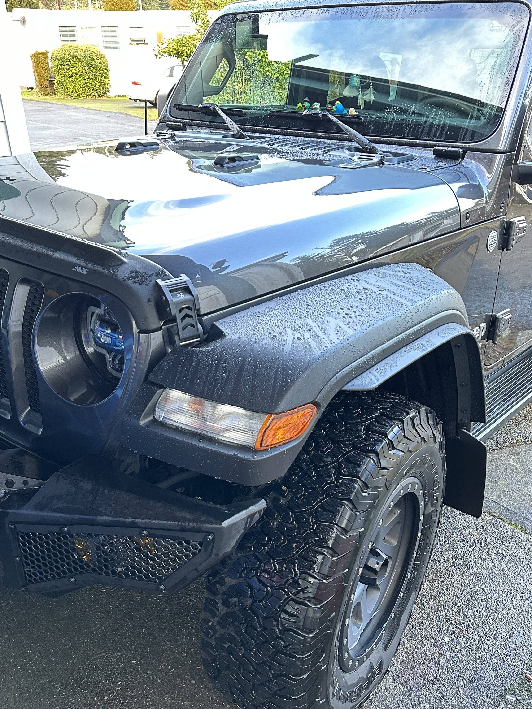

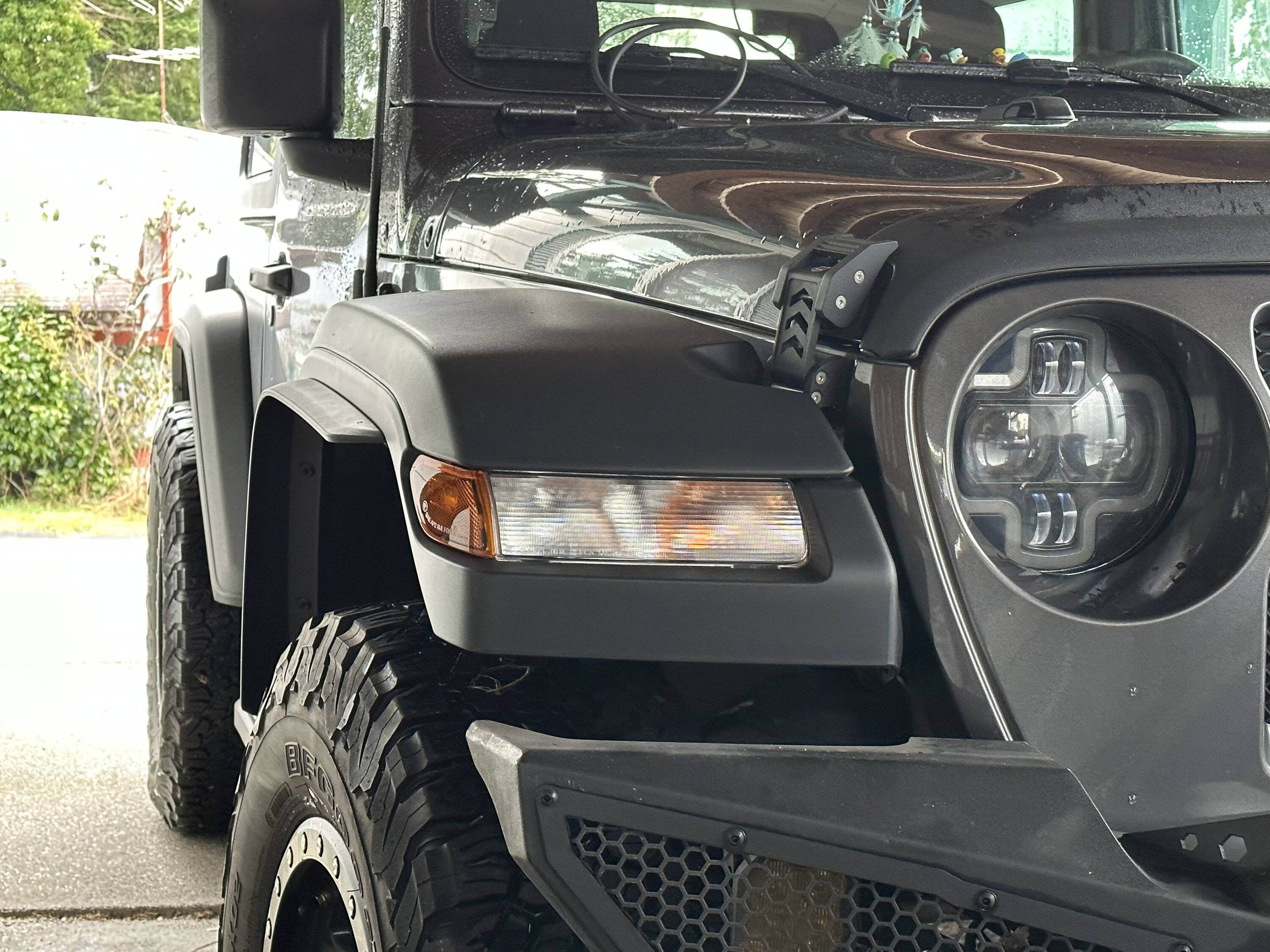

for your reference, here's a shot of my daughter's sport with the +25 method wheels (althoughonly 285's, you'll get the general idea). keep in mind I've also put on the rubicon flares & xr extensions to keep the crap off the side of her jeep.
Jeep Wrangler JL First post!  Question and please check my wheel/tire math. 6FCB4335-DCCE-4C26-A684-3C1D86BFD4C1
Jeep Wrangler JL First post!  Question and please check my wheel/tire math. C1CF8E74-40B0-4393-83EC-8EBD1DF6E8BC
Note, Rubi axles are about 3/4” wider per side
