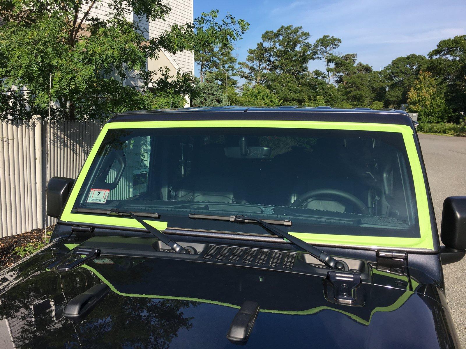

Hi everyone. I recently purchased my first Jeep a 2018 JLU Sahara. I recently changed jobs and didn’t really need a truck any more so I traded my 2015 Ram 1500 Limited when this bad-boy caught my eye. It’s a really fun vehicle, but starting at around 30 mph there was a loud whistling sound from the windshield or roof area that was driving me nuts. The noise was even there with the freedom panels removed. I have a service appointment set up for a couple of weeks from now. In the meantime I was experimenting and I found that by using painters tape to seal around the windshield I can completely eliminate the whistling noise. I imagine a glass company will have to remove the glass, reseal, and reinstall. I just wanted to share my experience in case someone else is experiencing a similar issue.
I have 3,800 miles on my rubicon, and this same whistling noise began about 80 miles ago out of nowhere. Kinda sounds like wooden wind chimes rattling together. I taped my windshield same as you, and the noise went away. Thanks for your write-up. It gives me an idea of what I’ll be up against. I have a svc. Appt. tomorrow at 1:30. @JeepCares
When I first saw this picture I thought you had a Mojito Jeep and I couldn’t figure out why you had a black hood :)
