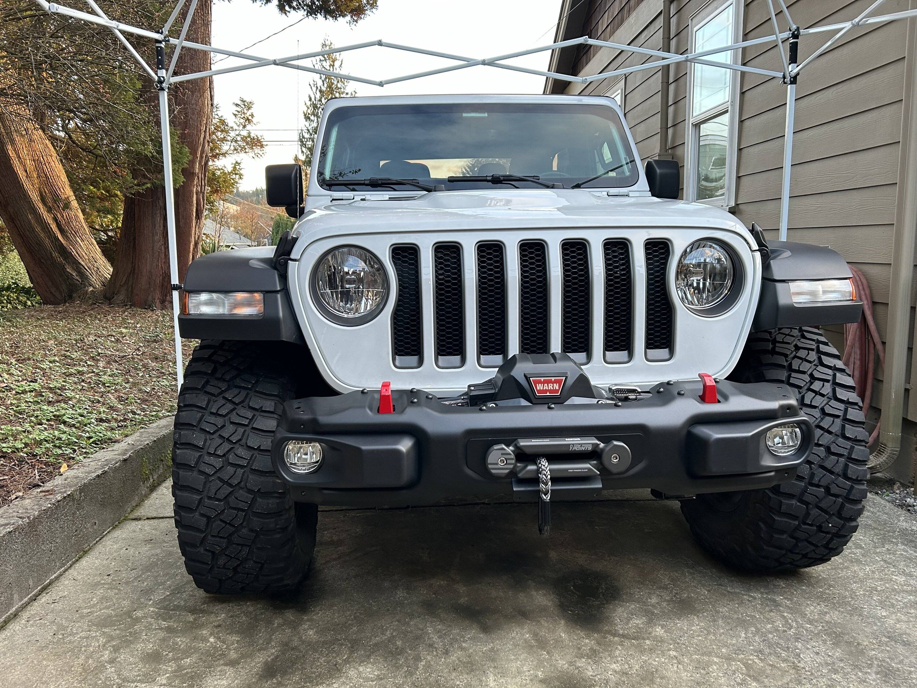

I just bought a stubby Mopar one from Quadratec, along with the steel skid plate. It included LED fog lights, which I wanted. I could not find any used ones and prefer this option over aftermarket. In the process, I learned that the Mopar winch plate is not very good; and everyone was bragging about the Warn winch plate made for the Mopar steel bumper. So I also bought that from Quadratec. The only other thing I had to buy was a bolt kit to fill the unused holes on the ends for the wings. I also got rear covers from Utah Design Foundry to hide the fog lights.

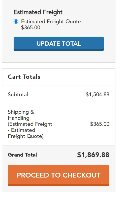

This is why people buy used, here's new:
Jeep Wrangler JL Factory steel bumper 1707935853499
rofl - yeah, buy used for $700.
