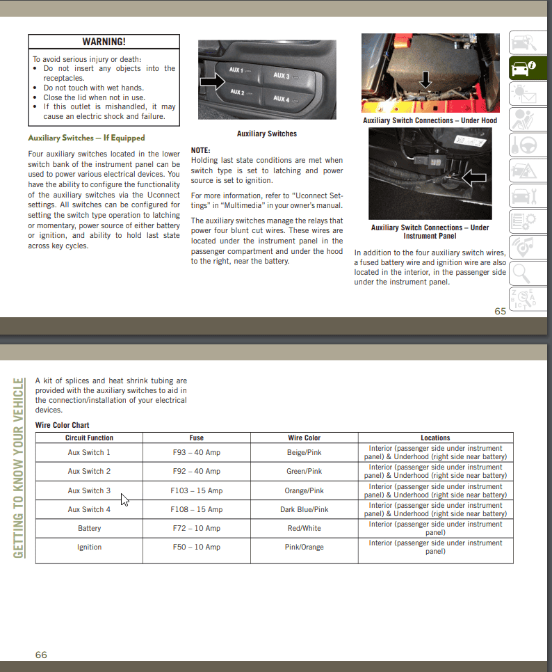

I'm looking for my interior aux switch wires for my 2020 JLU

My aux. switch harness was laying across the transmission tunnel with the leads accessible from the drivers footwell.
This should be fun. Looked for over an hour now...

Six wires in the harness with the ends capped off shrink tubing. I don’t have an actual pic of what it looks like. But this might help.
Thanks, I'm going to look for that sticker. Hopefully that will guide me. The side kick panel doesnt have to come off then?
Check behind the carpet on both sides, driver and passenger foot well at the fire wall. Again, the harness may be laying across the tranny tunnel.
