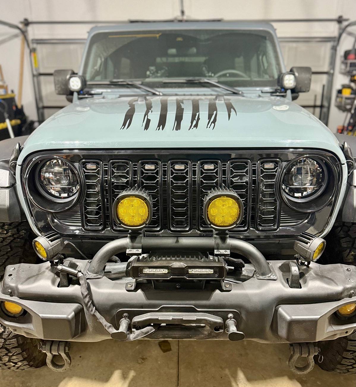

FWIW, Another option is the MP concepts aluminum one which is a complete copy. Surprisingly every hole has matched up exactly when I mounted the bar, fog lights (I originally had in the oem fogs from the plastic bumper and then later flipped them out), front cover, Maximus light mounting bracket. The only real difference I have found is internal where the crash cans are integrated under the plastic bump outs. It even comes with the red upper tow hooks which I flipped out for the black ones from my production bumper.
Love the light setup! Are those Tyri's? How do you like them? Thinking about picking up their fogs.
Deleted member 107602
Guest
Yes all of them are Tyri including the fog lights. They are great. Great light, super durable, quality electronics for a consistent low draw. ( I had some issues with other brands of lights blowing fuses in the past)
Lenses are very reasonable to purchase if you want a different pattern and I switch to the white light in the summer. Since some are the some as the Mopar ones you can get the Jeep covers for those.
The brackets and pigtails in the kit for the fog lights were plug and play.
Highly recommend. Very helpful through Tyri off-road site. Tyrioffroad.com
Also on the non-fog lights I use the Y wiring splitter from Tractor supply best way to link them together plugs right in clean look and heavy duty only. $20, not a fan of the TSC harness just the splitter, I run the rest myself.
