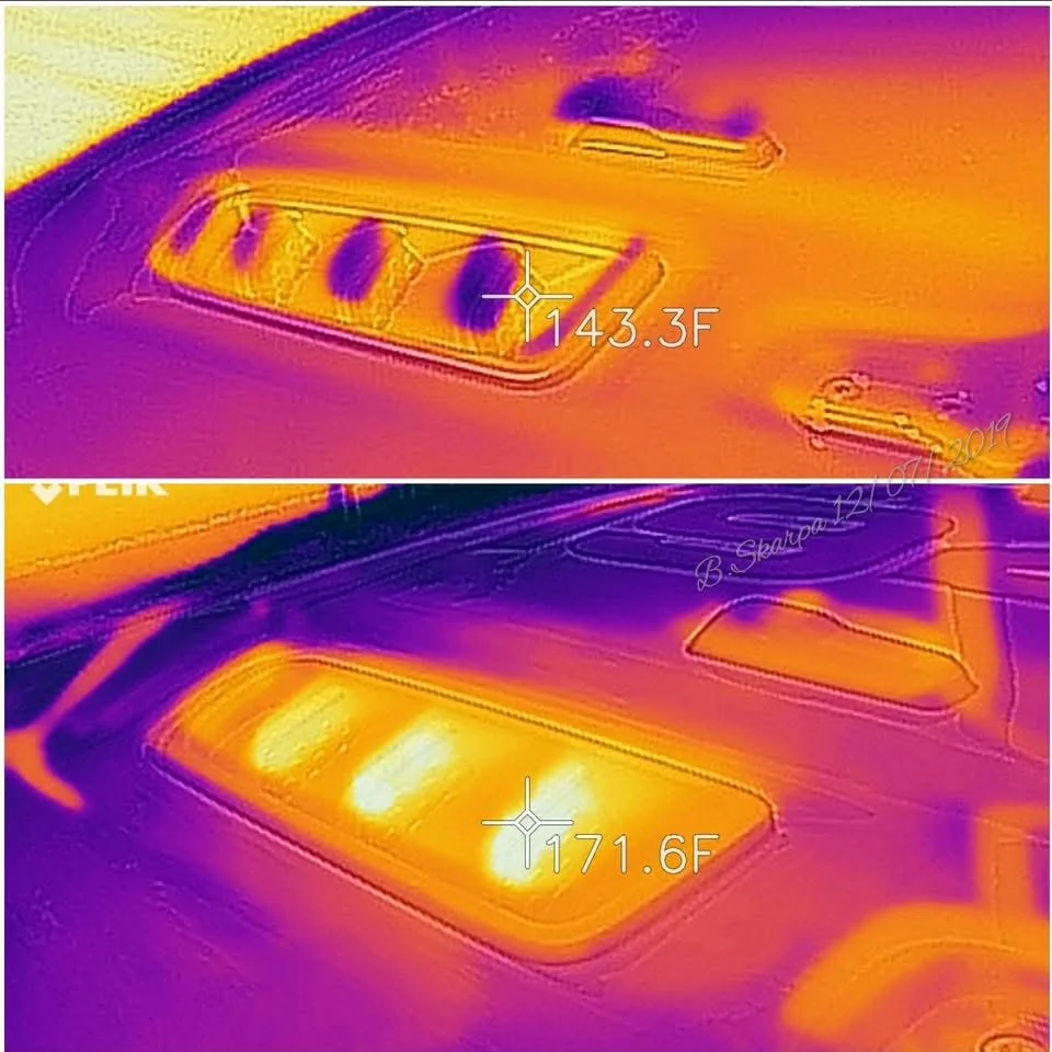

-Ventilated hoods, cooling fan controllers, colder thermostats, and anything else that helps remove heat is your friend. Stock tuning has very very aggressive heat related timing nannies. You could be losing 20-40 horsepower if your engine temps are north of 210 on a regular basis and everything is getting heat soaked. I see it constantly in datalogs. Important on both 3.6 and 2.0 models, but even more important on 2.0. Colder thermostats, yes, they work. The earlier opening allows coolant to flow sooner, allowing the radiator to start doing its magic earlier.
