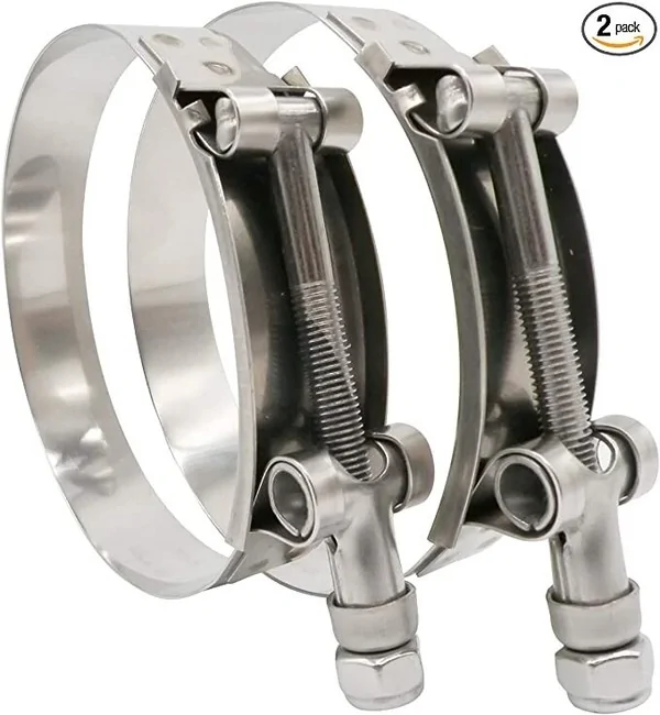

Loosen the lower radiator hose, have a big plastic pan ($12 Amazon). Those squeeze clamps are a pain, replace with one of these...the 1.75" size (Amazon)
