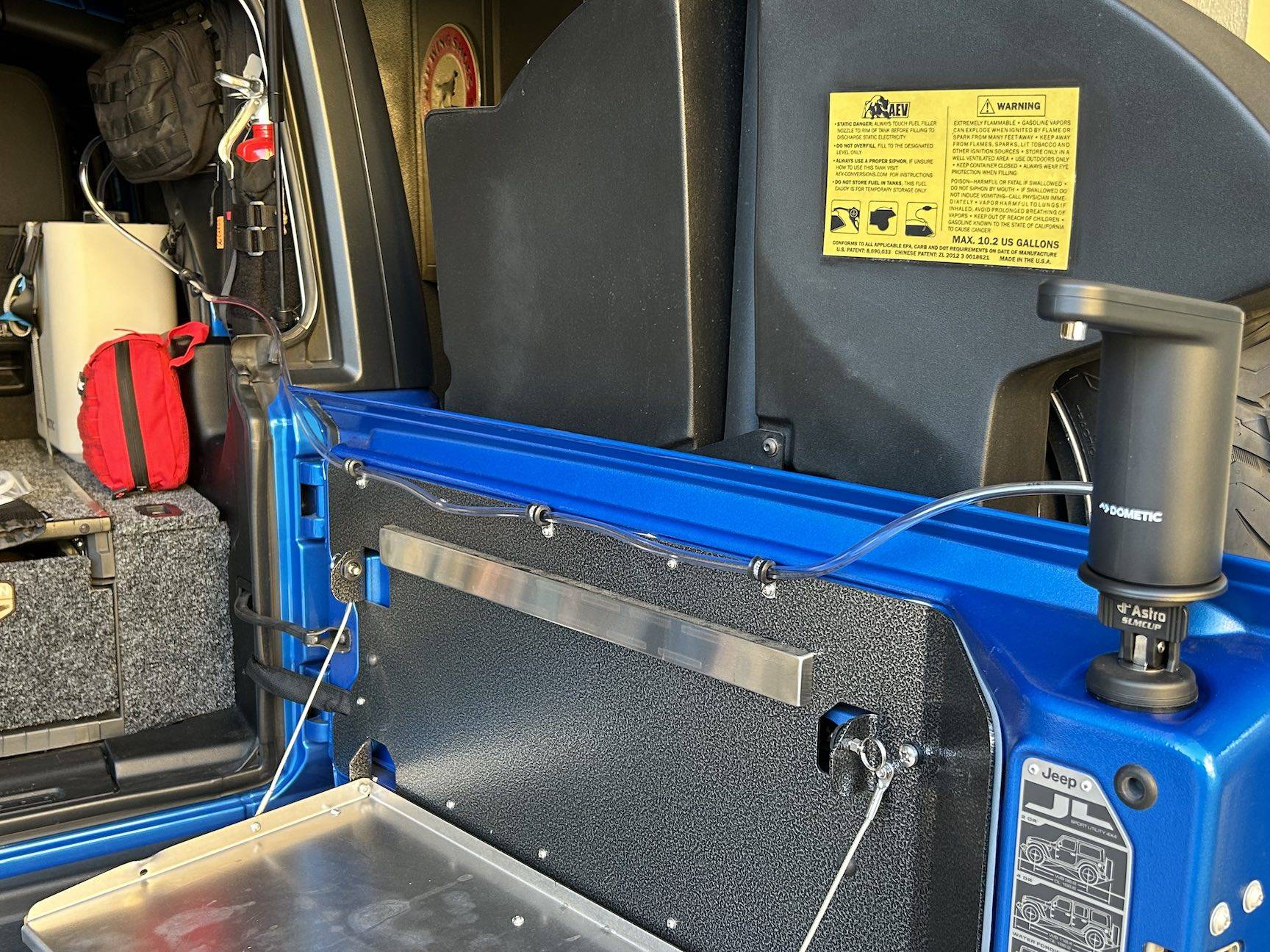

I searched around and couldn't find exactly what I wanted - I did not want a permanent solution. Just something I could easily store and mount. I came up with this:

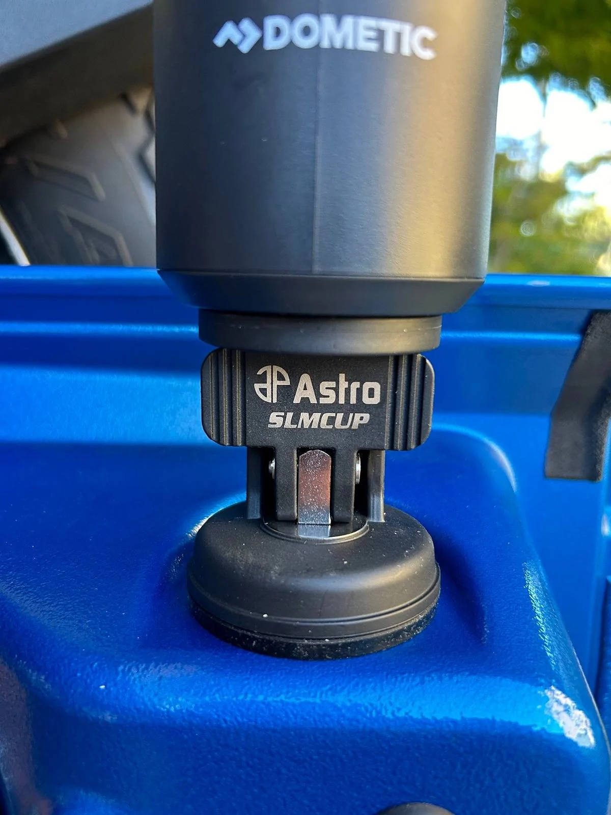

- Astro SLMCUP (Amazon)
- Qty 4 - 1/2 inch wire clamps - insulated

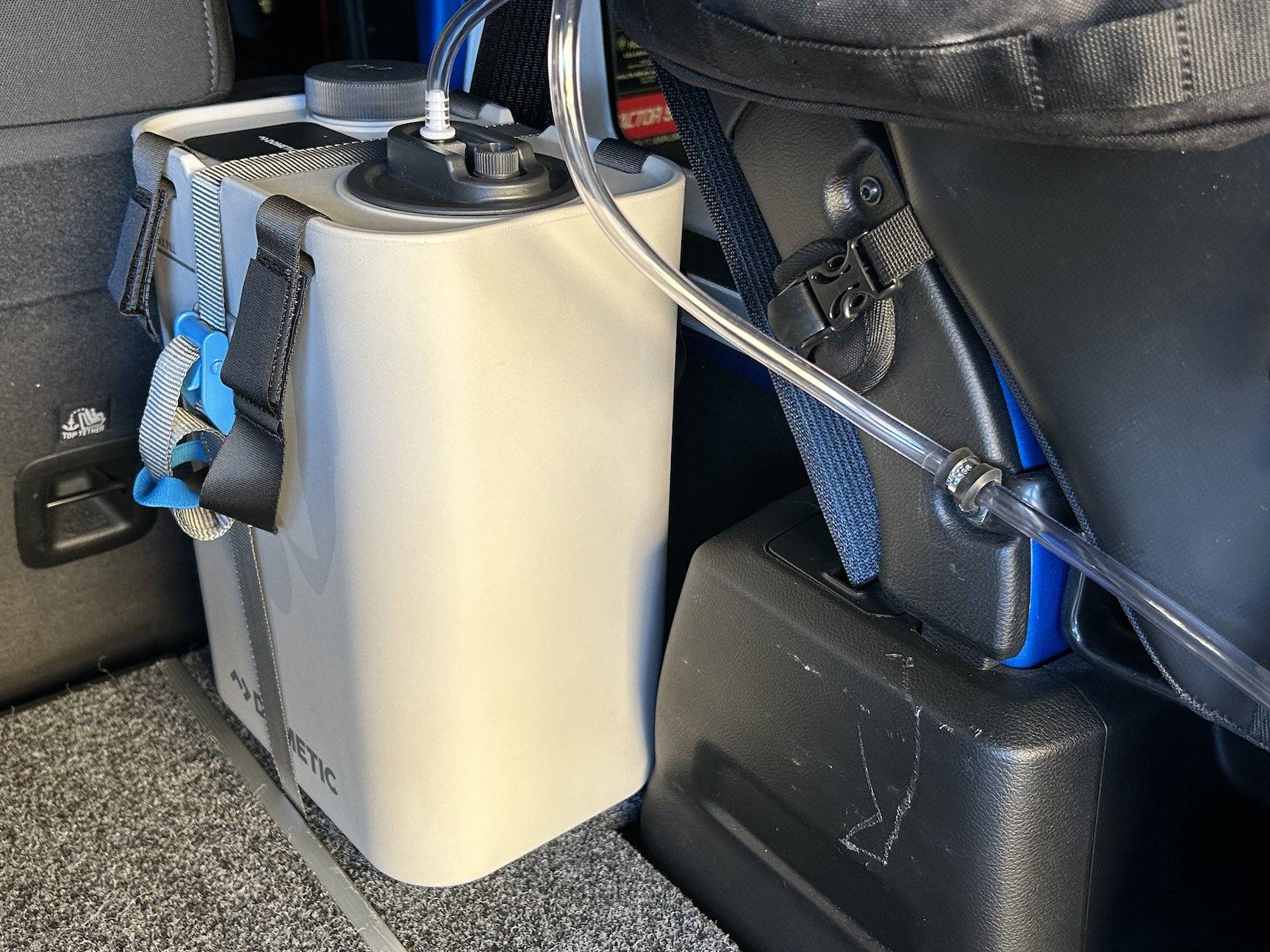

- 7-8 feet 3/8 tubing
- Strap for Dometic 11l Tank
Tube can be fed thru clamps to secure and easily removed - clamps will not fall off (no adhesive)

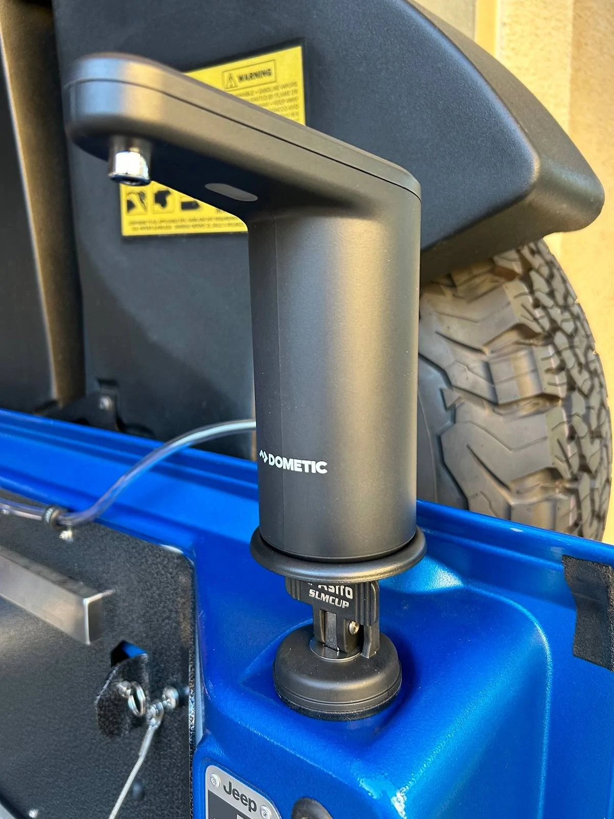

Suction Mount fits perfect to Tailgate Can Holder - and any where else you want to place it
Plenty of clearance when everything is buttoned up - and (besides the tank and faucet) about $24......
