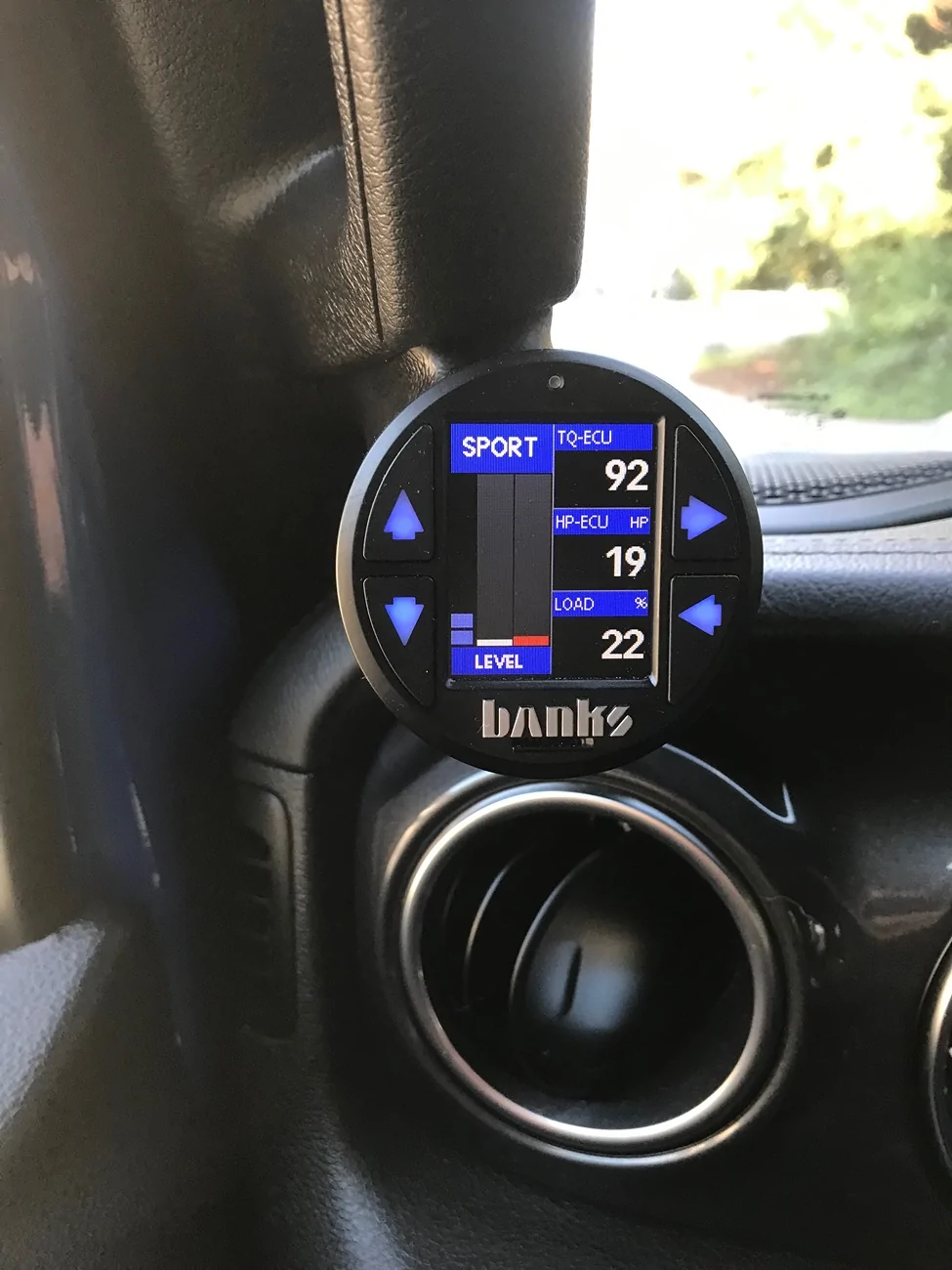

Cool, but there’s always room for improvement - suggestions PM 💰

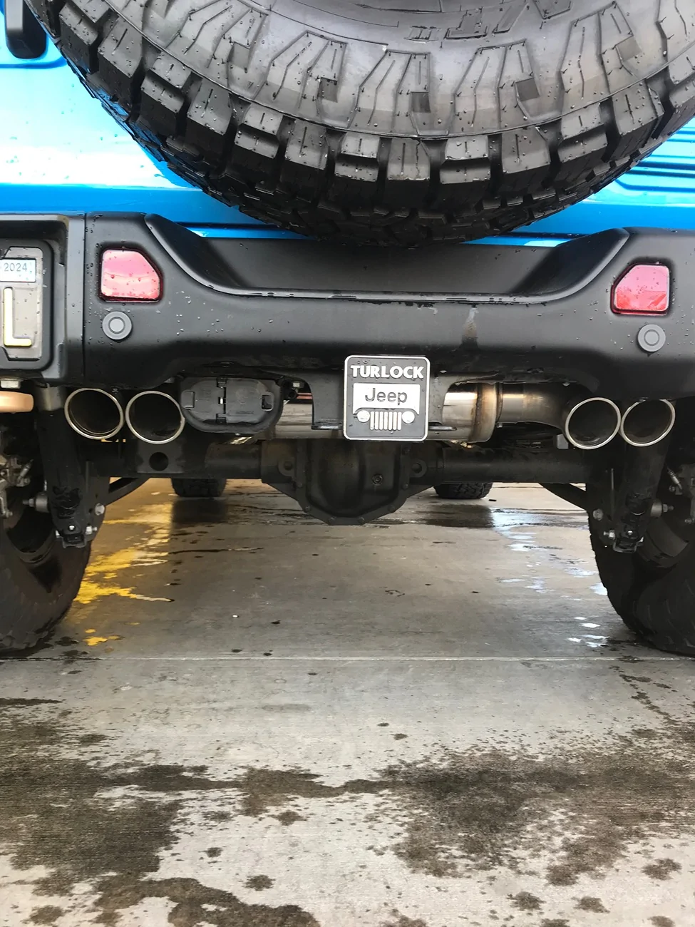

AWE 💰💰💰

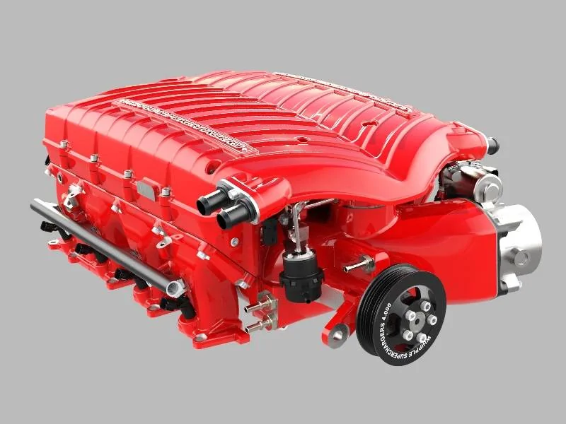

Whipple 💰💰💰💰💰💰💰💰💰💰
Jeep Wrangler JL Does Tazer JL work on 2026 Jeeps? 50EDA605-B34C-4BFA-B57E-0B39251797D2
I’m a little short, just 💰💰💰💰💰💰💰💰💰 to go 🙃
