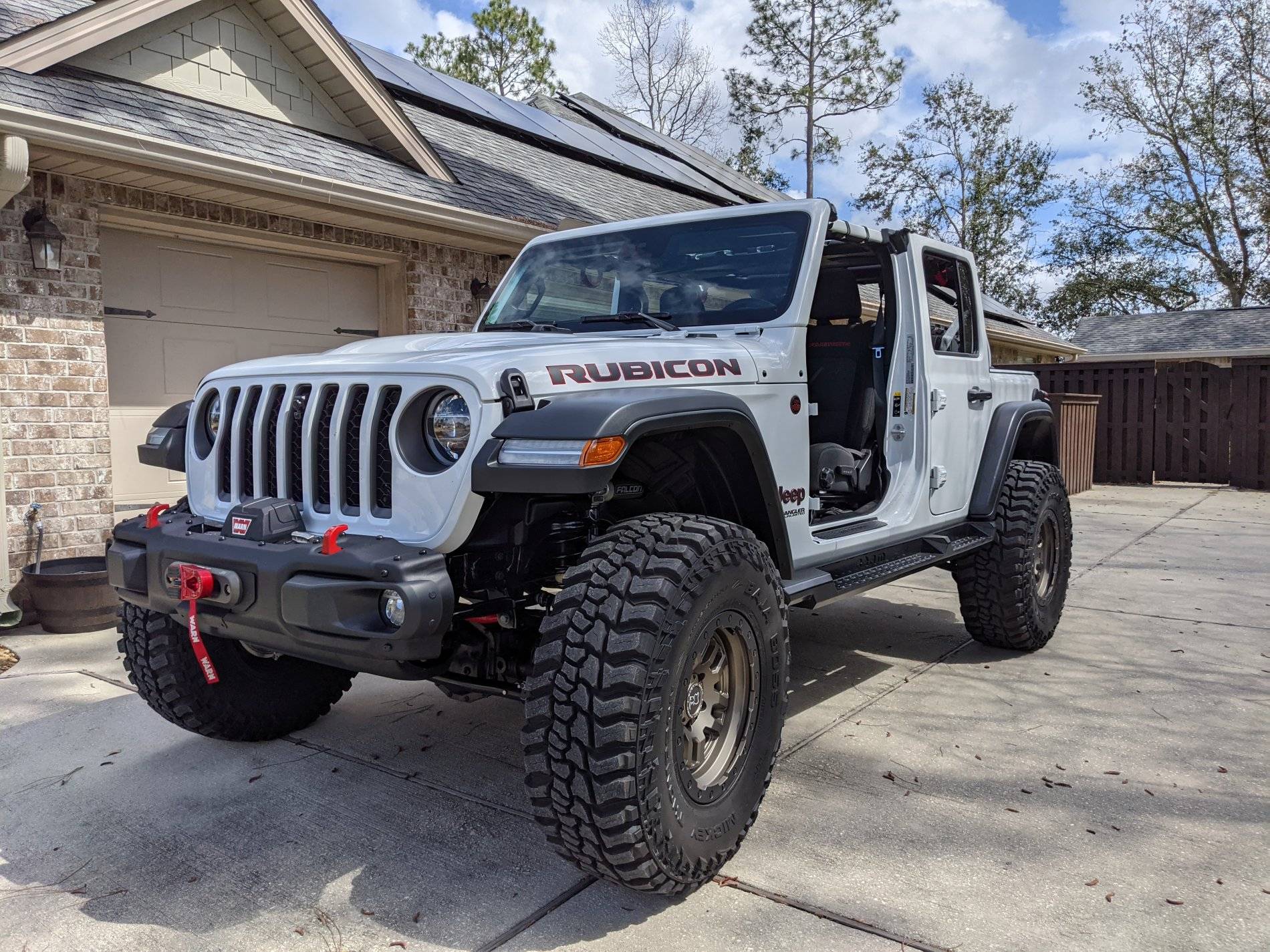

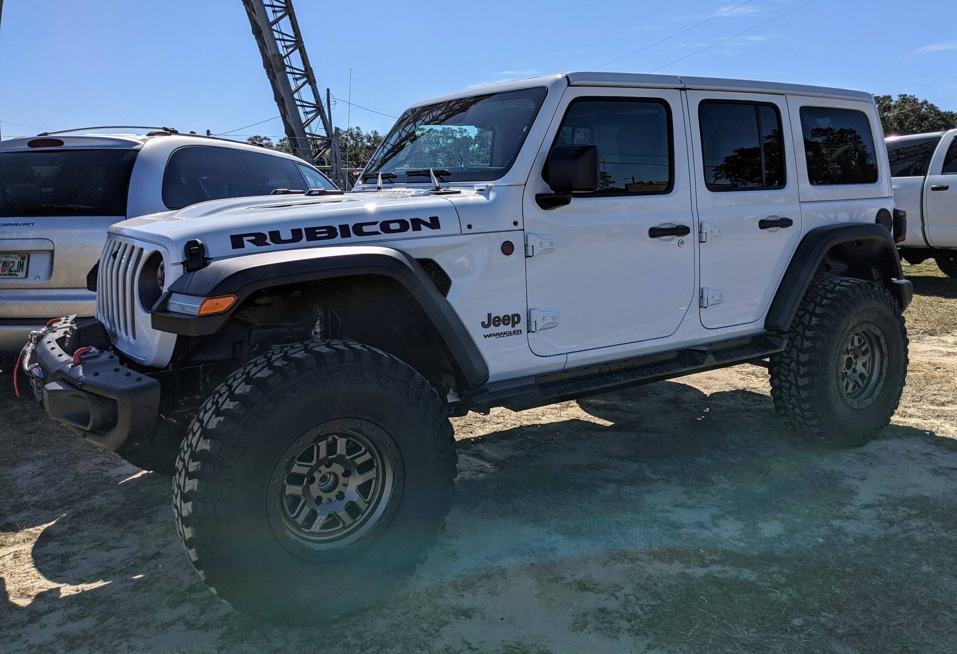

MARSHMELLA
Kirt
Nov 21, 2020
540
1,131
FL
2021 JLUR
Military
Mine did not. I have a 2021 JLUR with the 2.0. I added a 1/2" spacer in the front with the Mopar lift. With a tape measure, the front sits about 1/3" lower but it looks level to me.
But I also have the steel bumpers and a winch that weighs in at about 65lbs or so.
Jeep Wrangler JL Does mopar lift level jlur? PXL_20210310_171238858
Jeep Wrangler JL Does mopar lift level jlur? PXL_20210310_171321544
Jeep Wrangler JL Does mopar lift level jlur? PXL_20210310_171312633
Jeep Wrangler JL Does mopar lift level jlur? PXL_20210203_171539987

Mine did not. I have a 2021 JLUR with the 2.0. I put a 1/2" spacer in the front. With a tape measure, the front sits about 1/3" lower but it looks level to me.
What size tires are you running?

Spank
Mar 29, 2017
2,698
4,590
Mine wasn't quite level either because of the steel front bumper. Adding a winch made it worse. I corrected it with 1" spring spacers and it's close, but I still have about a quarter inch of rake.
