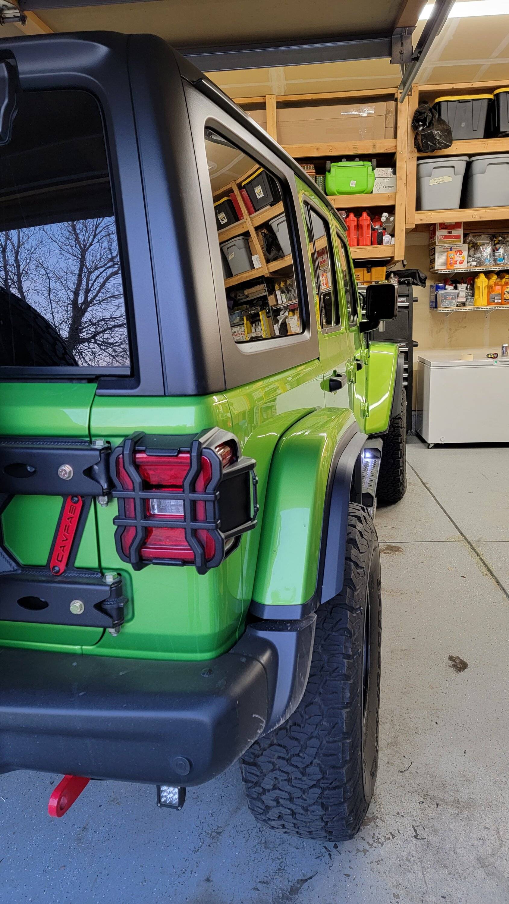

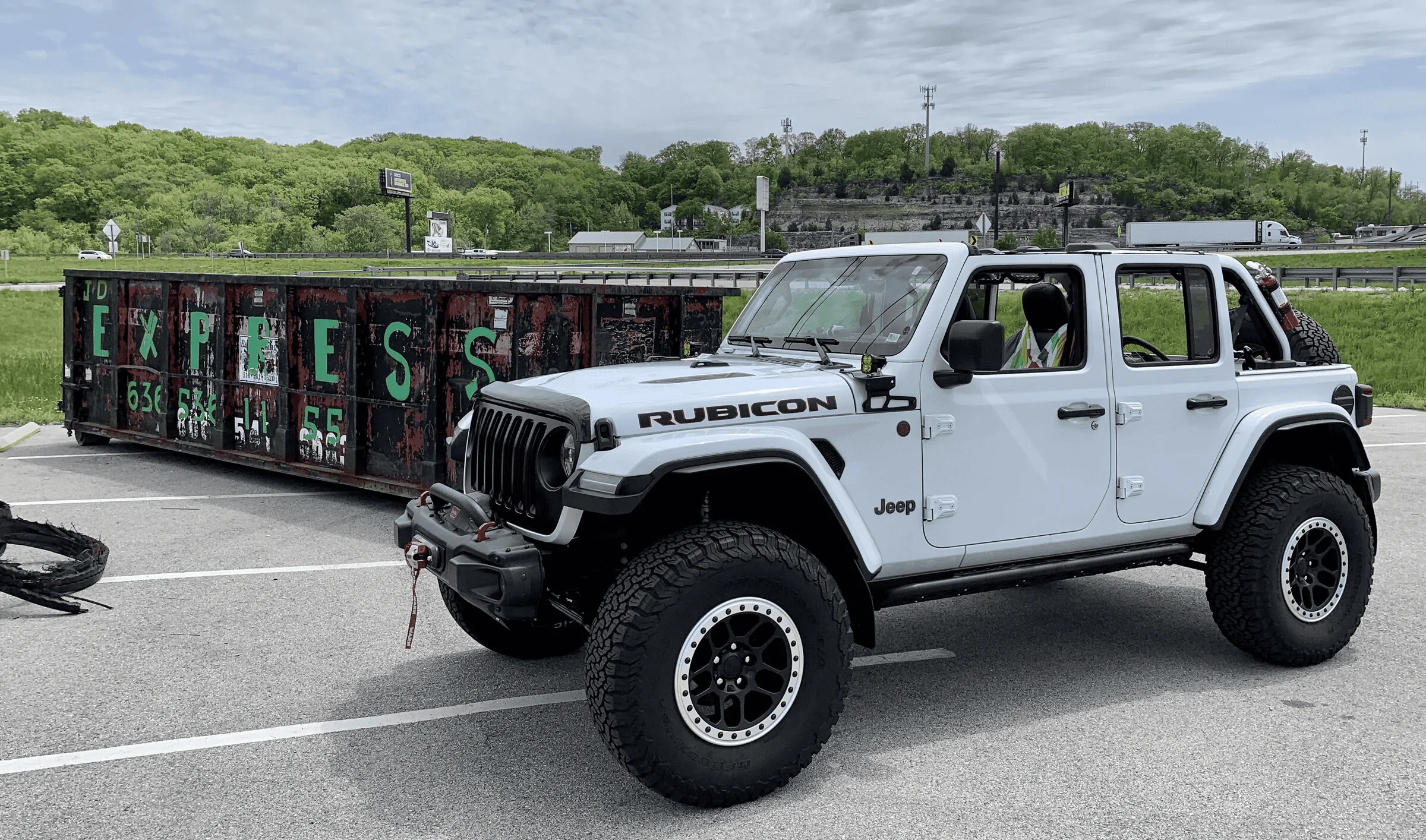

I believe with +10mm, you will still have some poke--look at mine at the bottom of the rear fender, I probably have 1-1/2" of tire out of the fender edge (not counting the XR extension). It is harder to see on the front fenders because they taper, but the rear fenders are fairly straight.
So based on an 8.5" wide rim... if +10mm has some poke, what would the offset need to be to keep the rear tire flush with the fender?
+30mm ?

Ahh, I’m thinking +10 being nearly flush on non Rubicon axles.
AEV wheels are +25 and they are slightly less than flush on Rubicon axles.
+30mm ?
+44mm would be the easiest (about 1/2" less poke than +30mm). I do not think anyone makes +30mm. I have seen +44mm, +18mm, +12mm, +6mm & 0mm
