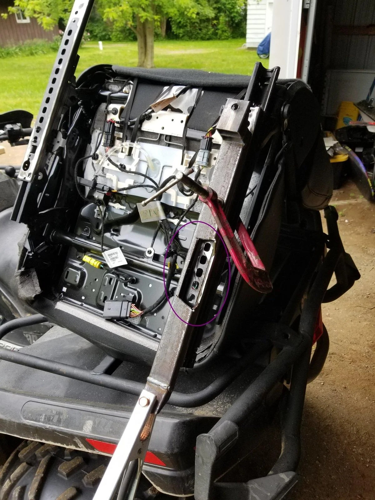

First thing I did was to pull the passenger side seat to mock up a mount to build the new seat brackets in.
Driver side was a mirror of passenger, using passenger side left me able to drive in the couple days it took.

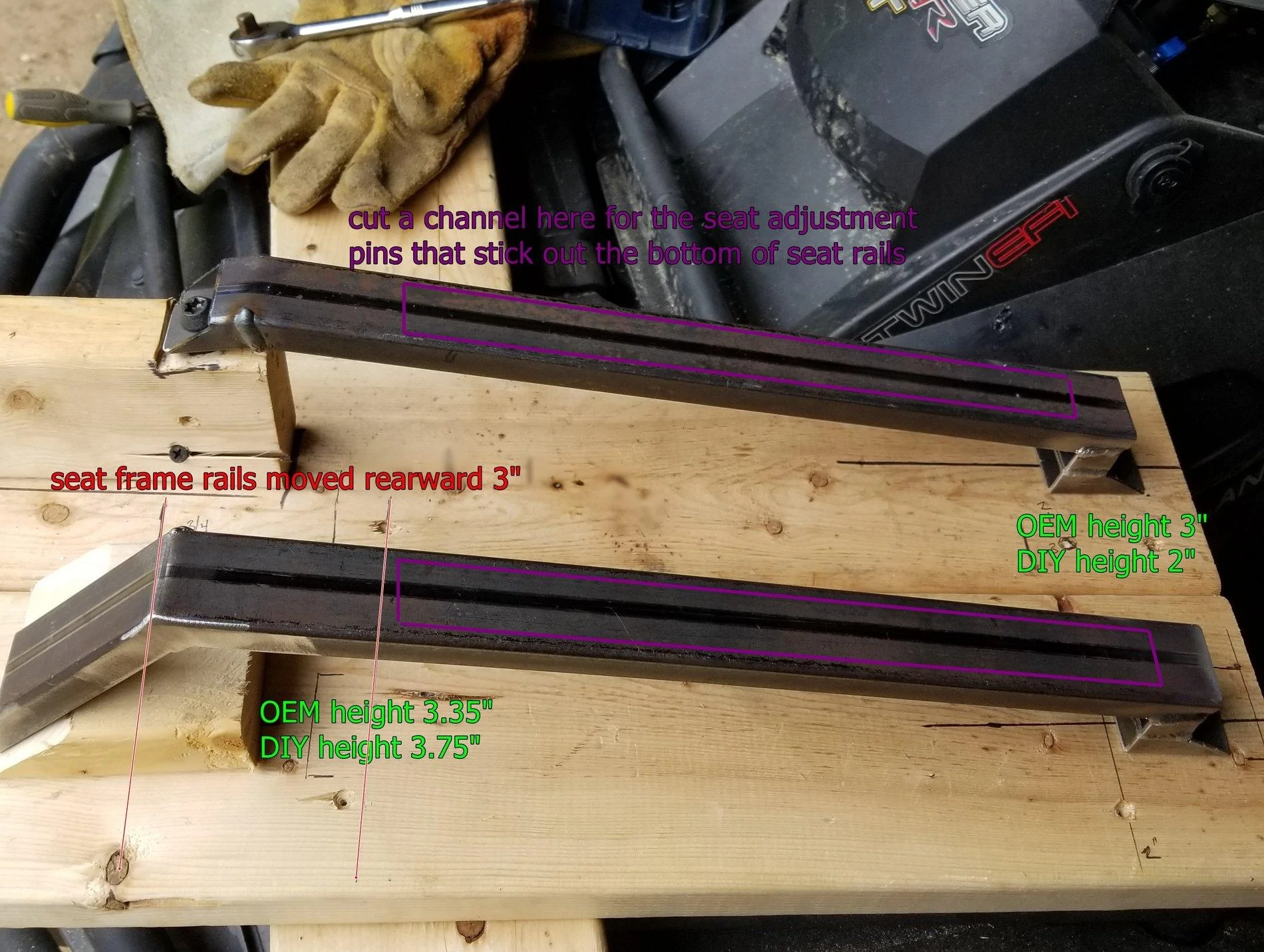

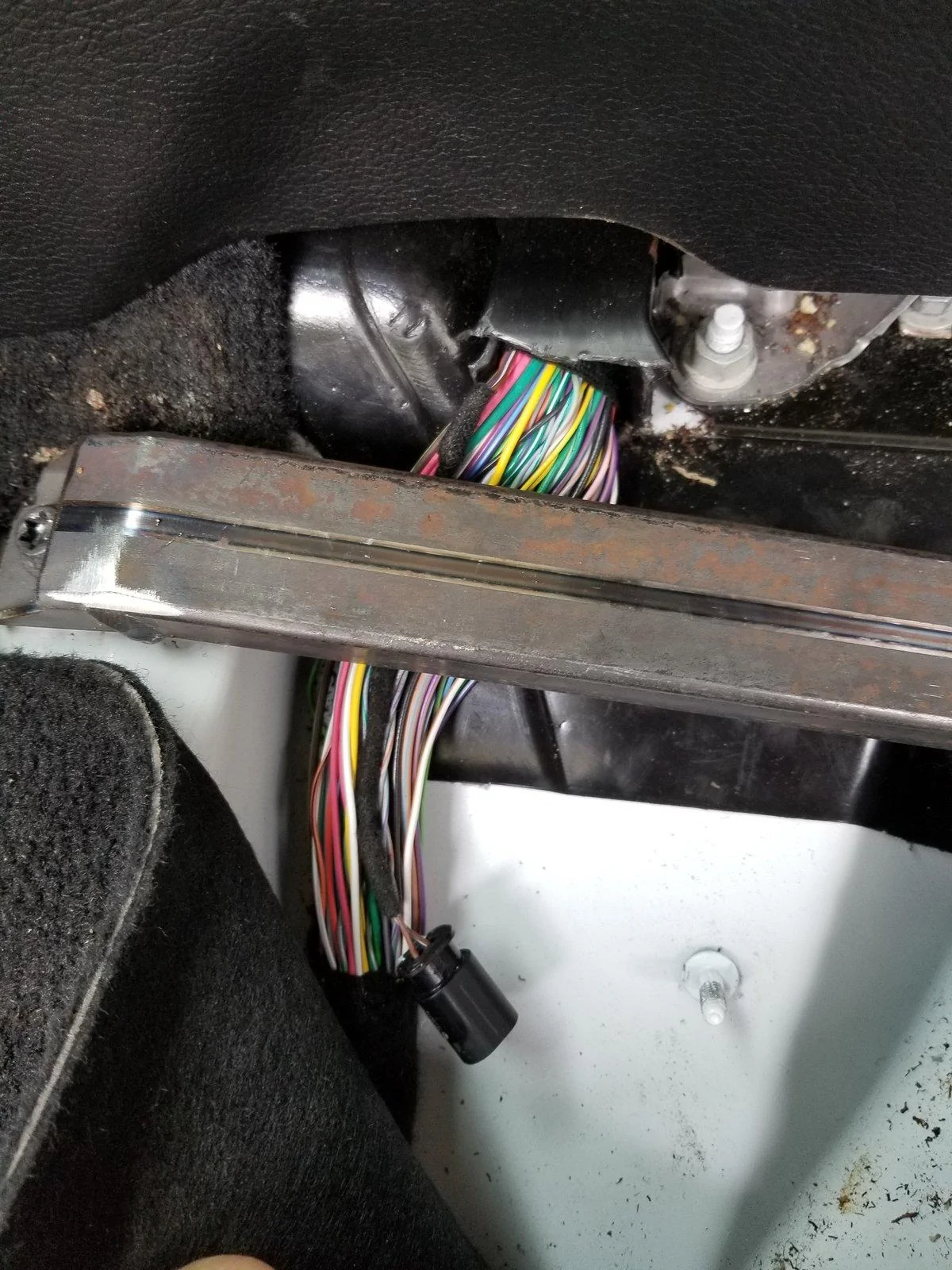

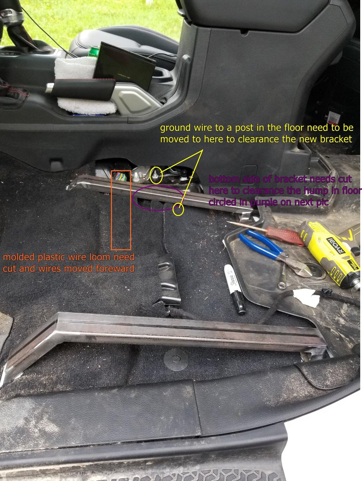

My goal was to move the seat back about 3" and add a put a little more slope to the bottom of seat(it felt too flat for my tastes). Clearance becomes an issue on the bottom side of the new brackets due to a hump in the floor.

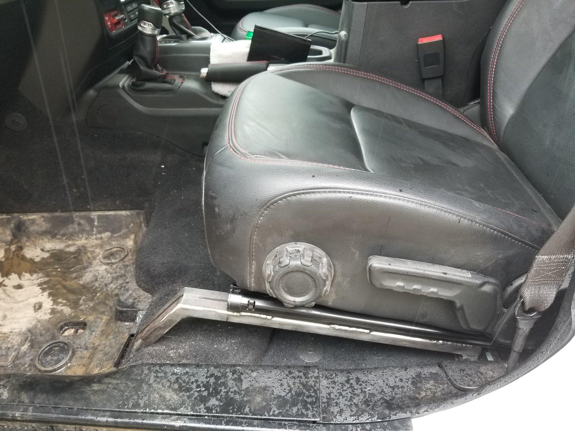

My brackets moves the seat back 3" and changes the angle from 5-6 degrees(IIRC) to 11.5 degrees.
I used some 1/2 x 1 1/2 square stock(rectangle stock?) from Alro Steel $10. Ive seen square stock & C channel at some Home Depots/Lowes also. Measure 2 or 3 times, cut once. I made the feet at the back of bracket first, then made relief cuts & bent the long portions of the bracket

You need to use a cut off wheel to remove the OEM stamped steel brackets. They are spot welded on and rather bothersome & tedious to cut/grind out. I used my cheapo Ryobi 4.5" grinder and cut off discs, wire wheel & flap discs from Harbor Freight when they were on sale. Lincoln 210 MP which ive wanted for a while, but purchased just so i could start this project. It took me a couple batteries in my grinder to cut these off....would definitely recommend a corded grinder.
Moving the seat rails back makes it a bit of a challenge to reinstall/tighten the T50 bolts in the back of the bracket. I ended up knocking the T50 bit out of its 3/8 socket and then used a 5/16 wrench to tighten. The height of my new brackets leaves just enough room, kind of a PITA but doable(dont forget to use red lock tite).
