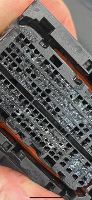

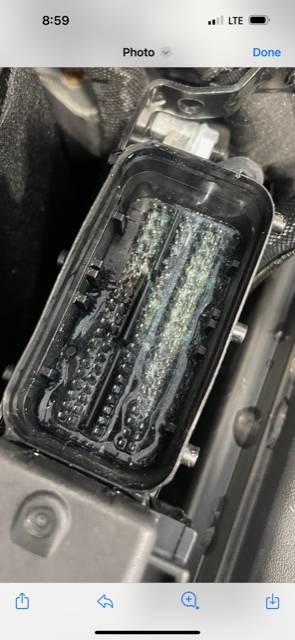

I’d try diesel extreme vs the EDT here. Hopefully it’s bad fuel if you don’t have any alerts for water in fuel or a CEL. Mine did this a bit before the CEL, and the fix wasn’t quick… This is a wet connection in the harness off the PCM. No bueno. Connection was tight but the gasket failed.

@GrayGunner Thanks for the heads up. I just got the EDT so will try that first. Luckily I don't drive a lot as I work from home. I will look for the connector and check it out. DId you have to replace the wiring harness? I had to do that on my son's SAAB. Definitely was a PITA.

Yeah, a new harness, though not an entire harness like I think you did with your SAAB. Fixed under warranty at the dealer so it’s on the record if I get another gremlin down the road. Got lucky, the wait for part availability was 2 weeks instead of 4-5 like the dealer stated. They’ve seen this issue across the board so it’s not just a diesel thing. However, they also fixed my oil cooler leak while I waited…which definitely seems to be isolated to us ?.
