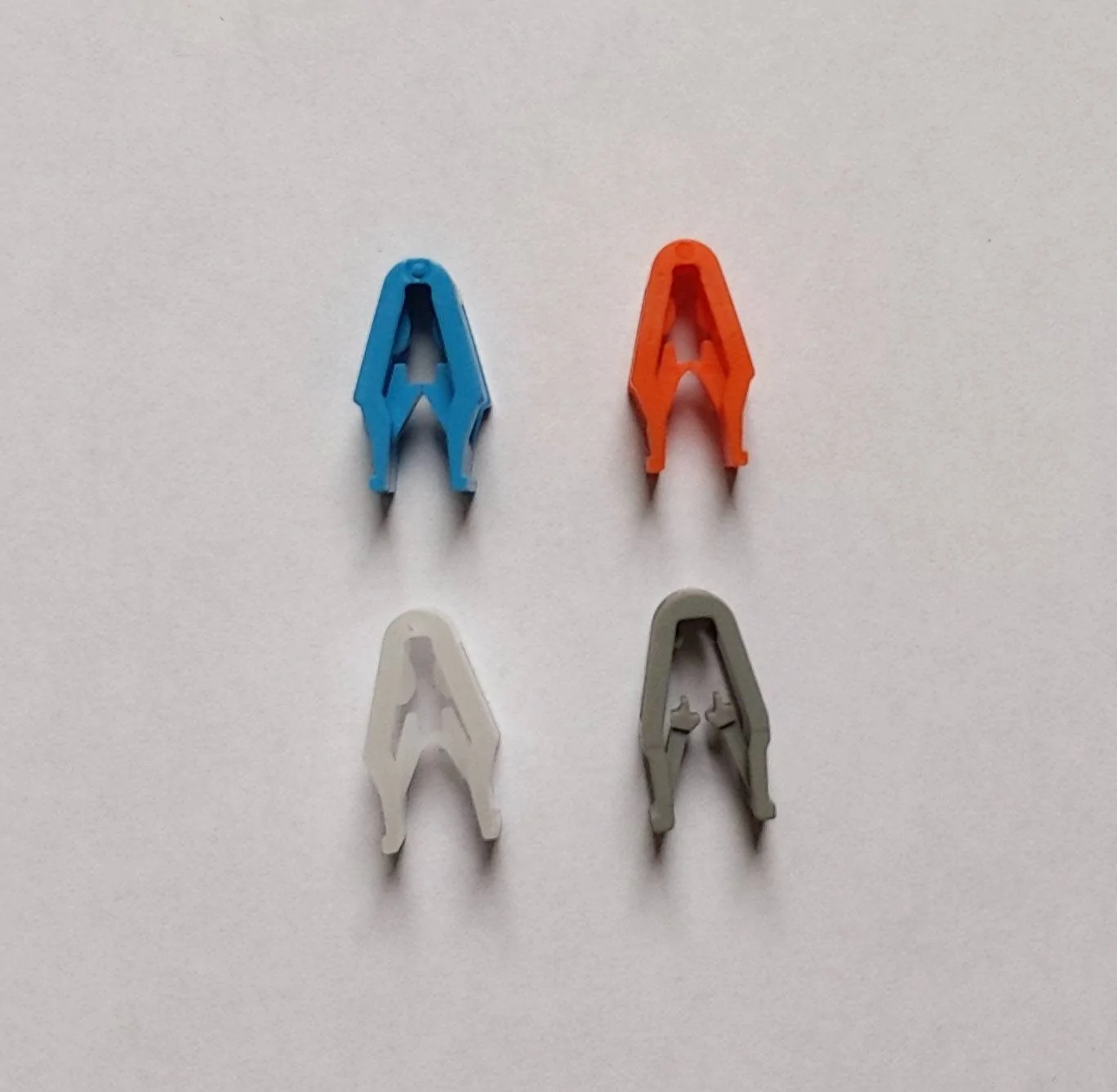

Does anyone know what these are called and if I can get replacements?

The only ones we have been able to identify over time are the white ones https://parts.allmoparparts.com/oem-parts/mopar-clip-cluster-bezel-to-i-p-6510407ab
I am not sure if they are color coded by size or if the factory ones differ from the replacements. These are used in multiple locations throughout the instrument panel.

The orange, blue and white clips are the same size. The blues are stiffer and grip tighter, I haven't noticed a difference between the orange and white. The blues tend to cause damage to the plastic, I never reinstall them and always swap them out for whites.

Found my pic.

The bottom right clip is a little different.

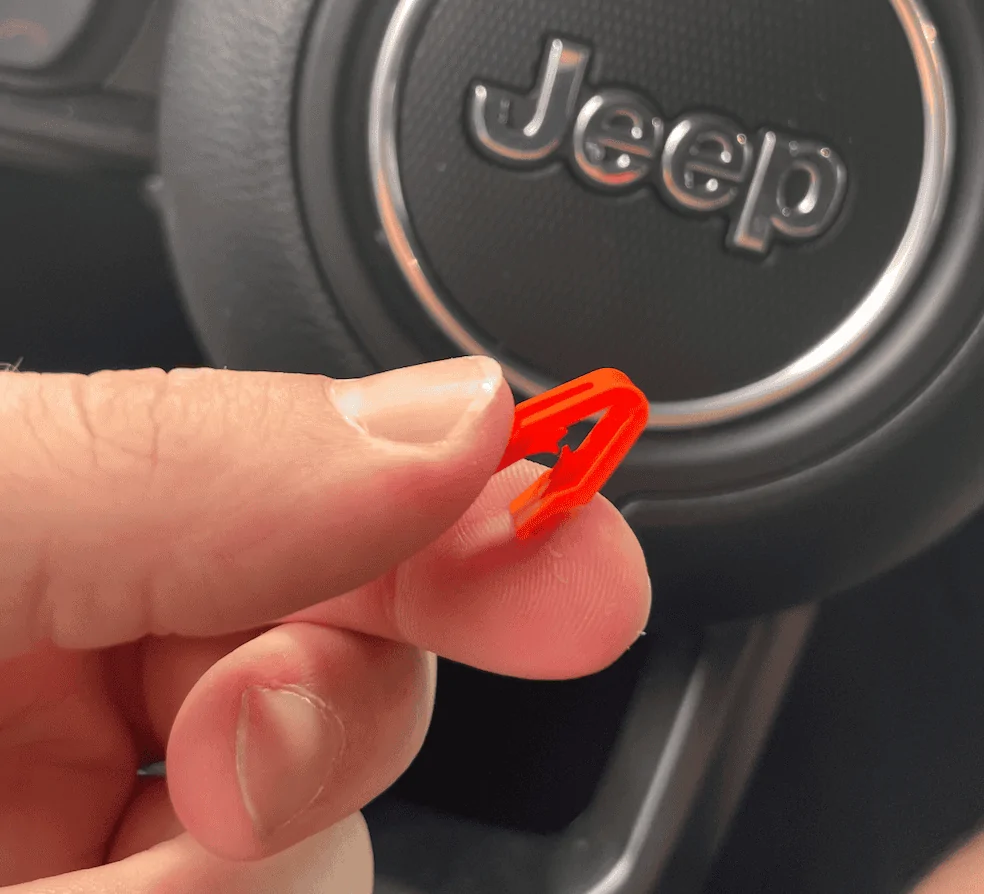

I found one of these on the floor. Where did it come from? where should I look? lol...

Everywhere lol, They are used throughout the dashboard.
Did you have any recent service work performed?
I lost a white one when I removed the panel under the steering wheel. Found it a month later on the drivers side floor

Eh probably not , I would hang onto it for the next time you need to pull anything apart
