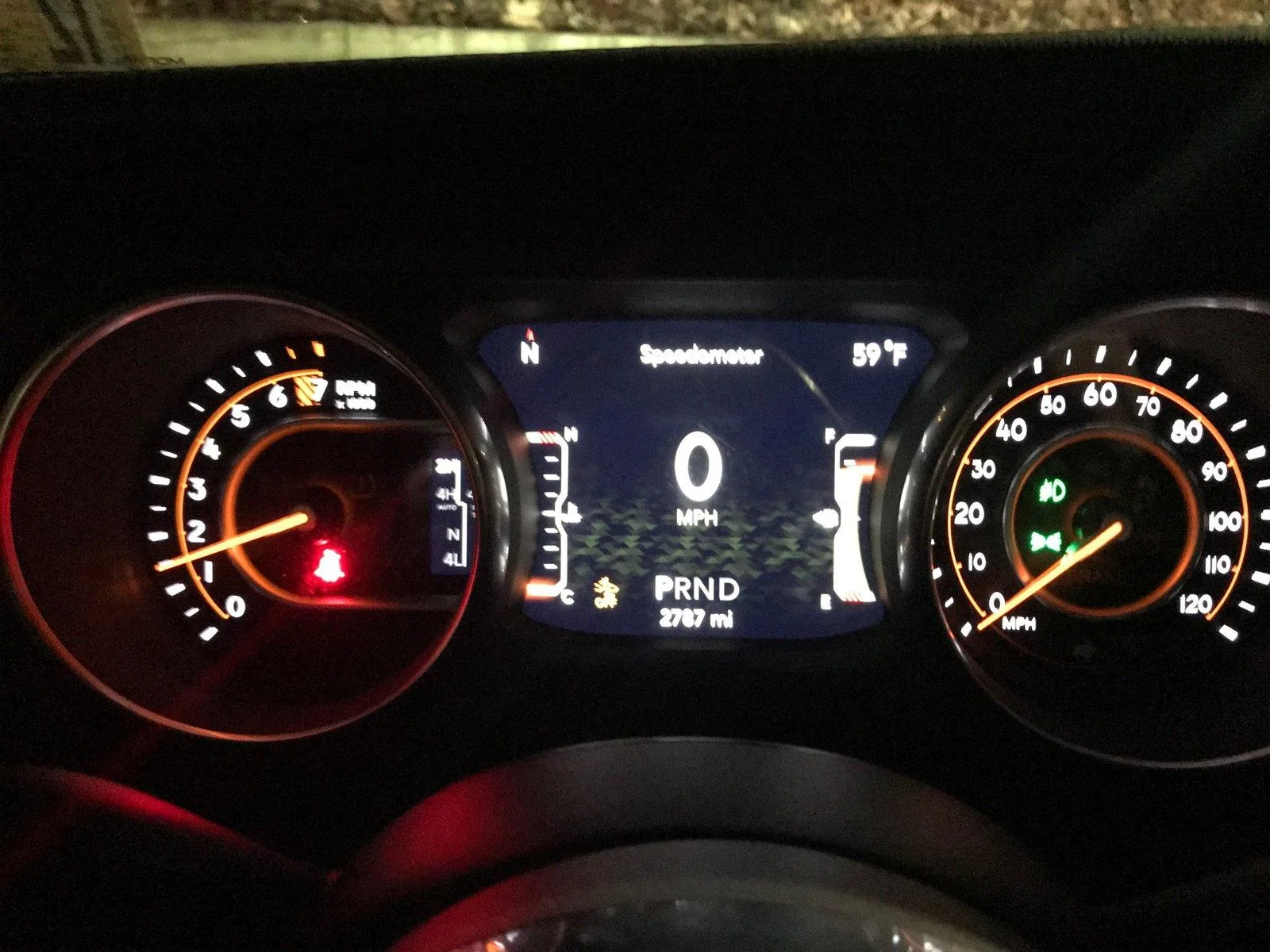

Took it into the dealership. They are going to replace the entire cluster or whatever. The only issue they had was identifying what part to actually order. I continues to crash and the gauges fail to work when it's first stated. It eventually does all return to normal functions.

I'm surprised my '19 cluster looks different than yours. I don't have the analog temp or fuel gauges like that one, mine are digital, and part of the info screen..
This is a Sport S. What model do you have?

Sahara. I would have thought the electronics were the same for these major subassemblies..

Is the dealer letting you drive your jeep? Mine told me they can't adjust the preprogrammed odometer. So my jeep is grounded until the cluster arrives.
Side note- The dash depends on what option/package you order. The Sahara comes standard with the digital fuel and temp gage.
The sport s can have the digital fuel and temp if you upgrade to the larger radio.
I have dumb knowledge like this from building countless different configurations for the better part of a year
