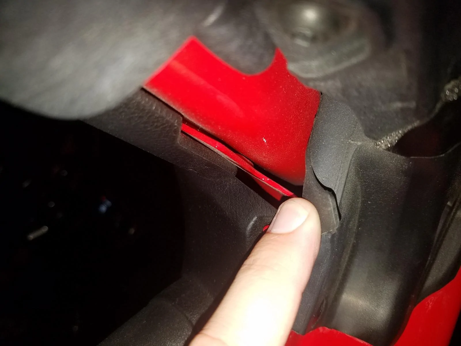

Here is one of the pics he sent me. This is looking back from the driver's door. The piece is plastic.

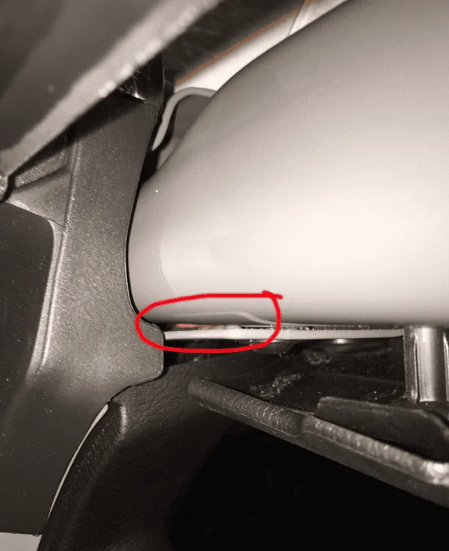

Also - I'm 99% sure the "weld" we are seeing on the passenger's side is actually structural epoxy.
So we’re talking about that arrow looking like thing? I was wondering if that was rubbing where it goes into the metal plate at the bottom but it’s so hard to get in there to see/feel around. And mine is definitely touching the metal on the side, too.
Correct. Mine is touching along the left side. Also, ArchAngel posted that theirs was fixed when the dealer applied lubricant to it. So it might be that. But perhaps the lack of the weld/screw/epoxy in the area where we were initially talking about is what is allowing it to flex to begin with. So it could be a 2 part issue.
I think you are right If you look at my pic i posted above of the side that doesn't have weld, you can see some PINK Putty looking thing in there. Maybe it just didn't receive paint ? who knows.
Yep, that's why I think it's the epoxy. The epoxy turns pink or purple when it cures depending on the brand/type. I think the paint just didn't hit it in that area.

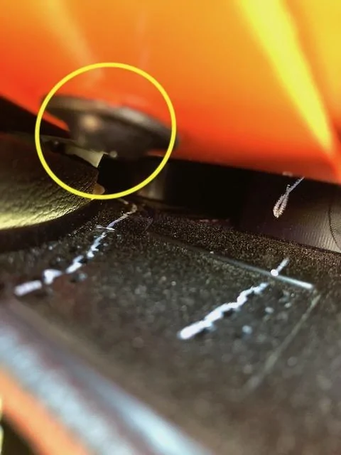

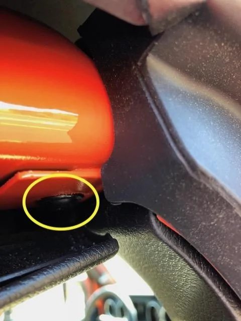

Additionally, in this pic from another member, you can see that the epoxy didn't actually bond with the upper panel on the passenger's side. I wonder if maybe that's why they started using screws too?
Jeep Wrangler JL Creaking sound from driver side pillar C2Q4rKu

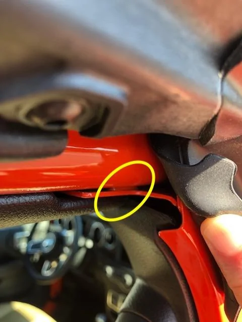

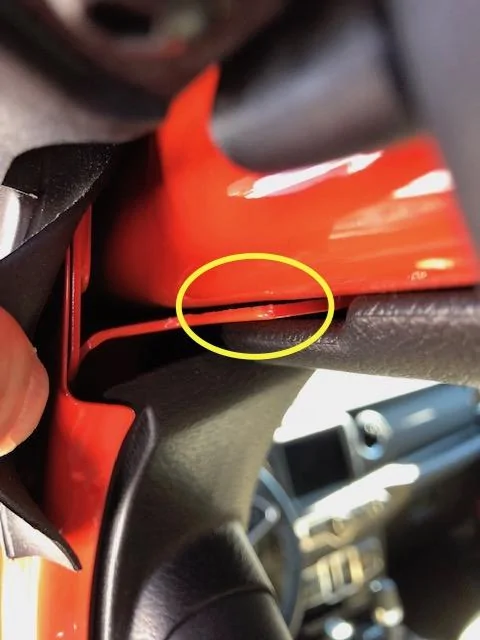

I pulled down on the end of the sound bar trim, and there is a screw there. There is a screw on both the passenger and driver side. I've posted pictures of the screws, what I think is a weld or filler or whatever on the passenger side, and the "missing" weld/filler/whatever on the drivers side. I'll keep watching the thread for a solution to the creaking. For what it's worth I have a hardtop with premium soft top package.
Jeep Wrangler JL Creaking sound from driver side pillar IMG_0358
Jeep Wrangler JL Creaking sound from driver side pillar IMG_0359
Jeep Wrangler JL Creaking sound from driver side pillar IMG_0360
Jeep Wrangler JL Creaking sound from driver side pillar IMG_0361

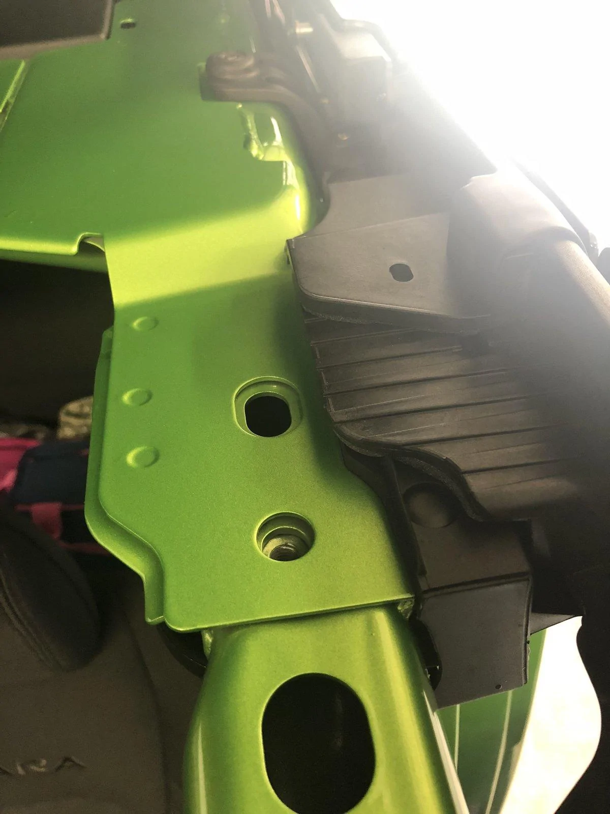

I lubed up the drain tube last night and there was zero change in the creaking and cracking. Since I have the soft top on right now, I am able to grab the two metal plates on the very top of the pillar (where the screws for the hard top go) and when the metal was warm from sitting outside all day, I was able to duplicate the creaking by pulling down really hard on those plates. It’s near the front of the 2 plates.

I'll try doing the same this evening and see if I can duplicate/pinpoint. All we need to do is find the point where they are rubbing and either use some epoxy, rubber, or lubricant. Personally, I'd rather fix the root of the issue by applying epoxy and preventing whatever flexing is happening vs. addressing the symptoms, if that makes sense.

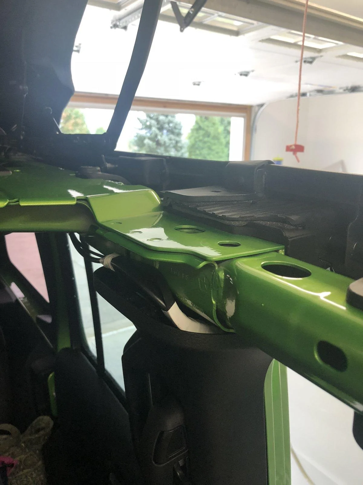

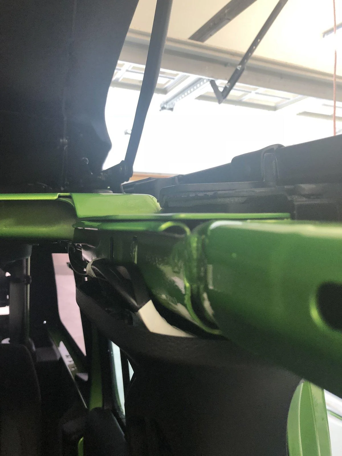

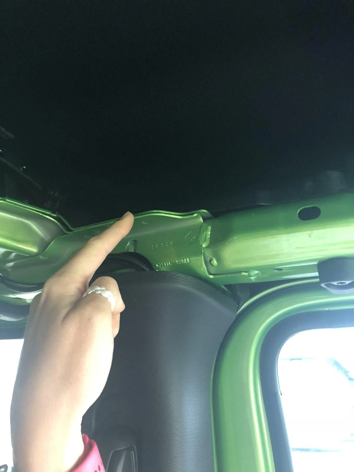

Jeep Wrangler JL Creaking sound from driver side pillar 9FCCB4F5-5D61-4D6C-912C-6FFB8B39A21D
Jeep Wrangler JL Creaking sound from driver side pillar B0E3EBF6-303F-4880-88D6-B52C35182D6B
Jeep Wrangler JL Creaking sound from driver side pillar C48ACC77-BEB6-4E80-A805-22AA3A8AB5AF
Jeep Wrangler JL Creaking sound from driver side pillar 7FBEA60D-973D-4E9E-B9DA-DD125810C9FC
I am now 95% convinced that I know where the sound is coming from. The pics above are of a place where there are 2 metal pieces, one sitting on top of the other and then they are both wrapped around the roll bar. Lots of spaces for metal to flex against another piece of metal. Where the screw for the hard top goes in, it appears that there are 3 layers of metal there. This is the area that I can pull down on very hard and duplicate the sound of the metal is warm from sitting in the sun. I put my ear as close as I could get to this area (I drive a standard transmission so this wasn’t easy to do while still having to shift gears and such) and I’m 95% sure this area is the culprit. If you look at it from the top, you can even push the one piece of metal down and make it hit the plate below it. Now I don’t know how to proceed.
