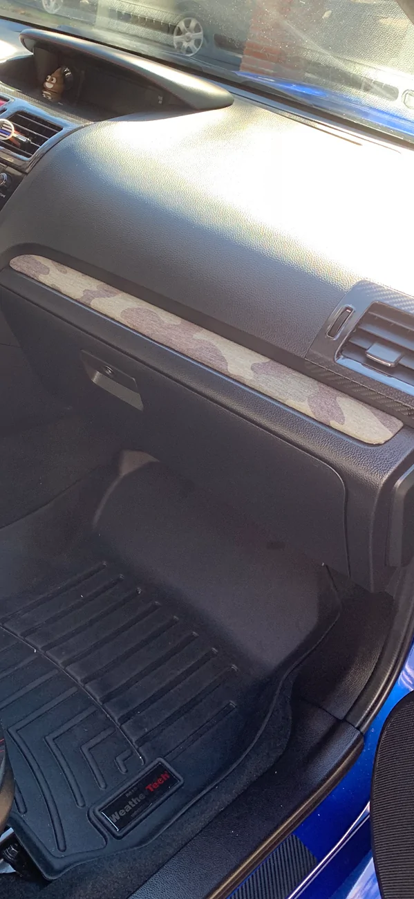

Go to a hobby store and buy whatever material you like….
for my 18 STi I used a light designer camo style cloth
get 3m spray glue
remove panels…scuff everything up, spray glue and apply then trim the material.
replace it on dash.
I’ve done entire headliners and door panels in Alcantara like this
get 3m spray glue
replace it on dash.
I’ve done this as well. Back in my street-truck days, I burned through bolts of gray tweed on my trucks as well as friends trucks 🤣 One of the interiors I did was even featured in a magazine if I remember right.
On my old stepside Sonoma I went a different route and sanded all the texture off the plastic pieces, primed and then painted them all to match the truck. I did the same thing on my ‘bagged ‘95 Chevy. From experience, wrapping trim in fabric is much less labor intensive than sanding, priming and painting 🤣
