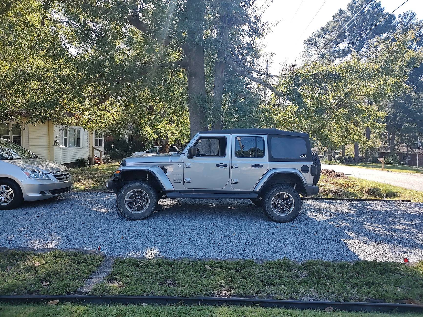

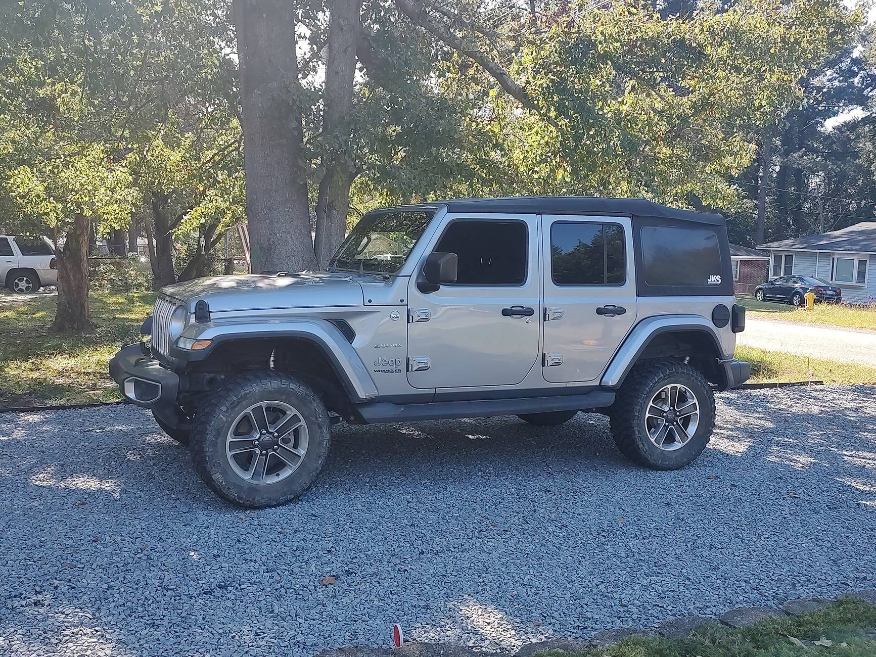

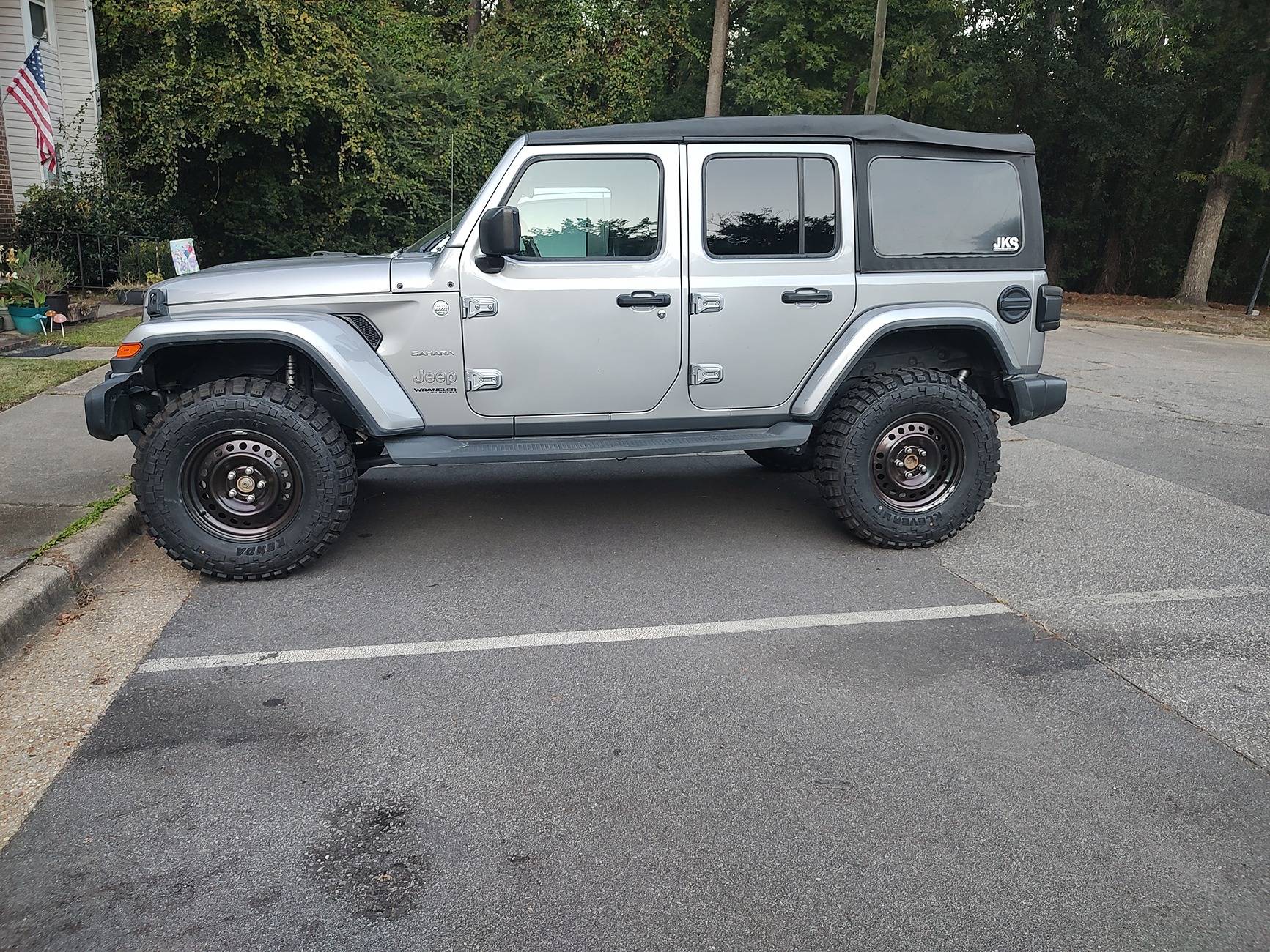

Behold! The roller skate!! :LOL: We did the lift back in May (2024), just finished painting the steelies a couple weeks ago but haven't had time to mount/balance all that. What you don't see is a mismatched tire on the passenger side, which is an a/t tire rather than a m/t like the rest. Why? Because it was the spare. Why did I need the spare? Ran over something on the highway, no idea what, put a bullet-sized hole in my tire. Where I live maybe it is a bullet hole. Who knows. I also have a tire with 2 plugs in it. But while I was trying to save up to regear and do tires (35s) at the same time, that's not gonna work. I need to put my new tires on now. So I took these photos real quick, as I'll be getting new wheels/tires put on in a couple days....
Jeep Wrangler JL ..CHUGGY.. a JL Sahara tale IMG_20241013_145901035
See what I mean? It looks like a roller skate...... lol

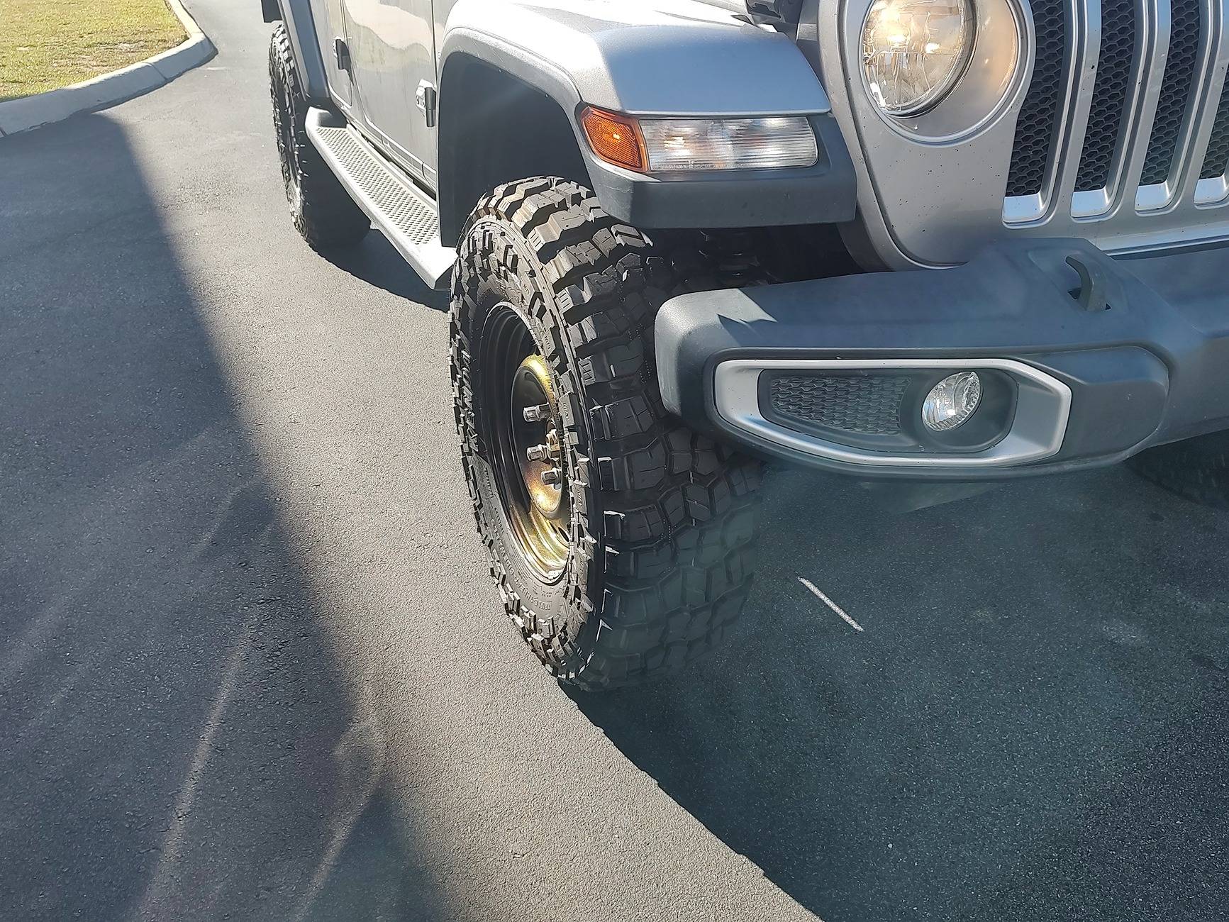

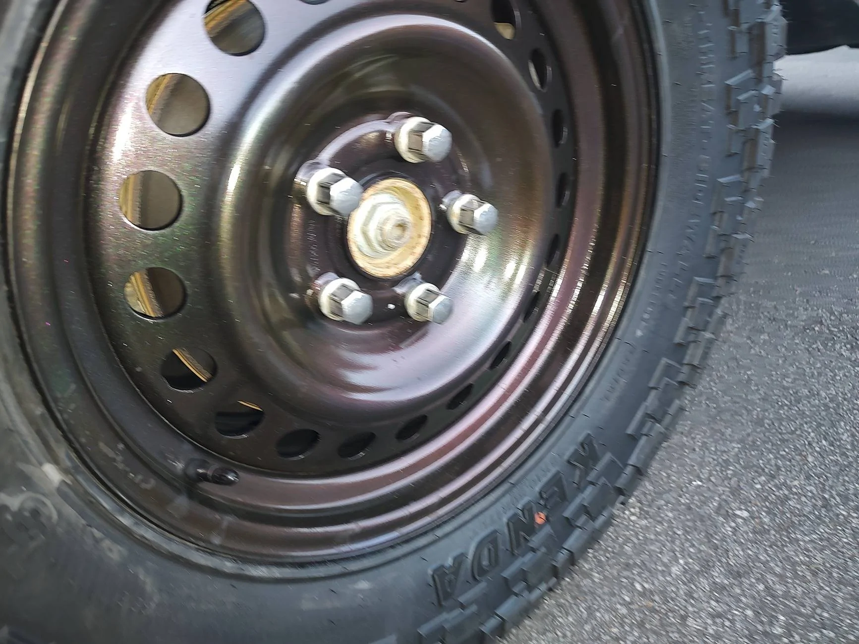

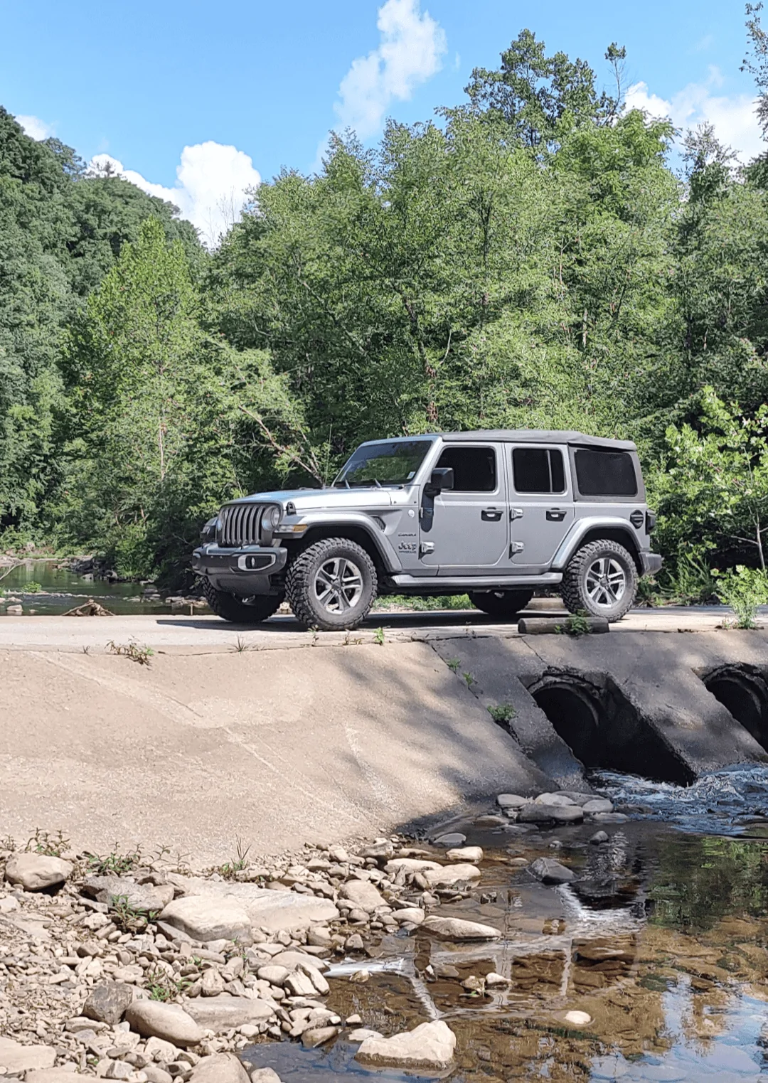

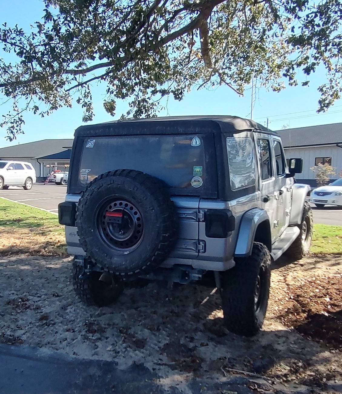

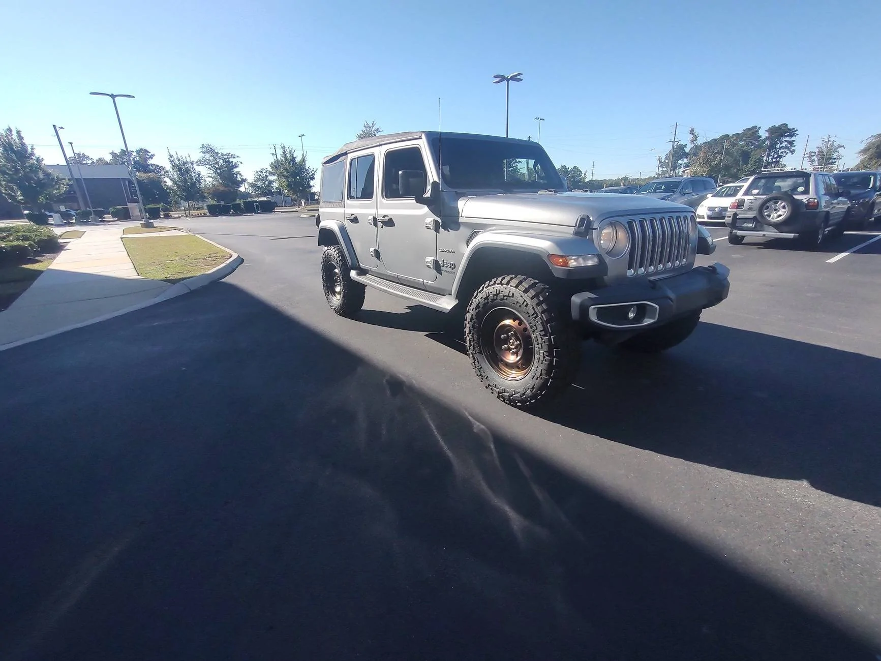

Gladi spares (17s) painted in a custom color combo by me... Not a professional job but good enough! Rocks are gonna tear it up at some point anyway. No regerts. Hard to capture the colors, varies depending on lighting. Was a proud member of the rear bumper delete group for awhile 😁 Tires are Kenda Klever 35*10.5. Quiet and cushy so far.
What I can now laugh at is how nothing ever goes smoothly for me... Dude who mounted/balanced my brand new wheels/tires put hammer on weights on my custom paint job. Working at a high end euro shop who should know better. Manager saw it and gasped and immediately comped the mount/balance so it worked out. Stay tuned for more fuckery every time I need something done 😆
Anyway, wish these photos would go in an order that makes sense but, oh well
