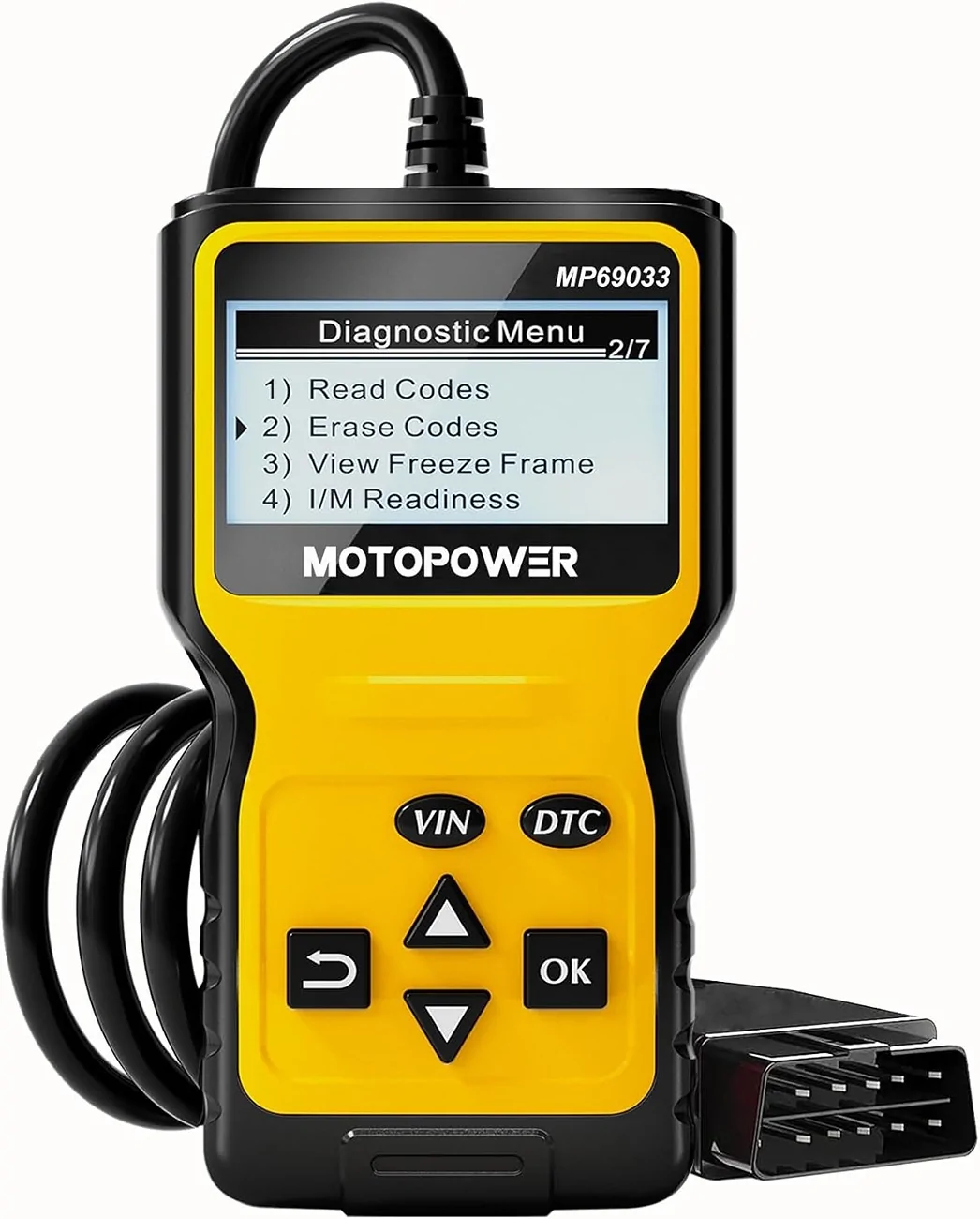

First thing...get your own OBD2 scanner. Even a cheap one will read and reset codes. Sometimes resetting a code gets rid of it and doesn't come back. This one is $15 on Amazon...
