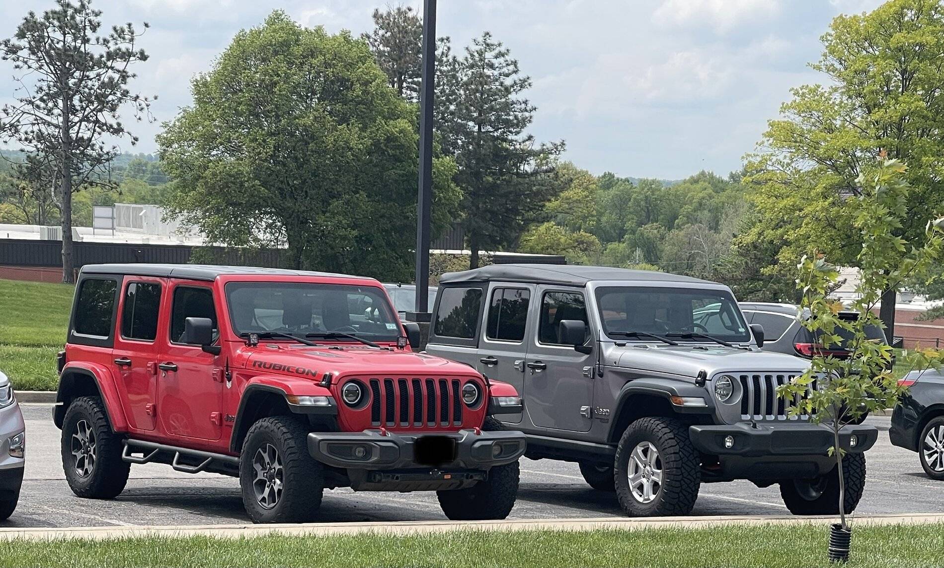

Thank you for showing this next to a stock Rubicon! I wish we could see every mod directly next to a stock Rubi. I know not everyone gets the opportunity to show that, so I appreciate the pic.Fenders will still be a problem unless you do proper bump stops. I have 2” Dynatrac springs with 295/75r17s that measure 33.25” mounted. The fender gap is pretty much the same as a rubicon with stock 285/75r17s.
I'd imagine a touch of that comes from the tire selection as well. But even with Rubi tires I'd think you're probably still sitting about an inch higher.It sits about 1.5” taller. I am about 3” over stock height from the lift coils alone.
the rubi’s higher flares give that impression in the photo I think. Look at the bumpers mine is still a little higher and I am downhill
There is only a 1/2 “ difference between a 285/70r17 and a 295/70r17. So not much difference but a little.I'd imagine a touch of that comes from the tire selection as well. But even with Rubi tires I'd think you're probably still sitting about an inch higher.
Yeah, I've read so many different numbers about the Mopar lift. Maybe someday we'll get a pic of equal model JLs with a Mopar and a Dynatrac side by side, with the same tires. I'm not holding my breath, that's a lot to ask. But I do hope someday someone could get those side by side to put the questions to rest. All reports on both end point to either being a really great option though.The mopar lift has been reported to give 2.5-3” on a Rubicon. I bet it would sit almost another 1 inch at least over the dynatrac springs.
I agree. I went with the dynatrac springs because I got them for 250ish shipped from a member on here. They ride great paired up to some rubi take off shocks with shock extensions. I was able to put the money saved into a Core4x4 track bar.Yeah, I've read so many different numbers about the Mopar lift. Maybe someday we'll get a pic of equal model JLs with a Mopar and a Dynatrac side by side, with the same tires. I'm not holding my breath, that's a lot to ask. But I do hope someday someone could get those side by side to put the questions to rest. All reports on both end point to either being a really great option though.
