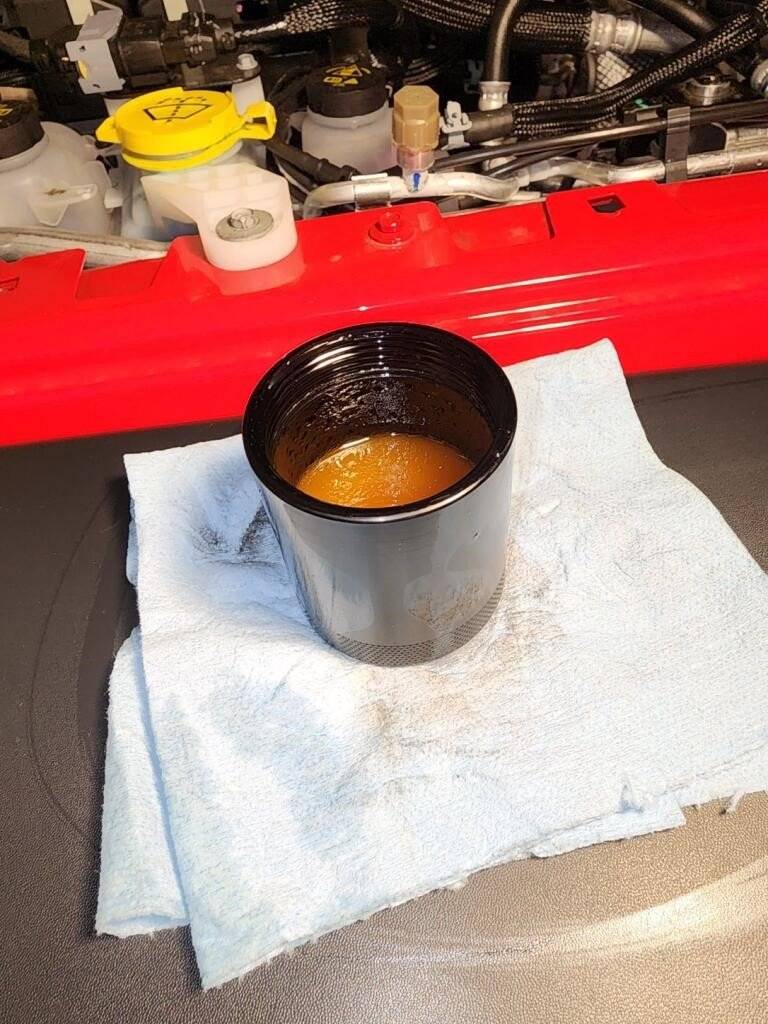

Less than 1K miles.

That looks like condensation. Cold weather?

I have seen condensation in my wife's catch can mostly because we do shorter trips with hers
I always warm up my jeeps for at least 10 minutes to get the oil up to temperature to help burn off condensation in the oil. And I live in California. I can see if you live in a high humidity or wet state that this could be a real problem
Just another reason to install a catch can and keep that crap out of the intake air stream
