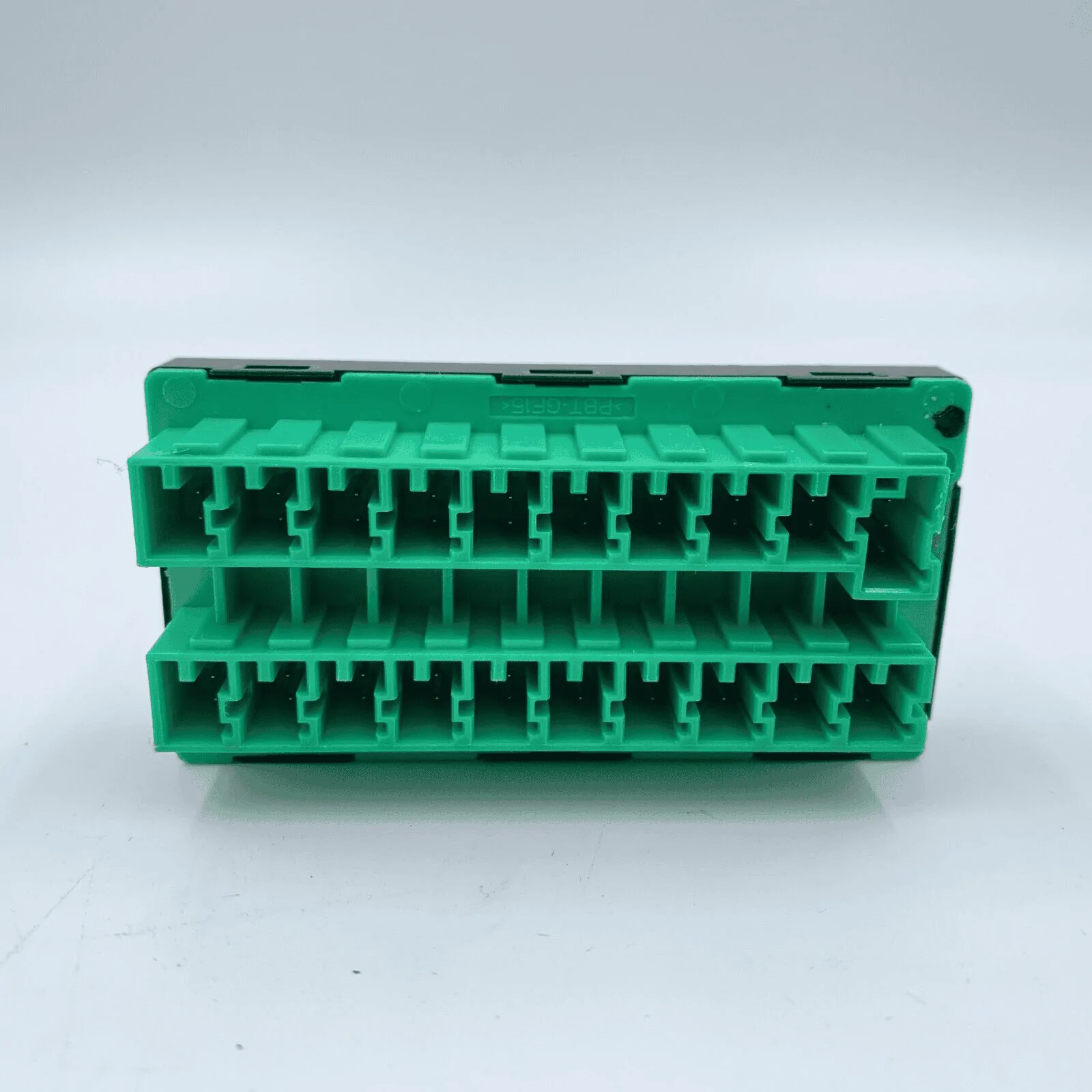

My jeep isn't drivable again. I'm having the christmas tree dash again, with the same problems as before. This time I can't even start it. If anyone is curious what happened last time. https://www.jlwranglerforums.com/fo...ssion-check-engine-light.113516/#post-2361310
From what I've read on a different thread that this might be the issue, So I'm wanting to swap it out hoping it would resolve the issues.
Does anyone have a spare connector like this laying around from a 2 pack they bought off of ebay?

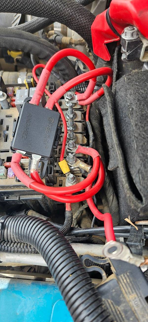

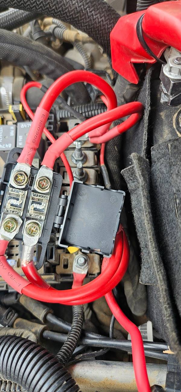

Great info, after finding this thread found I had blown the N3 fuse, couldn't find a fuse array locally so fixed it by putting a new fuse in parallel with the array.
Because of the tight space I used 2x 80A fuses, this allowed me to use smaller guage wire.
Btw, this is only a temp fixmusing parts I could find in local town, got the fuse array on order
