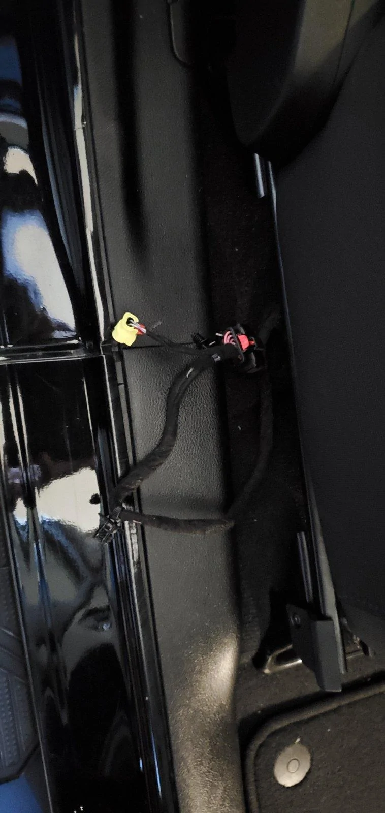

I took my jeep (19 jl rubicon) in today for the seat pull recall.... when they were done they forgot to plug in the wiring harness under the seat. Now I cant figure out where it goes. Any ideas?

And its not giving you any faults? Yellow is airbag connector, it connects to the bottom of the seat.

I would bring it back to them and have them do it, even if you get everything plugged in, they’ll still need to clear the codes otherwise you’ll have a million stored in there.

Oh it is giving lots of warnings... probably filling up my 64k memory with codes galore. Im taking it back to the dealer tomorrow. I dont want to f with air bags.

JFC how does this even happen?
When the dealer was doing the RRT on the seat, they must have unplugged the harness and forgot to reassemble correctly. Sloppy techs.

Don’t just plug it in. If the airbag goes off while you’re down there it’ll either ruin your day, mess your face up or kill you. Have them do it.
