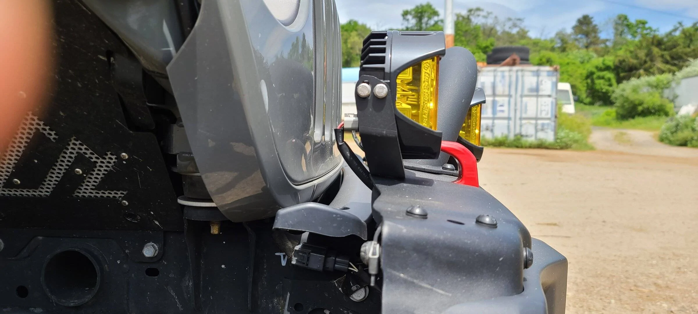

for the outer two lights on your bumper, what mount did you use?
All 4 lights on the bumper used the mounting brackets that came with them. I simply used a factory steel bumper bolt location.
Jeep Wrangler JL Bumper Mounted Lighting Options 20210525_115958
Jeep Wrangler JL Bumper Mounted Lighting Options 20210525_120025
It was a last minute placement decision. My original plan was to mount those 2 on top of the bull bar, so all four LP4's would be in a square formation, but there wasn't enough room for bar clamps because of how close the lamps are to the underside of the bar. In the future, I'll modify the mounting brackets so the lights sit a little lower. All I need is another 1/4" of space for the bar clamps. Until then, I didn't want to drill extra holes in the bumper.
