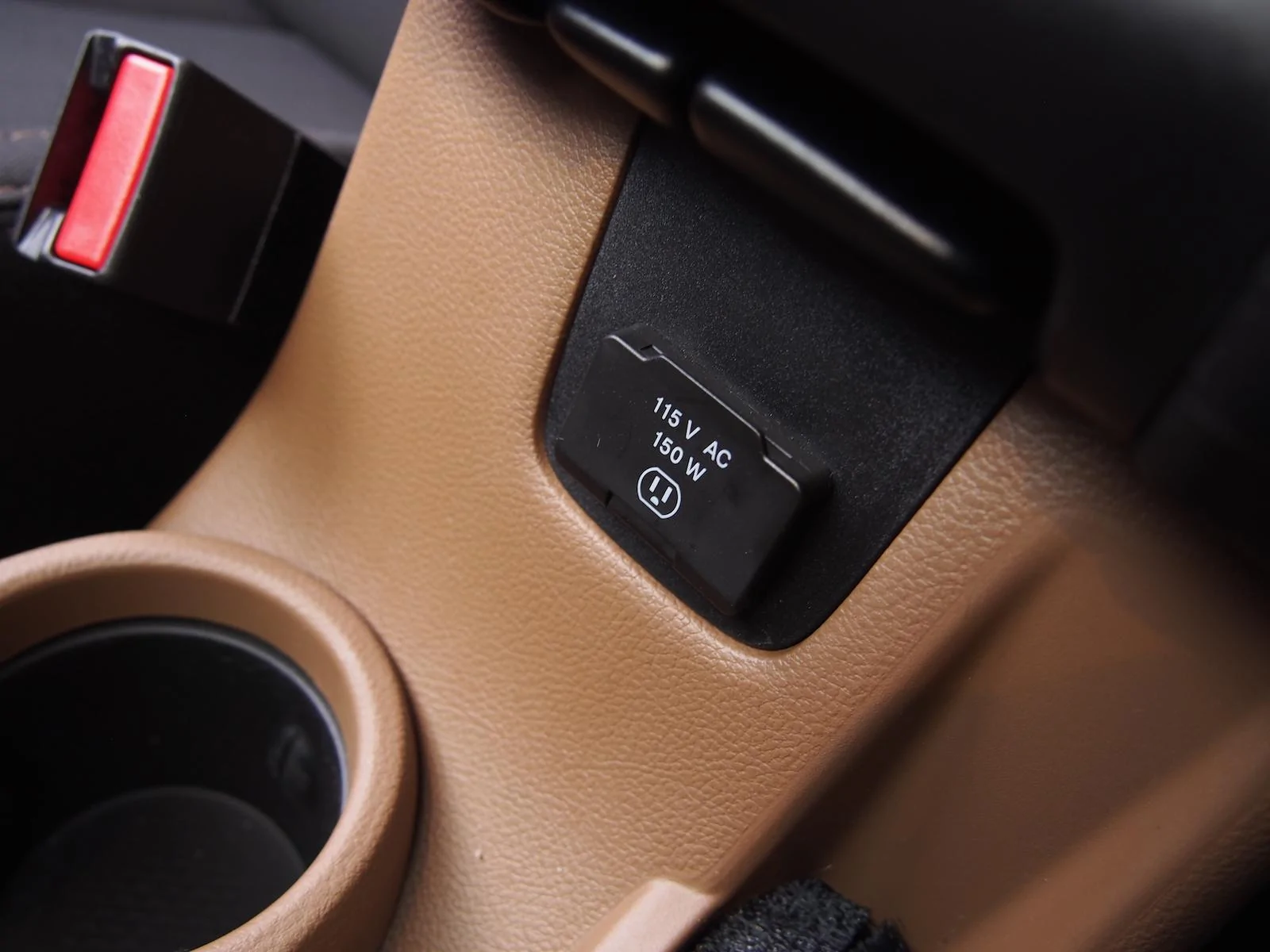

Figure I can run a power washer from this? I'll let the jeep run.
No, the plug is only rated at 1.25amps @120volts AC.... watts divided by voltage=amps sorry mate!
150/120=1.25

Is there constant power to the plug? My JK had an on and off button.
There is not. The only factory equipped interior source of all the time power I know of is, if equipped, the cigarette lighter plug in the cargo area. A fuse in the Power Distribution center under the hood, as per the manual, can be switched to make this outlet an accessory only outlet: on only when the JL is on, like the dash cigarette lighter. But from the factory it's by default energized.

I just checked and the Sport doesn't sport one
