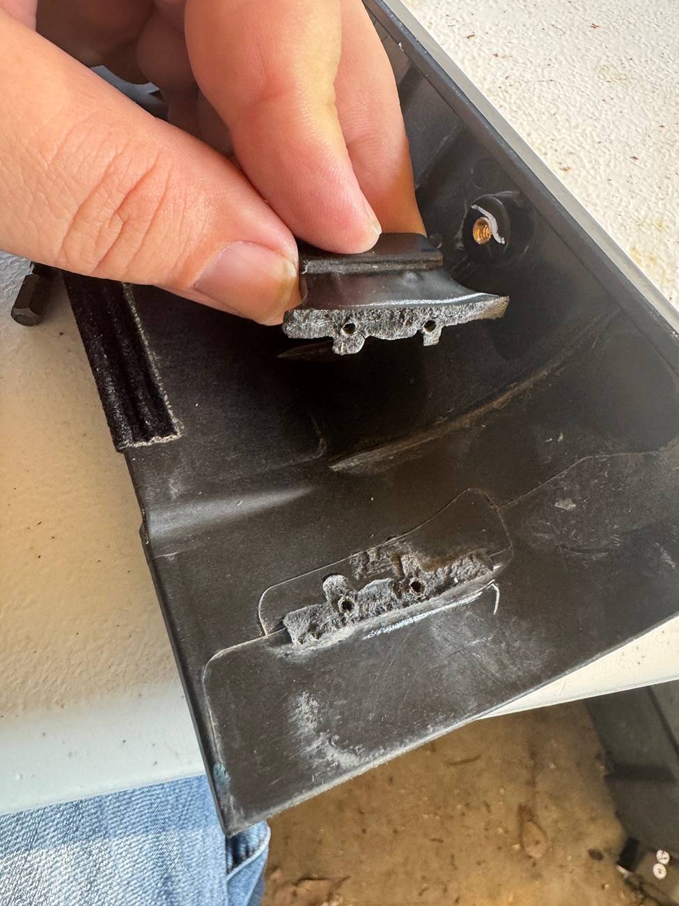

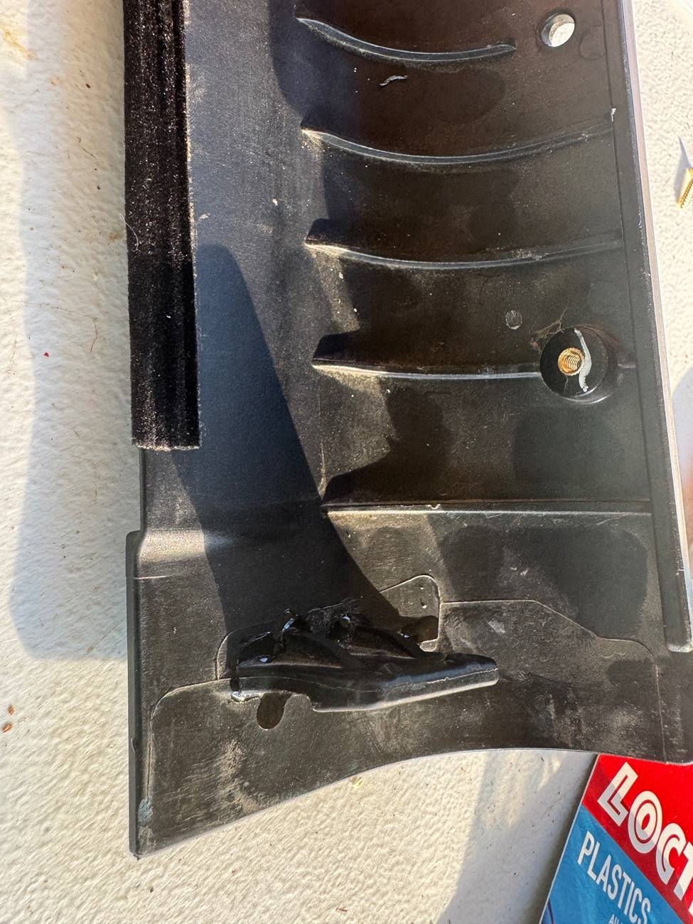

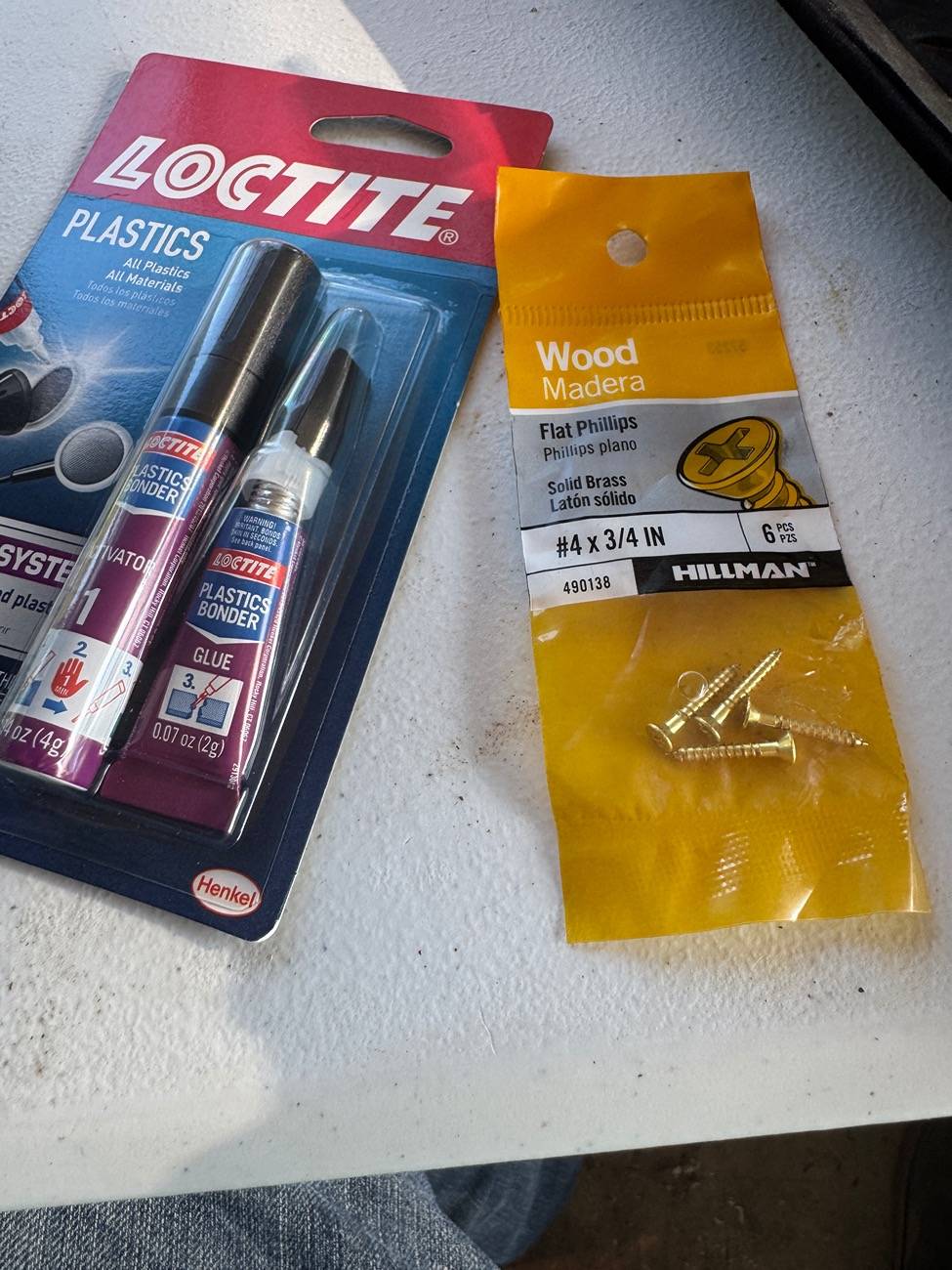

Old thread but the issue was new to me today. I used loctite’s plastic bonding system and 2 #4 screws. With just the screws it already feels like it is stronger than before. There is no play up down or side to side. The screws I used didn’t recess into the plastic much. After the glue sets I’m going to put something soft between the screws and the material for the window to protect the soft top.
used a 1/16” drill bit for the pilot holes for the #4 screws.
