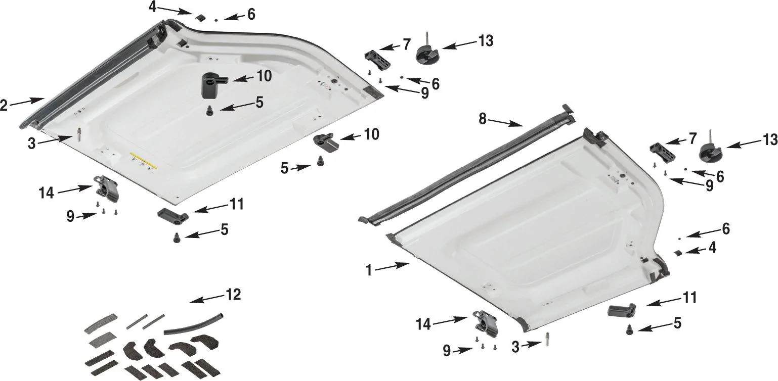

Hello everyone,
I was just reinstalling my freedom top and the limit stop on one of them snapped off (#11). I can’t find a schematic of the new top, but here is one from a Jk. Has anyone seen one from a JL so I can find a part number? Or a place to find breakdowns of other assemblies?
Would this be something that the warranty might cover?

Just had my driver side panel replaced under warranty for the same thing

ok, I just pulled mine to get the part numbers (they're on the side facing the freedom panel:
68368567AD -driver's front center, passenger rear side, passenger rear center
68368568AD - passenger's front center, driver's rear side, driver's rear center
One of mine broke and the dealer ordered the wrong one because the schematic on their parts ordering system was incorrect - so they had to order a new one.
Your kinder than me ,
I had them replace the entire freedom panel , as well as the drivers tail light as it had bubbles in the plastic from the molding prosess

@jamielong - they already had my jeep for like 53 days out of 90. I wasn’t going to dick around with them having it longer where something else could go wrong in their watch. Not a place I’ll return to
