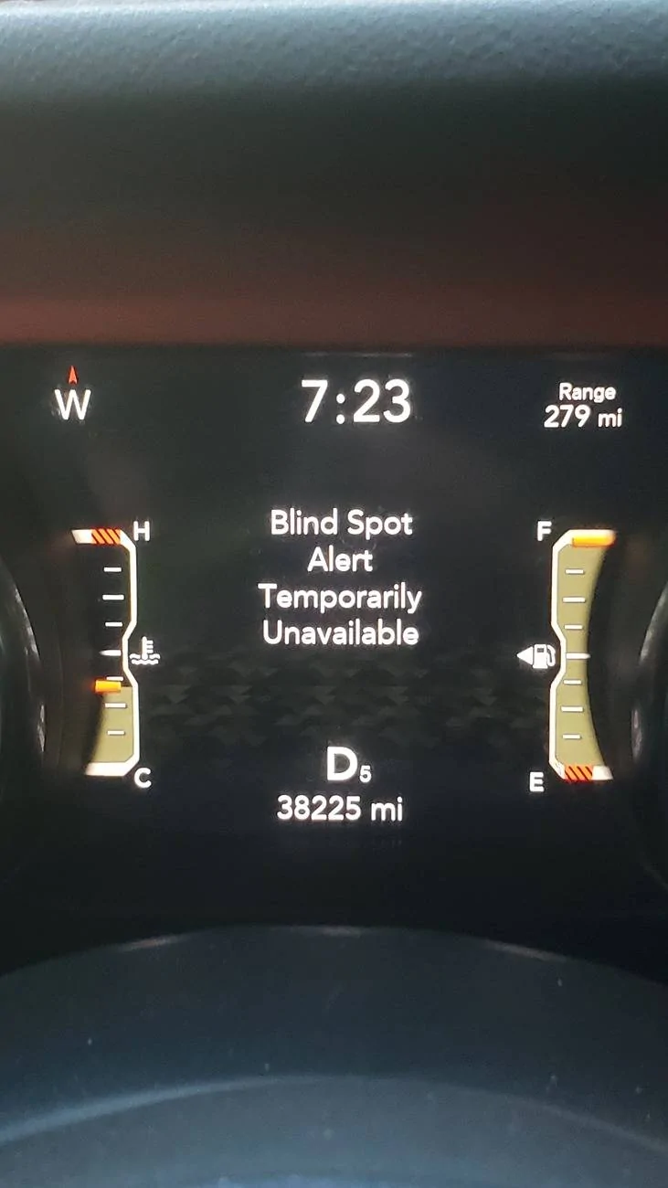

Well ... ... ... my yellow triangle is now on constantly. :( Okay, technically it comes on when I first start the vehicle & put it into reverse, then it stays on.
I have ran a lot of water on the top side of the tail light, hoping to clean / clear off any dust that might have settled in there. It seems unlikely to me that this is the problem because I had a Gladiator before my JLU & drove a lot more dust road/trail conditions than my JLU has... well, technically I don't really know bc I bought the JLU used. :)
Good news is I am familiar with the location & box thingy of the blind spot monitor because once upon a time I swapped out my stock JT tail lights for the Oracle tail lights. Part of that process is transferring the blind spot monitor module from one tail light to the other.

Well, lastnight I removed the taillight, then removed the blindspot monitoring pack from the taillight. The pack is about the size of a deck of cards. Sorry, no pictures. I figure you can find them online, especially if you watch an Oracle install.
Next, with a damp paper towel, I washed off (1) the sensor (2) the plugs (3) the part of the taillight that the sensor "looks thru" to do its job.
Then I reassembled the taillight & all its gizmos, then reinstalled it into the rear quarter panel.
(Drum Roll, Please)
Nothing changed. Triangle on mirror still lights up & stays that way. Dash still says system is temporarily unavailable. (Sigh)

Any DTCs? Might help to pinpoint what the system thinks is wrong.
