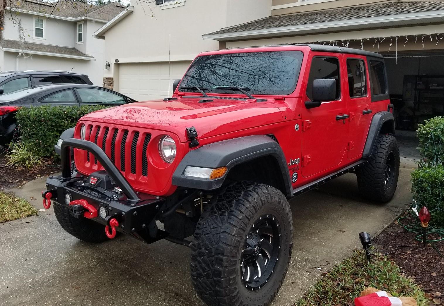

Well I hope that on the way doesn't mean 3.5 months like mine did haha but I love my Hauk bumpers and sliders so worth it:)
Hauk has been threatening to put out a side step that I want but lord knows when it will be ready.
