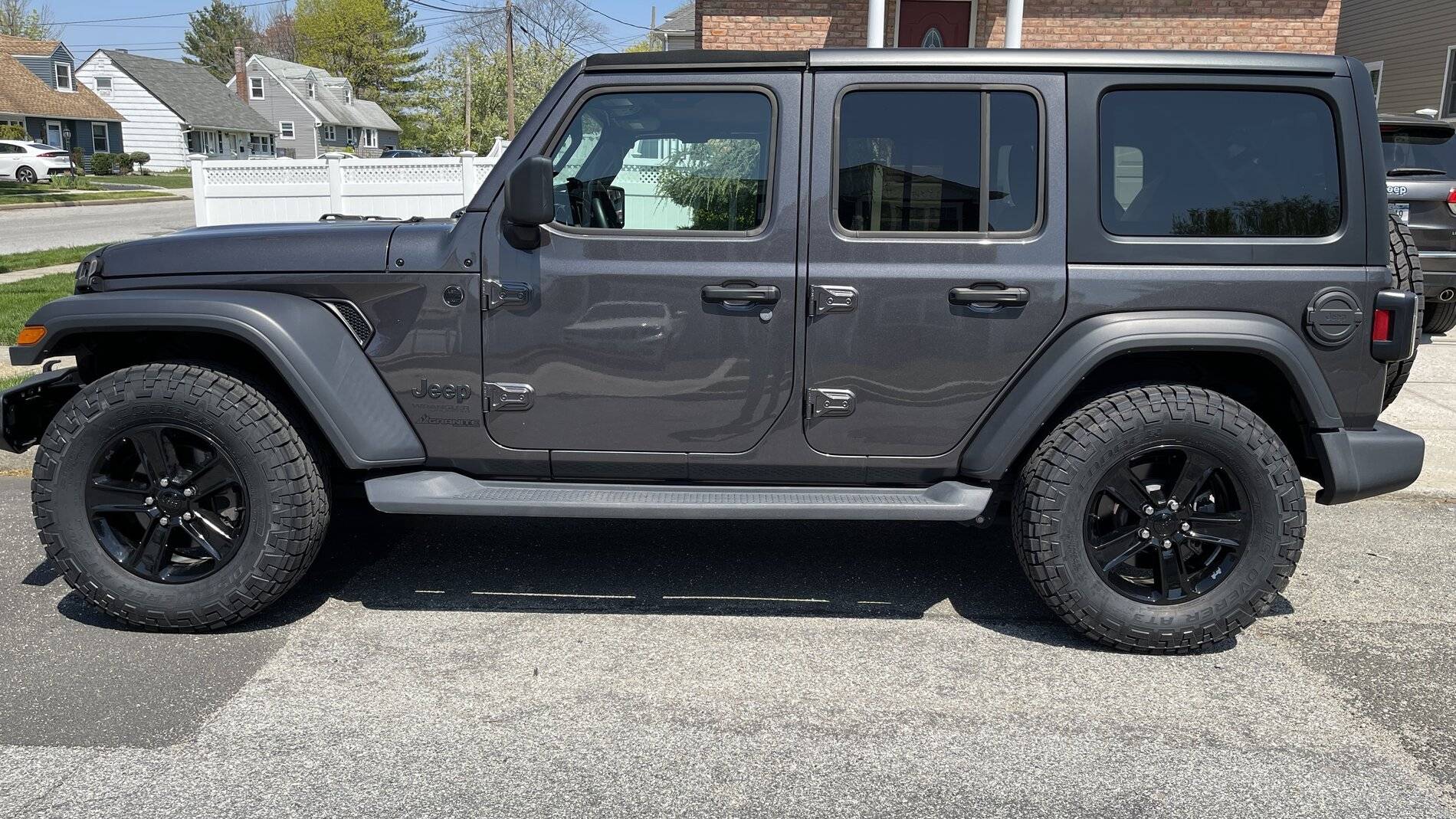

Ordered a new Wrangler Saraha today, comes with 18" wheels. Not doing a lift, but interested in getting a larger and better tire than the stock all-season. I live in Colorado and the jeep will be used as a daily driver with occasional off-road, and limited highway use. Would appreciate any suggestions on an appropriate tire, thanks.

I just had Cooper Discoverer AT3 XLTs in the LT275/70-R18 size installed just over a week ago. I have a Sport Altitude with the same size 18" wheels that are on the Sahara. They are a fantastic tire - light and quiet. My local tire shop is selling more of these than the beloved BFG KO2s.
